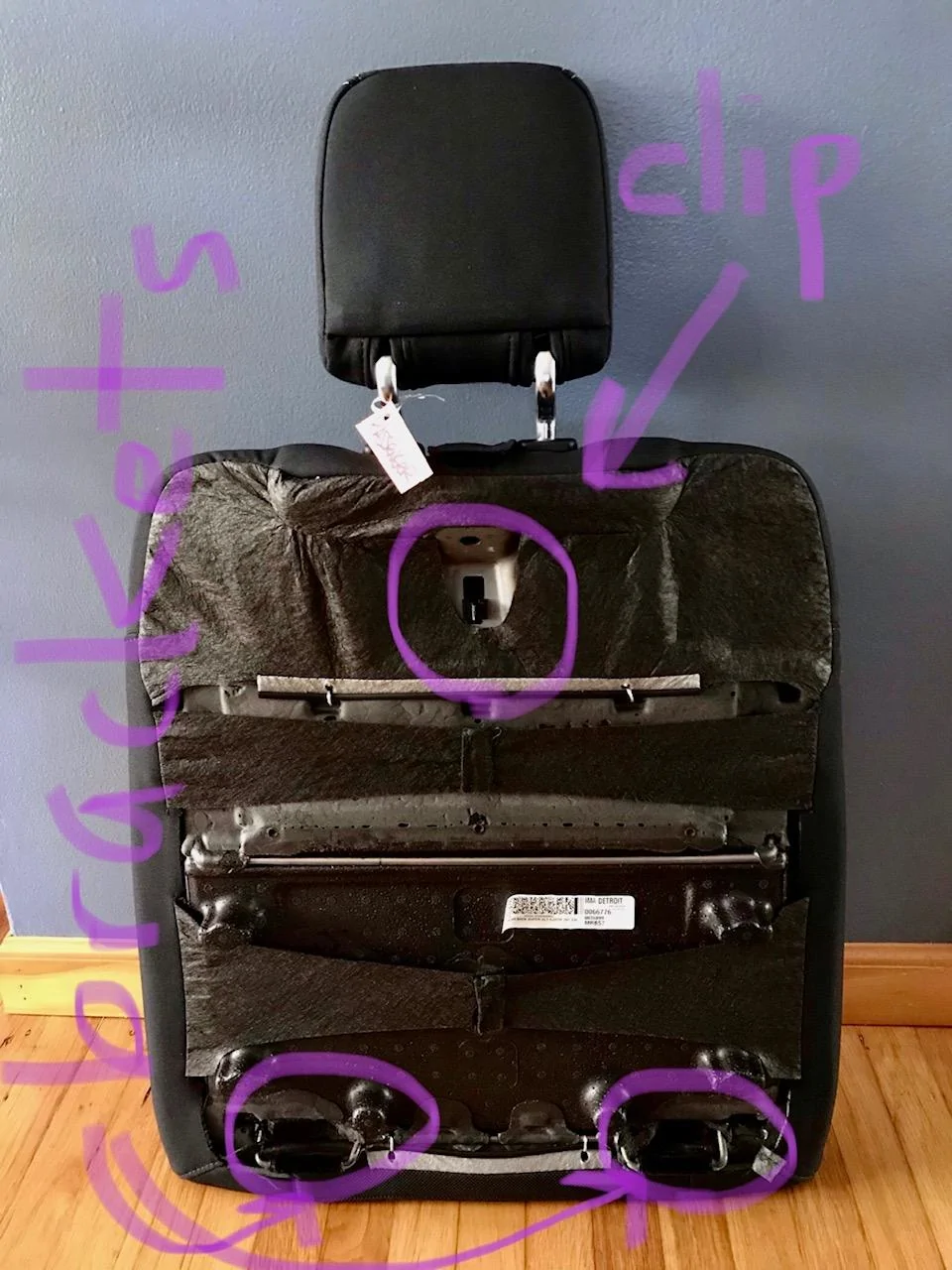

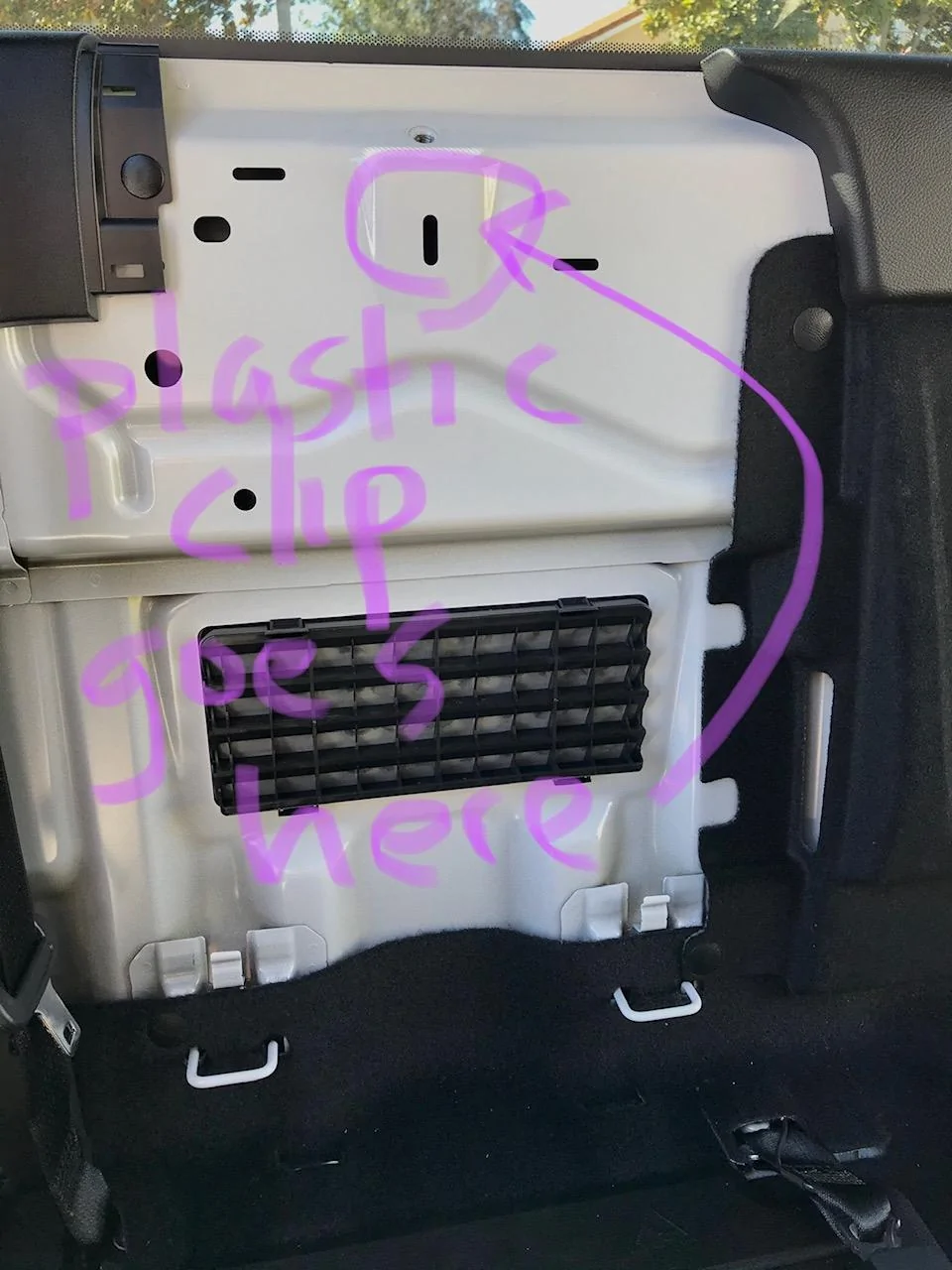

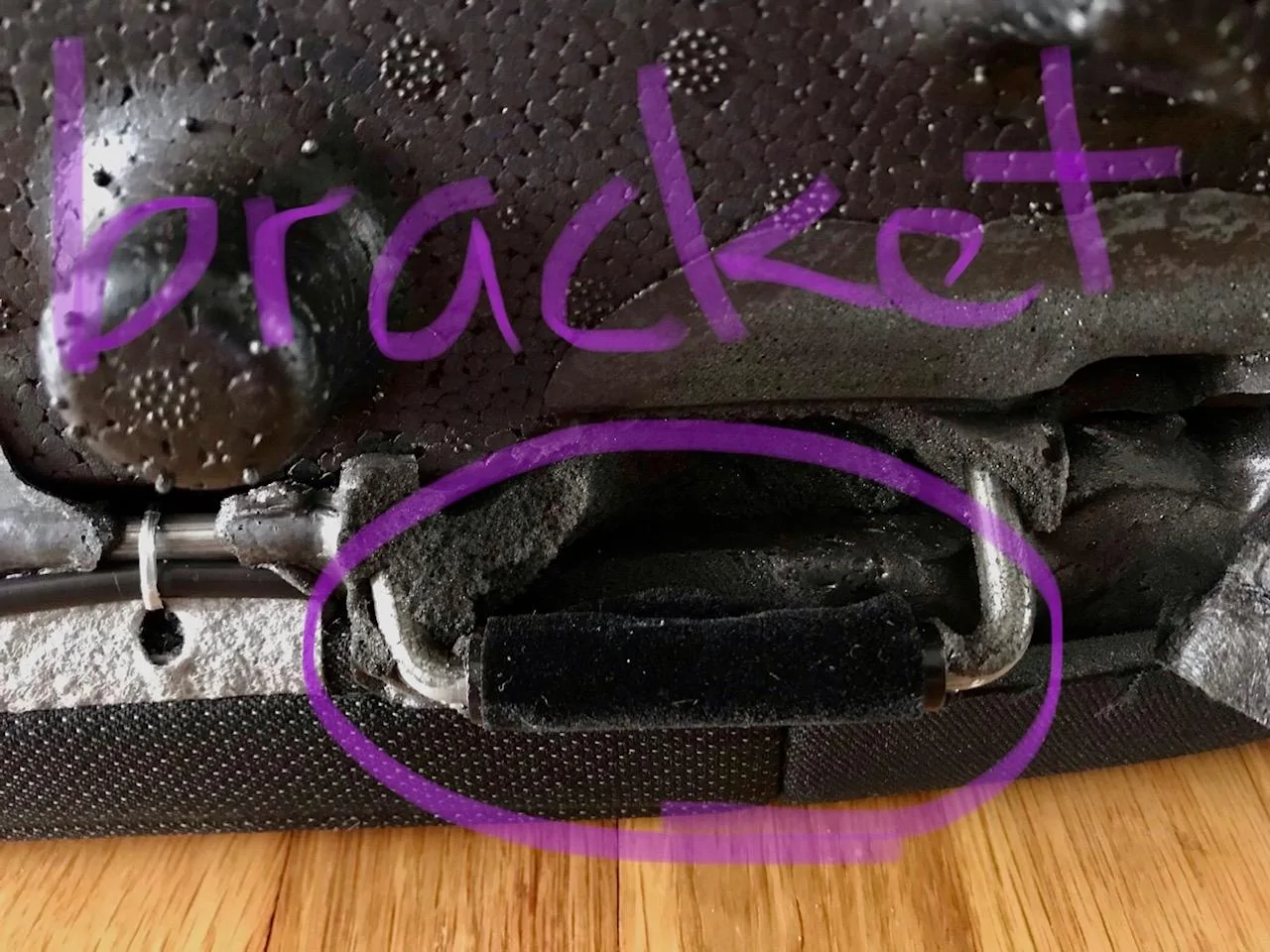

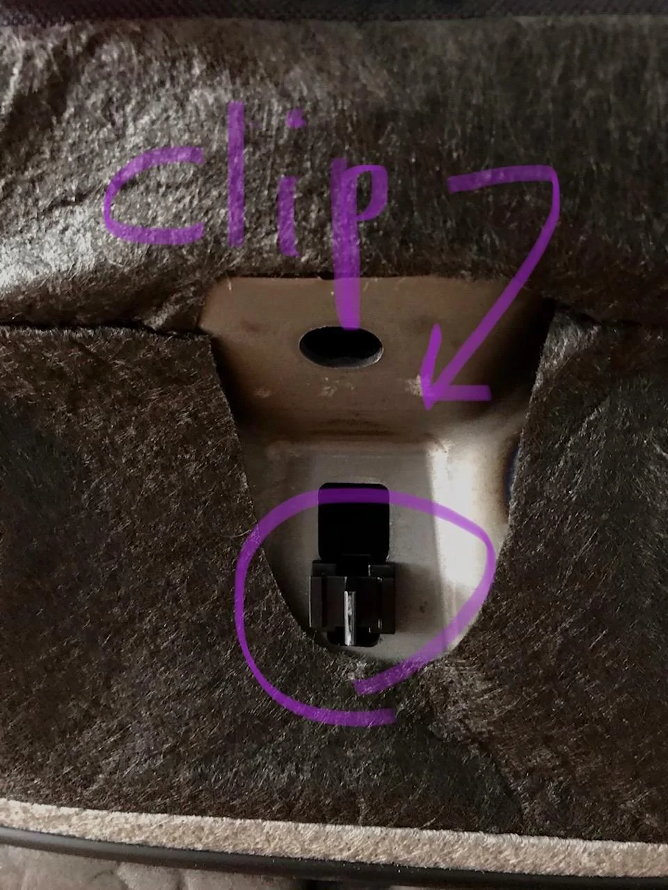

Wanted to give a personal experience viewpoint with removal of the rear seats on my 2020 SuperCab as I just deleted them on my truck today.
I found the prior thread removal descriptions helpful but I also disagree with one of those suggested steps and hope to save the next person some frustration or maybe just provide some clarity to how they are attached. I started as others removing the seat bases via the lower strap release and then extracting the 1/2" bolt beneath the child seat anchor velcro cover in-between the headrests. After the bolt is removed one user suggested rocking the seatback to the left and right until one side unclips from the two lower metal brackets. I was unsuccessful with this technique as I couldn't get any lateral movement whatsoever. I instead, gripped the seat back at the top corners and with a quick firm pull broke the plastic clip that holds the seatback to the rear wall. (this method was also suggested by another member and also worked for me) After close inspection I see no other way to get the seatback un-hooked. On the second seat I reached behind with several automotive trim clip removal tools that I own but could not get it to release. A quick yank on that side also worked. The panel clip is easily replaced and I'm sure is just a few dollars give or take. Anyway, I'll be removing the seat belts tomorrow and begin fabricating a lower platform template with anchor points that will hold totes and bags and trail tools. I'll post shots of that progress as it comes together.
I've attached a few images for an understanding of the components that hold the seat to the rear wall. The plastic clip mounts to the upper center of the seatback and the two metal brackets attach at the bottom. Good luck.

Thanks for the information. Don't see anyway to remove the seat back without breaking the clip.
That clip on the seat back was not on my 2019 XL. Must be new for the 2020 models.
Being that the seats are not designed for removal, the clips are probably not designed to release. they are probably designed to simply hold the seat up untill it can be bolted in permenently. i'd buy a few and store them if you intend to re install the seats at some point, though it's not clear they are needed.
