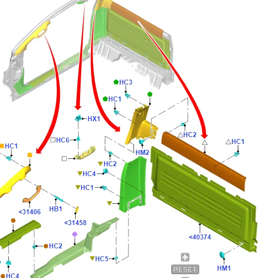

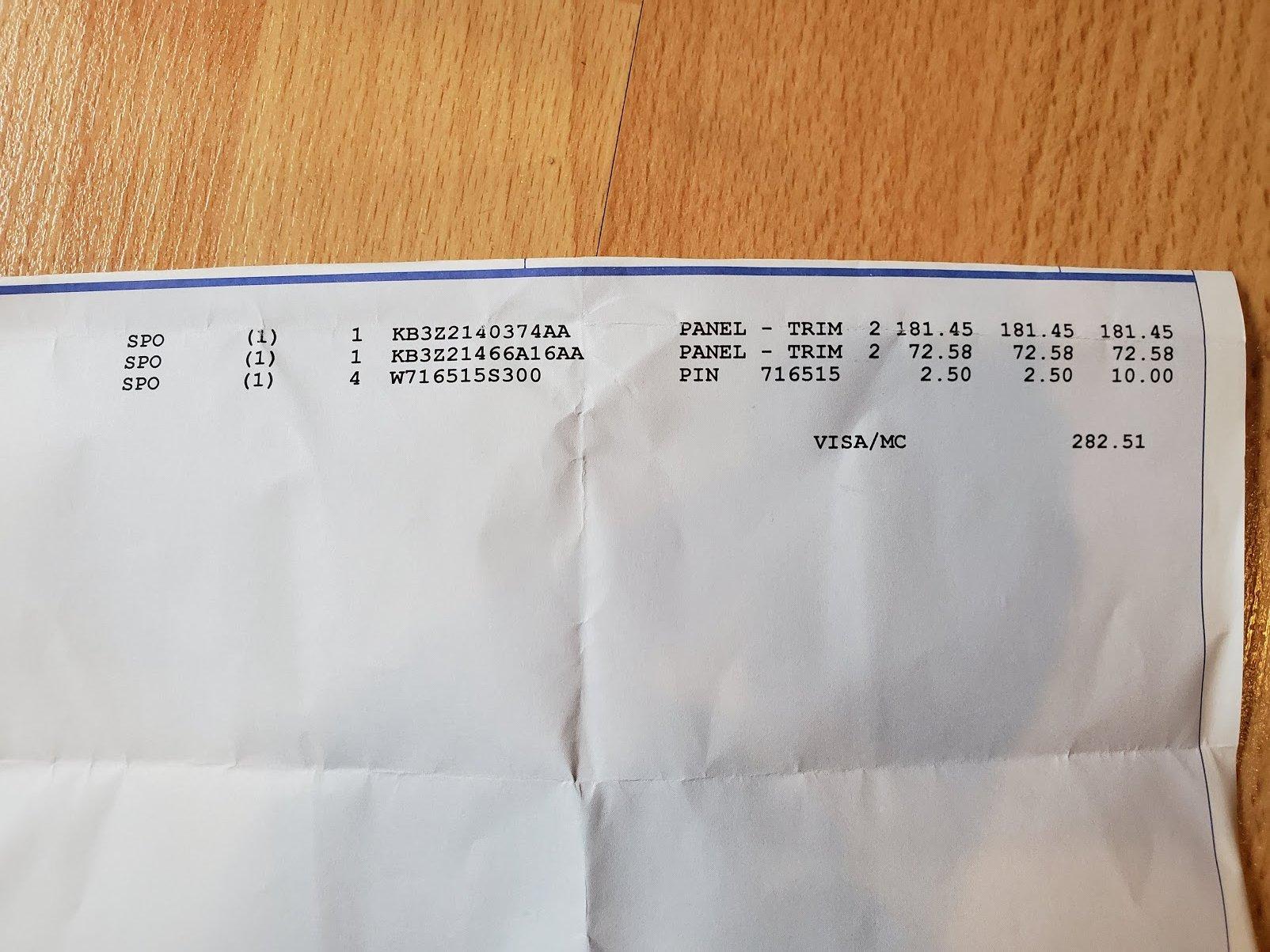

What color are the trim panels. I have the ebony interior and would love to do this to my pickup!

You're in luck, XL trucks only come in Ebony.
I think the back seat delete may only be available as an option on the XL trim level?
Certainly, Ebony will be available, and probably no other color.

Awesome I'll give those part numbers to my guy at the dealership and hopefully they can get it fairly quickly. I personally think it looks and functions way better without the seats. Thanks for the info!!

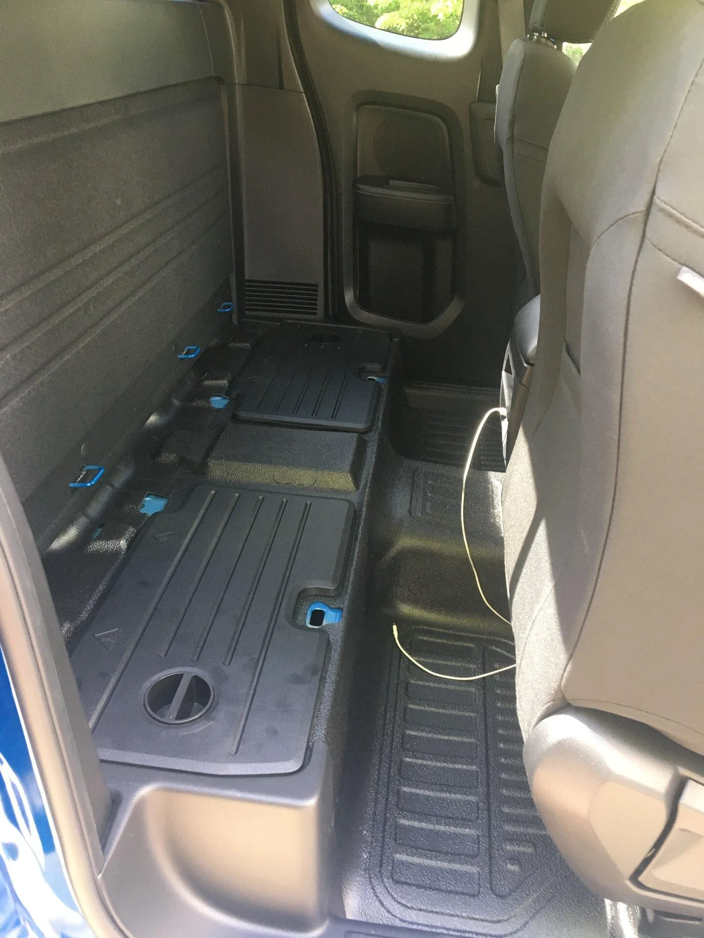

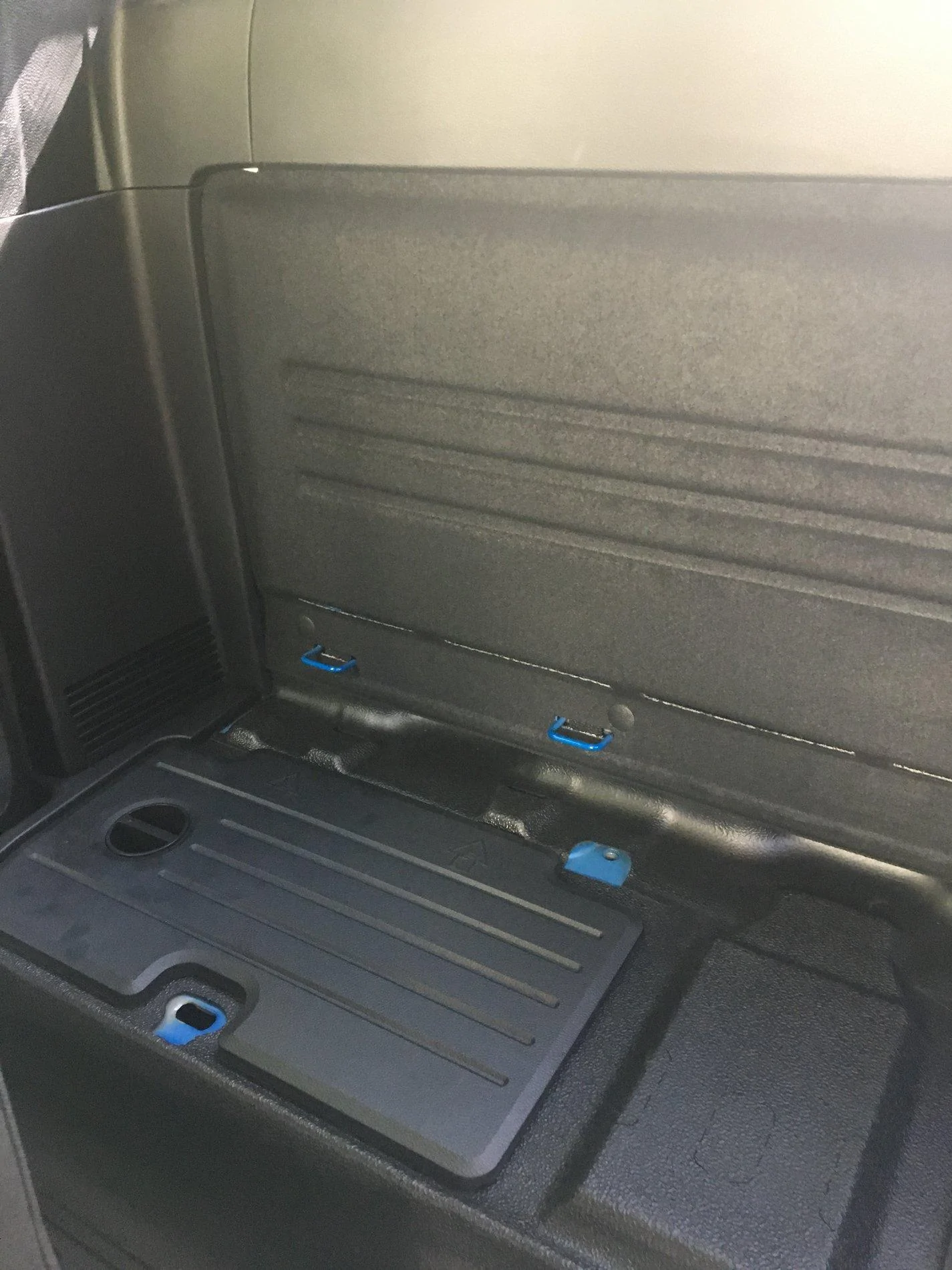

I suppose you could put some sound deadening material behind that panel?
Are the seat backs easy to remove?

Yes the seat backs remove with one bolt located between the headrest posts. You have to peel the child seat anchor velcro cover to access the bolt. You will need a 1/2 inch socket, 13 mm fits too. Once you remove the bolt you have to fight the two clips at the bottom of the seat back to remove it. The only way I could get the clips to release is to grab the top of the seat back and rock it to the left and right until one side unclips. Then you can wiggle the other clip loose.
The sound deadening material is a no go solution in this location. The two cabin vents are located underneath the seat backs. They are a cabin noise source but closing them off is not an option.

Shoot.. I was hope to add some sound deading back there as I put the cover on the back, it seems to be a bit more noisy with the "Drum" sound of the wind hitting it.

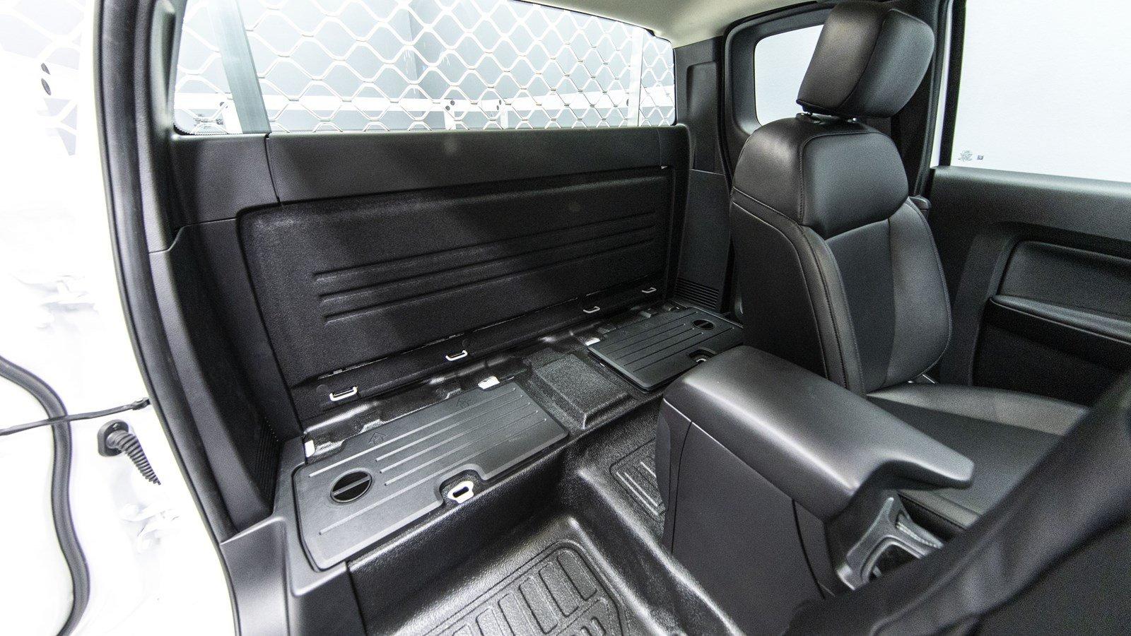

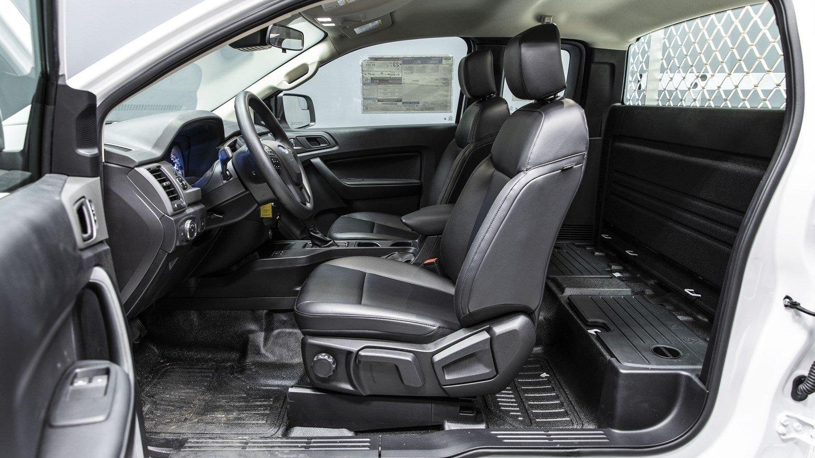

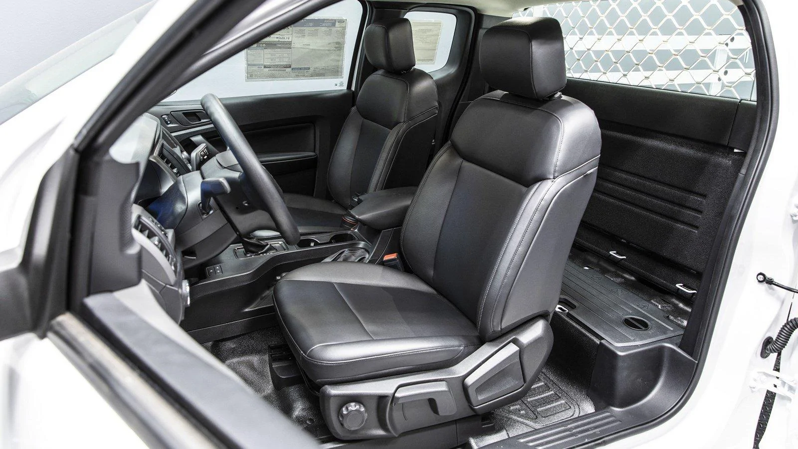

As requested by @rangerdanger, this is what the rear seat delete option looks like in the supercab XL.
Rear seat delete option unavailable in the Lariat trim level, was looking to save the hide off of some hapless bovine...
