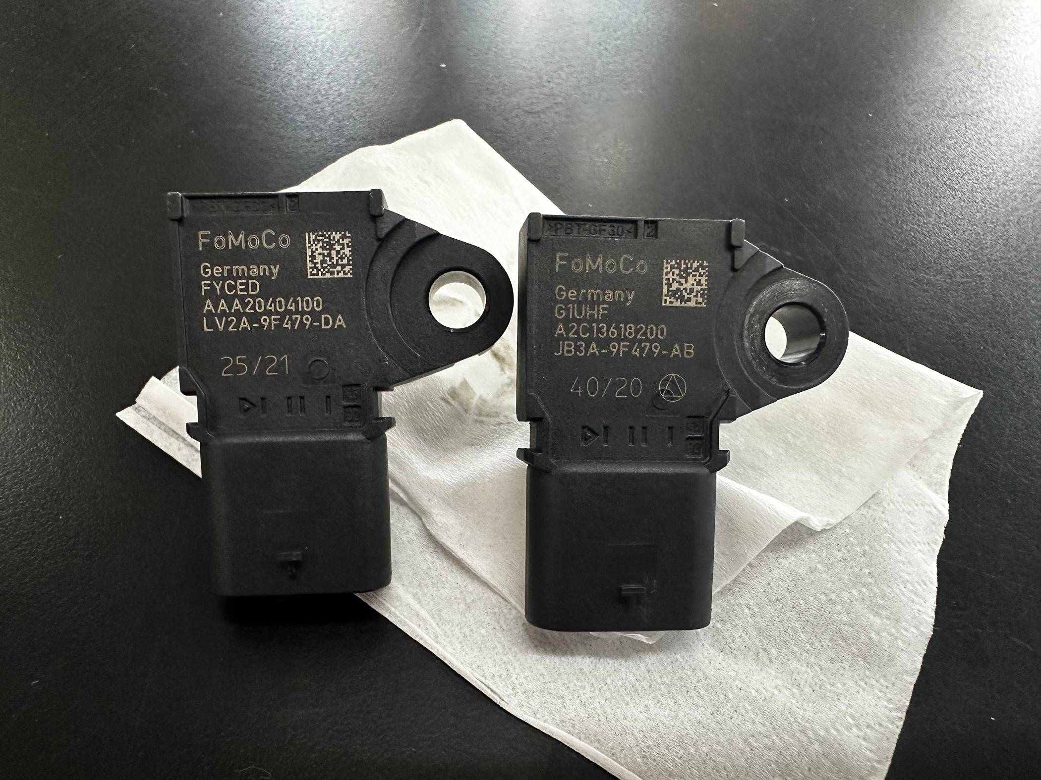

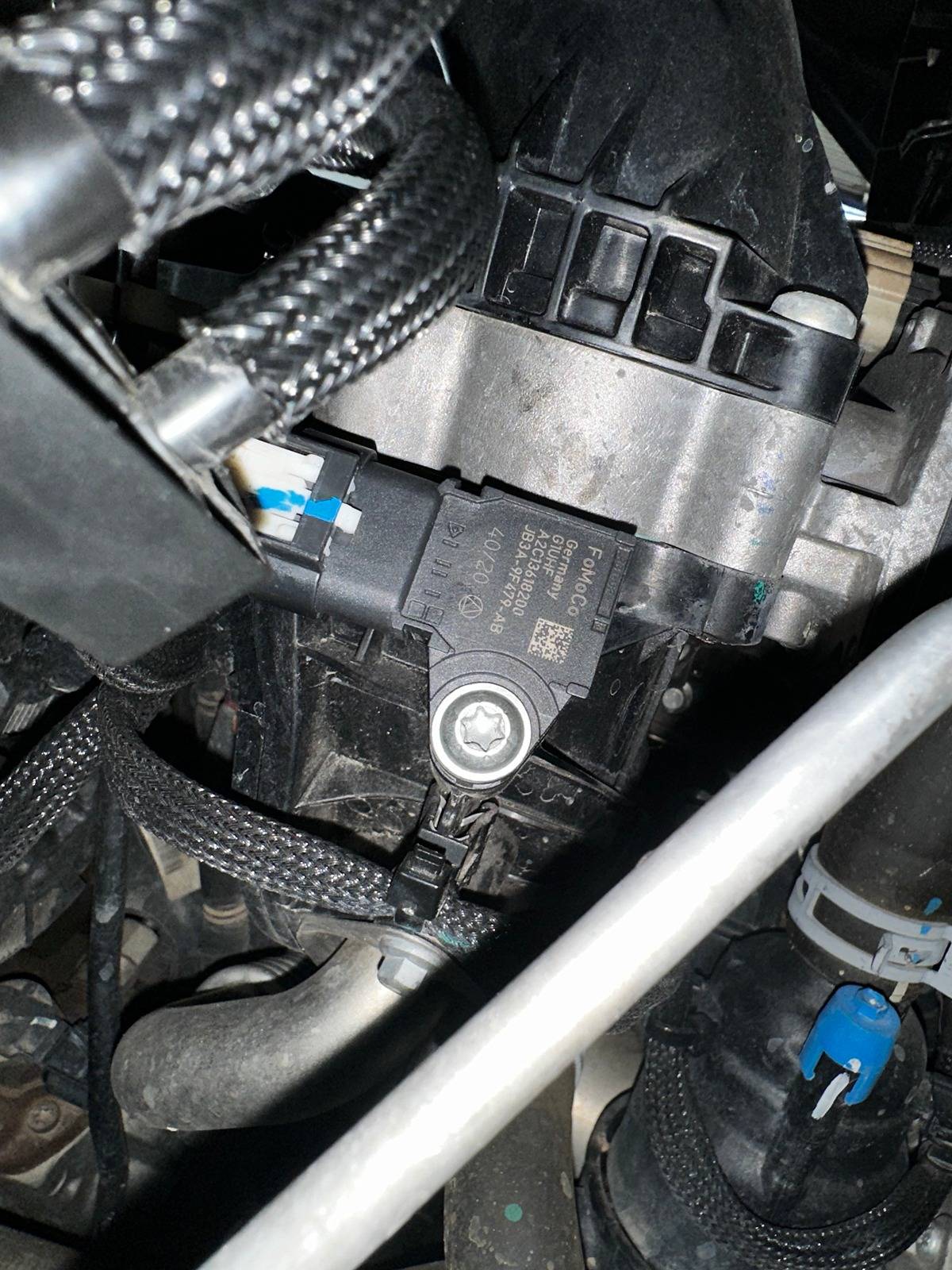

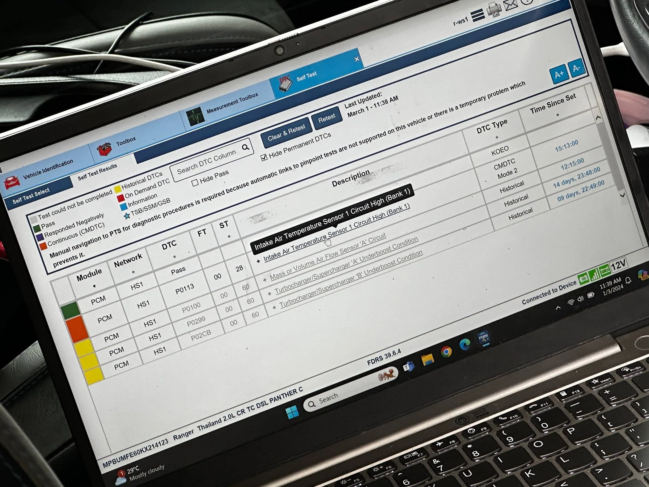

Started noticing the car having RPM fluctuate at cold start, air-con on and in gear, and also bad fuel ecnomy, tried doing some DIY myself and cleaned the MAF sensor with some electronic cleaner, start the car and the check engine light immidiately came on. So I took it back to the dealer again, and that's the scan I got which I attached the photo, they told me the MAF isn't the issue, and might be a broken MAPT sensor(IAT and MAP combined?) which might contribute to the turbo underboost, sensor with photo attached. They quoted me around 320USD for that sensor, which I find ridiculous so I decided to buy it elsewhere myself and change it myself. Found the stockist for Ford here online and bought the sensor for 40USD include shipping!! I've attached a photo with both old and new sensor having different part number, they claimed that it's the correct sensor for my model, it's just that Ford updated the sensor.
Changing the sensor still didn't fix my issue, the car currently still RPM fluctuate at cold start, bad fuel economy, and underpowered. I am desperate, hope someone will be able to help me fix this as I don't want to take it to the workshop if I can as they overcharge. I apologized if my post is somehow confusing in advance.

So yes Ford does have the Intake Air Temp Sensor and Map Sensor combined. This is common on different manufacturers that even the MAF will have the IAT as well built in. It's not as bad as Ford having it built into the EGR Valve at one point.
Seeing those codes, the shop is not wrong that the sensors could be a possibility, but it does not mean you just replace it. You have testing to do. My suggestion is to take it to a local shop with Technicians that know how to test instead of just read a code and want to replace a part without testing(assuming there is no bulletin that applies)

I'm sure I read about similar issues in 2019 Raptors and biturbo Rangers in Australia, but I can't find anything in the groups I'm in. I think it was the MAP sensor. Is that screen grab all the codes you have?

Yeah that’s all I have, I did replace the MAP sensor, it’s the photo with the 2 sensor I have. However it didn’t solve the issue, I wonder if I’m going to need to clear the code for the ecu to realize the sensor has been replaced?
