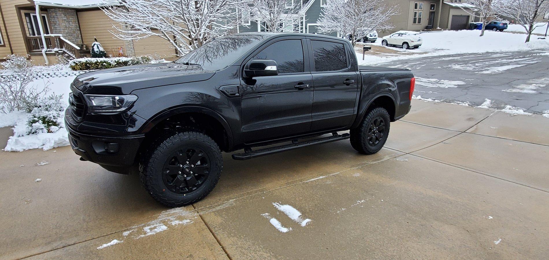

All done for now.
275/75 R18 Falken Wildpeak tires - (Correct tire size is 275/65 R18) Fat finger typo
3" lift/level from Fordrangerlift.com (Rob is amazing just as an FYI)
Rear and front windows at 20% factory tint left on
Windshield at 50%
Tinted side turn signal
Tuxedo ProX15 cover
Weathertech mats front and rear
Livernois tune
Coming soon: tinted mirror signal and tail lights
Possible Raptor style grille.

Clean truck! Do you feel any rubbing with the 275/75 R18?

275/75R18? They don't look that big? Are they 275/65/R18?
You are very correct sir. I did realize my fat finger typo. Correct up top for information purposes. Thank you for finding that.

I put the same size Duratrac on and they are very close to rubbing on the knuckle. How close do your tires sit and have you had any rubbing?
No rubbing. Clearance is tight but no rubbing.
