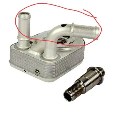

Hey everyone....quick question...think the daughters 2017 Escape may have a leaky oil cooler seal...just wondering if the 2 rubber lines to it are oil or coolant lines!?🤔 thanks for any info!!

Those should be coolant lines from the looks of them.
(I hate posting from my phone, so here is a longer response)
That looks for all the world like a cooler block that mounts to the side of the engine and then the filter mounts to it. The oil will be fed in from the backside of it, so those larger tubes carry the coolant.
Wouldn't be surprised if the seals on the oil side leak, not terribly uncommon.

Thanks! Appreciate it!👍

The kid loves her Escape!!😎🤙it's located directly behind the oil filter...the filter screws o to it.
