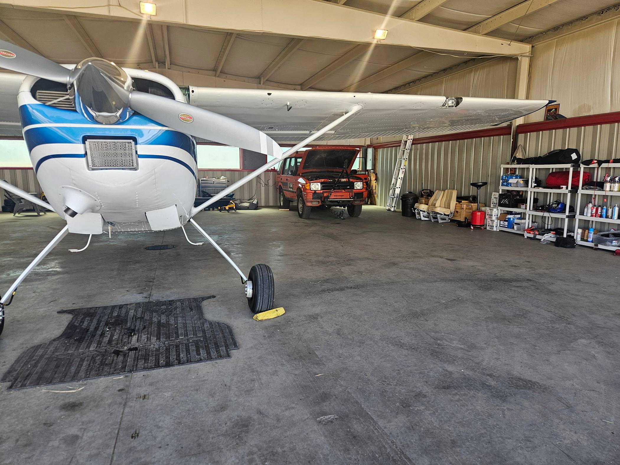

Progress is going to be on hold for a couple weeks. I can't afford to heat my hangar in these temps!
Don't blame you for putting that on hold for a while. Stay warm!
