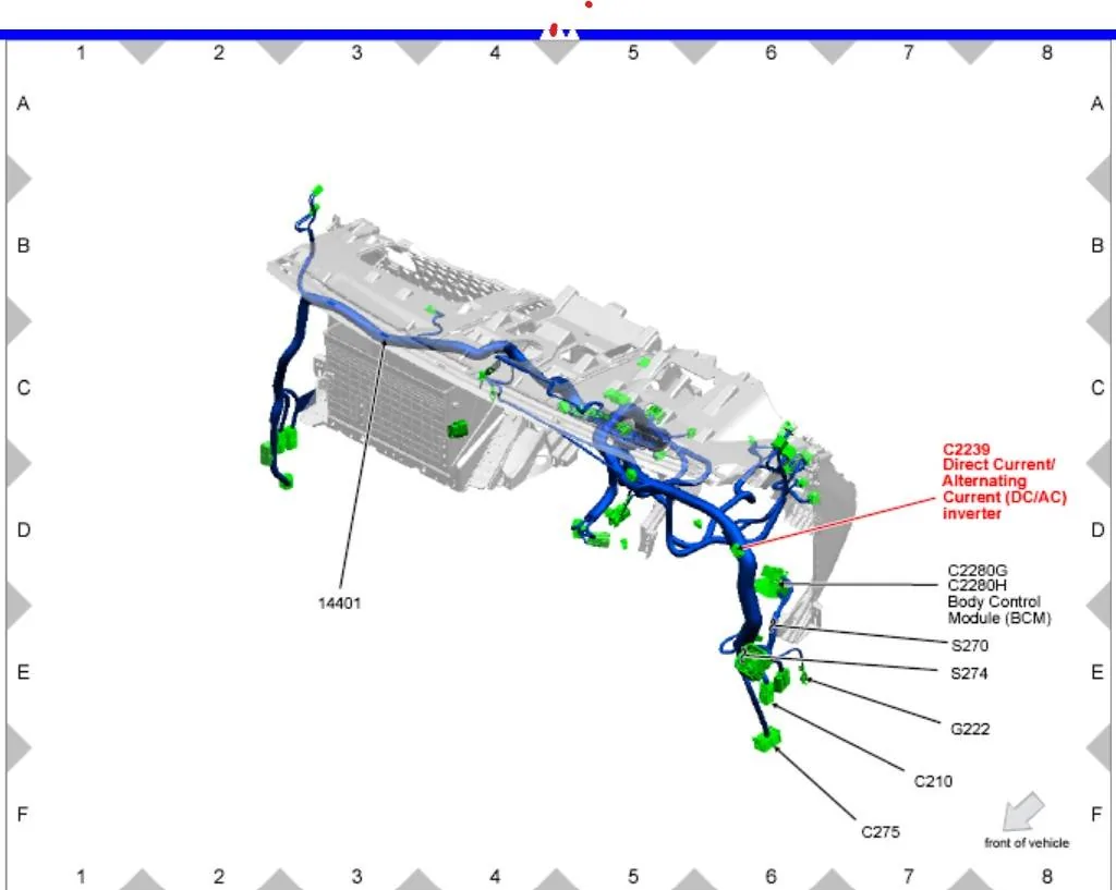

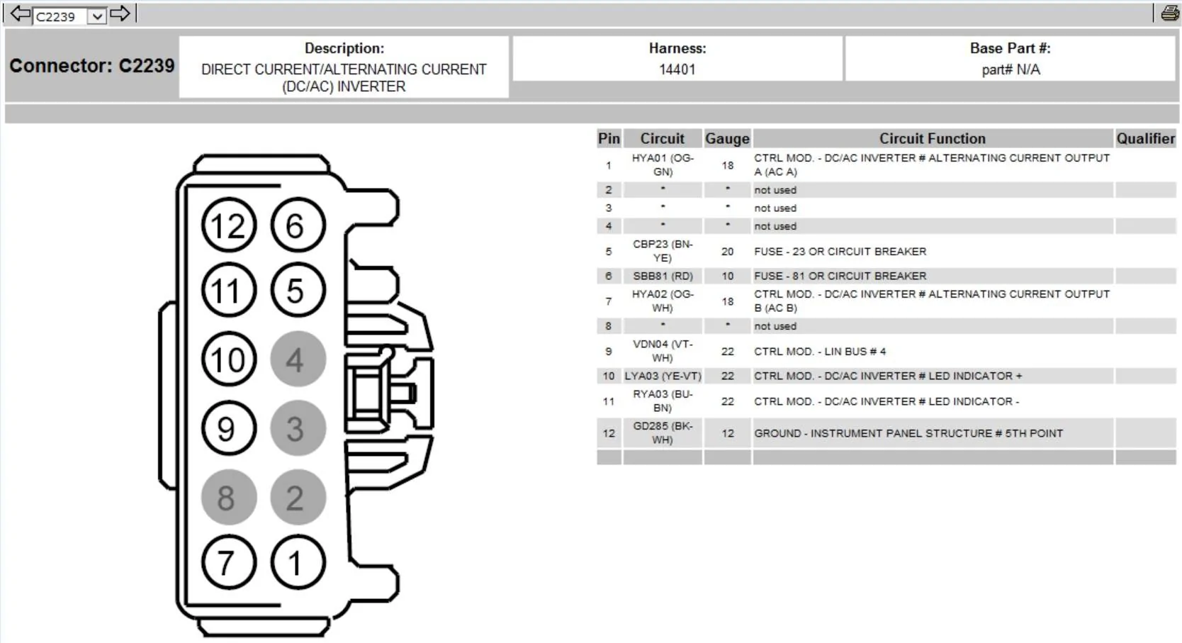

It is probably a blown F81 fuse in the BJB. Check for power on connector C2239 pin 5 (fed by F23) and pin 6 (fed by F81). C22239 is located on the DC/AC converter.

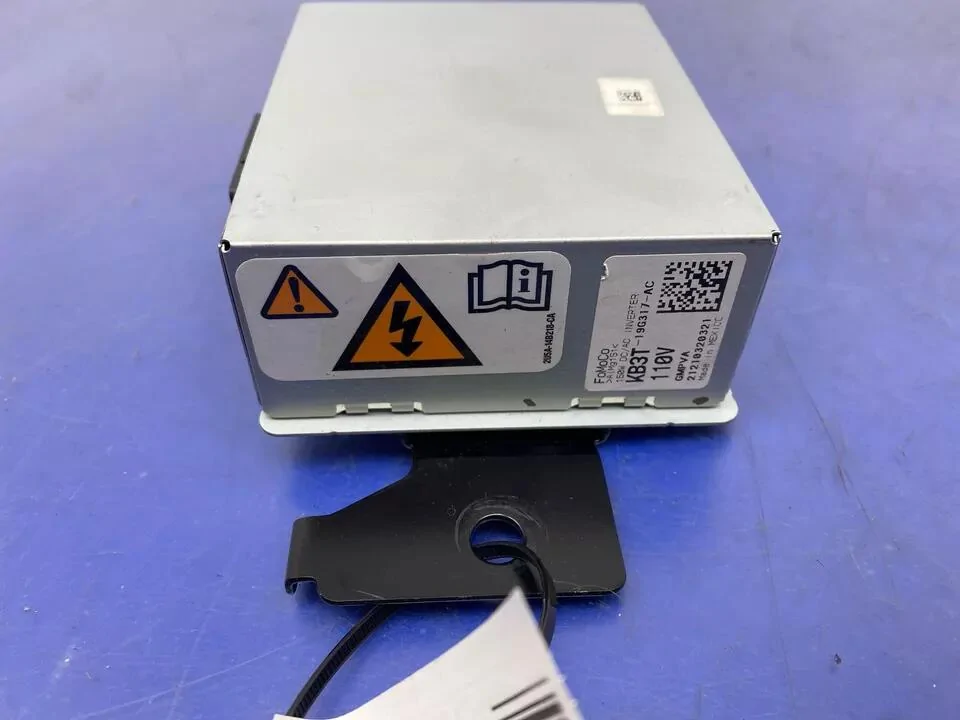

The DC / AC Invertor is located just below the Headlight Switch
Pin #5 = Fuse 23 - Brown / Yellow
Pin #6 = Fuse 81 - Red
on that 12-Pin connector

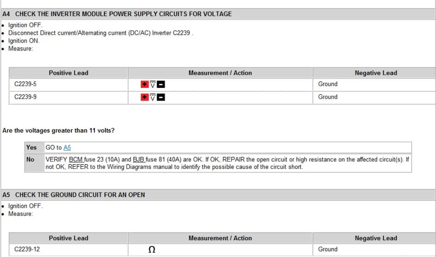

Most Likely - Fuse 81 is blown, and you may try a BCM - Self Test (reset) if it has coded to get it to reset the code.

The frustration part is , that the manual location does not match physical location as I cannot locate it - physically

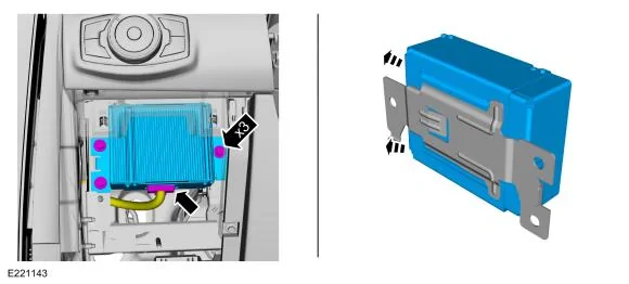

Update:
I see now as I found it - this pic is showing the location of the Invertor, and it is there.
However, the pic has the BCM removed for clarity - so if you look around the back side of the BCM (Fuse Box) you will see the side of the Invertor and the attaching bracket.
I knew it was there, I just never really took the time to actually locate it.
This is the side you can see and the labels.
If you move the seat all the way back, you can snake your head forward enough to see the bottom of the invertor and see the connector, or you can by feel reach up and disconnect it.
From another post the harness should drop low enough for T/Shoot - (Power)
However, this is from a truck that I believe did not have the invertor installed as it was tapped.
It may be easier to just pull the (BJB) and get access to the bottom for Fuse #81. It depends on how much slack that harness has and will it drop low enough for easy wire checks.
