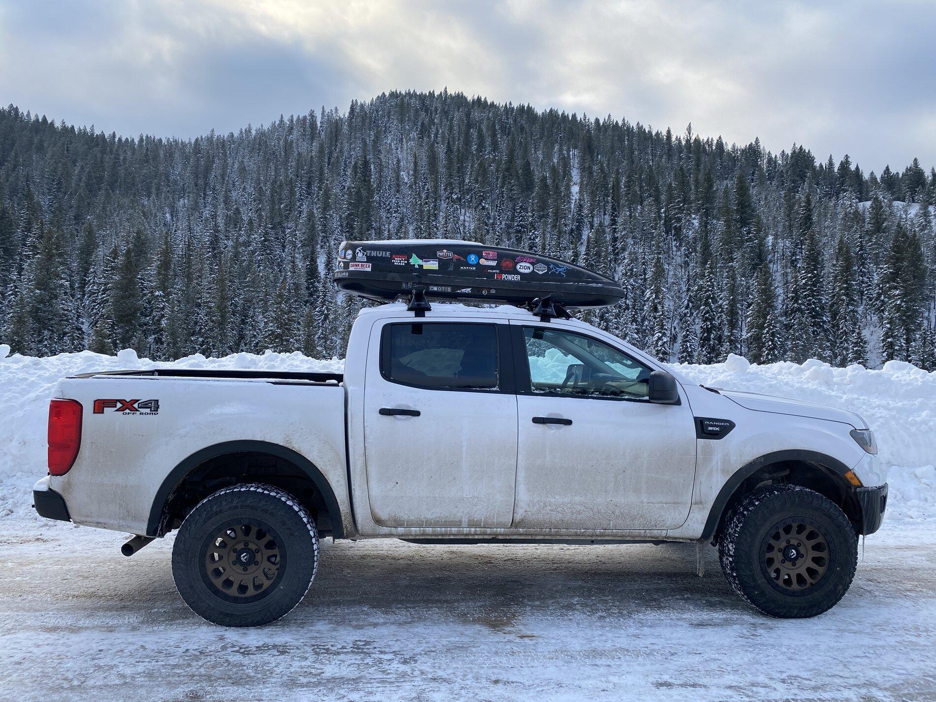

Yakima bars and towers with Thule box
My apologies for bumping an old thread, but do you know the spacing that you used on your roof bars? Got some used Q Towers on marketplace and trying to dial in the width for the 5G Ranger.

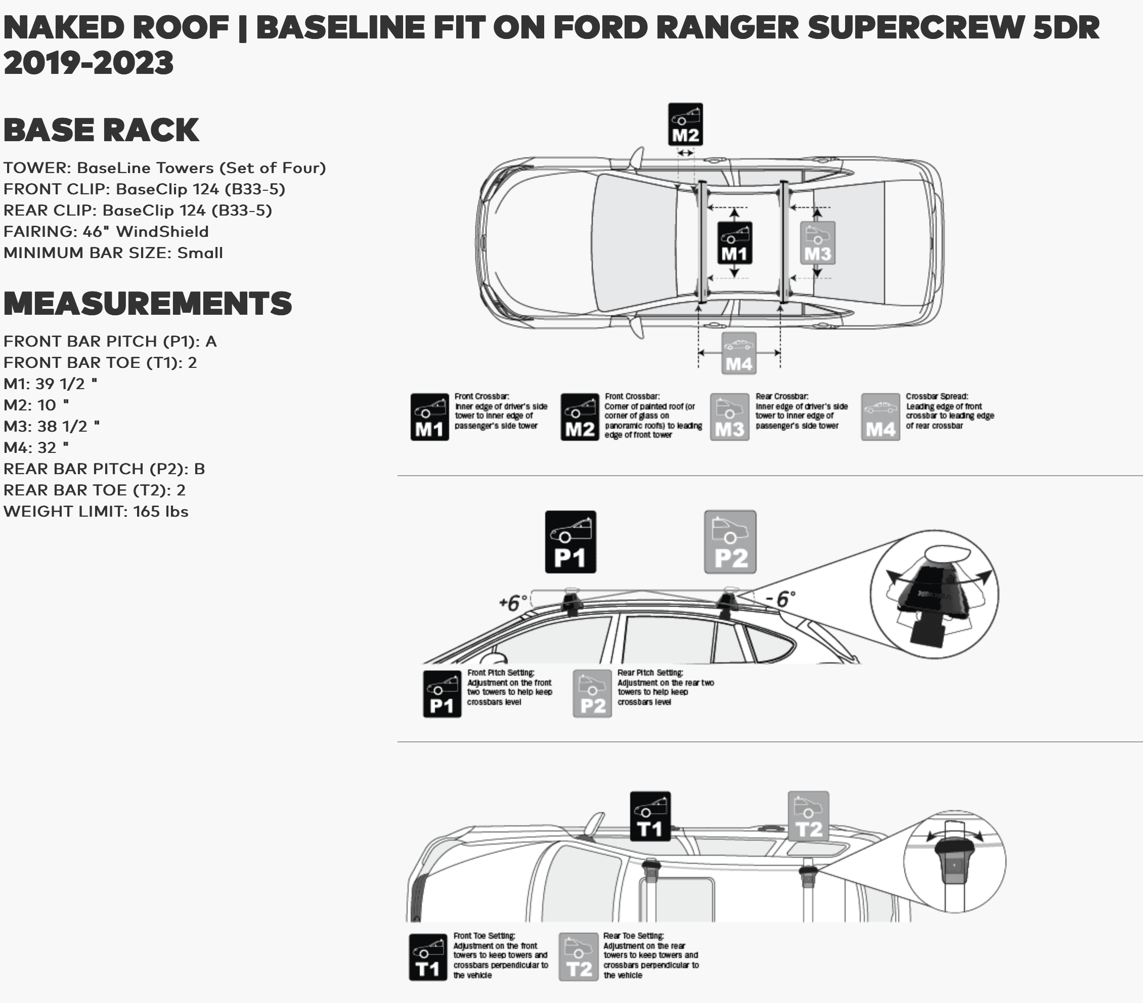

Specifically the width of the bar between the towers. I have mine set around 40" but there is a little slipping on longer trips with a load.
Jedadiah
Jed
Jun 10, 2021
366
965
Central Kentucky
Former '21 SuperCab Owner

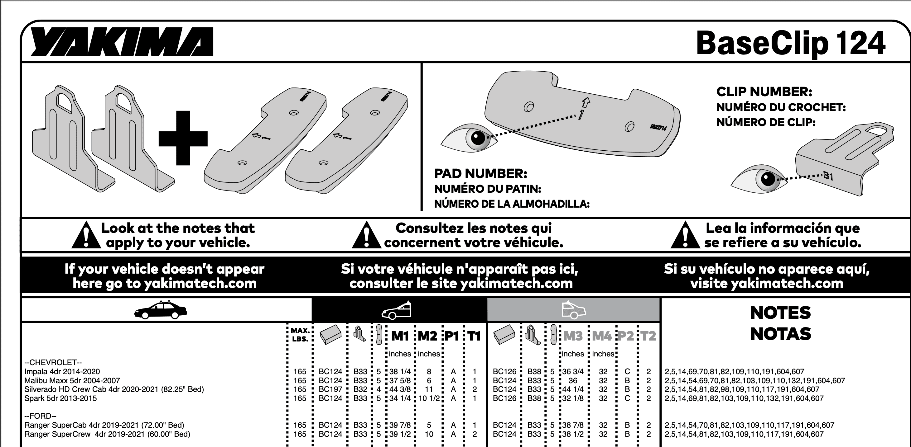

Both the SuperCab and Crew use the BC124 fit kit with baseline towers. Spacing between bars is 32"

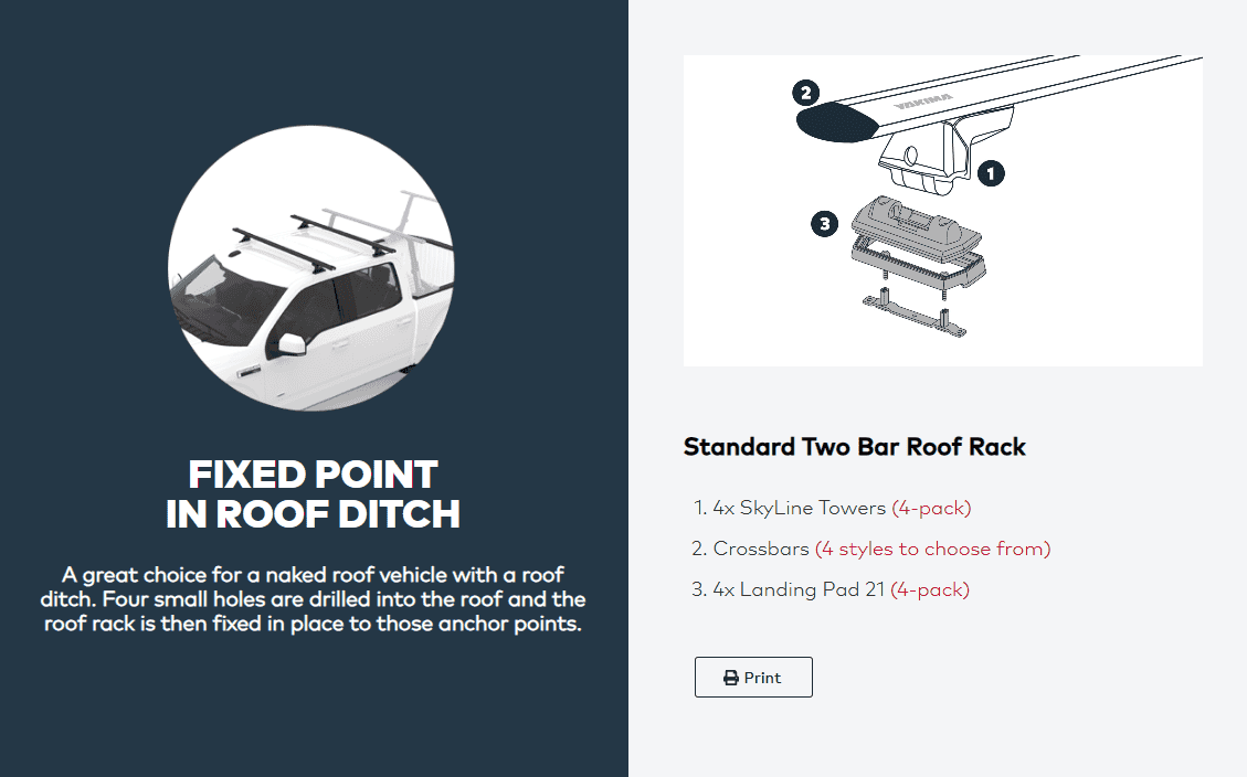

You can also go the custom install route. Yakima shows at least 2 different Rangers with this kind of install on their website.
Custom Install - Roof Racks | Yakima
Some of the towers, at least, will attach directly to their platform, but you can go with just the basic crossbars if you like.
