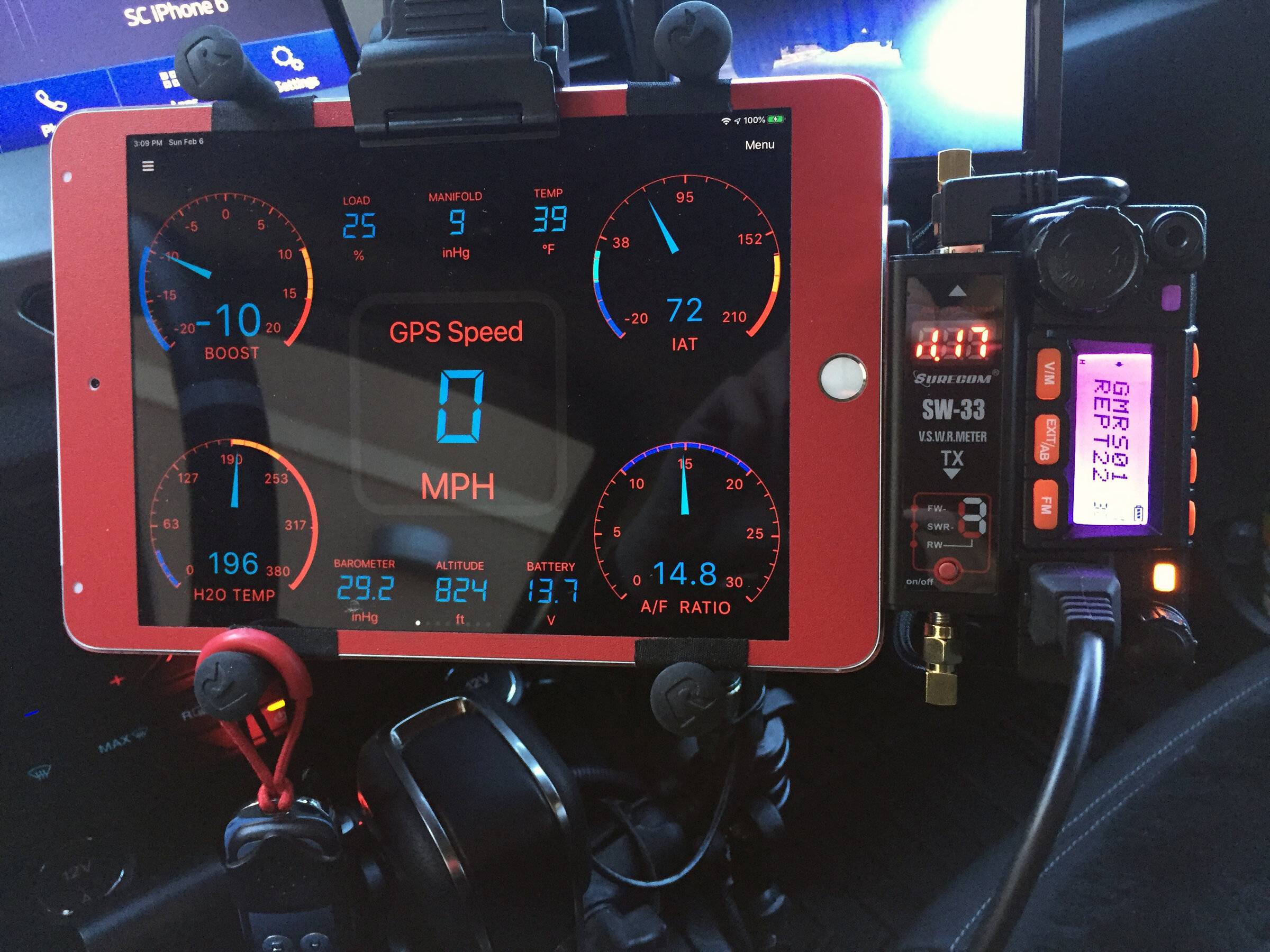

No but there are other ways to do it using your phone or a tablet display. Get a wireless obdlink mx+ Module and load software into you device and you can program any of the PID’s into your display for the “skin” you pick on the ODB link software. As an example of display https://www.obdlink.com/mxp/apps/

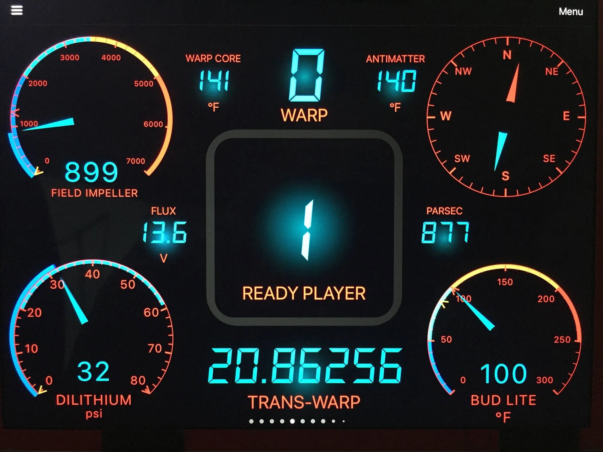

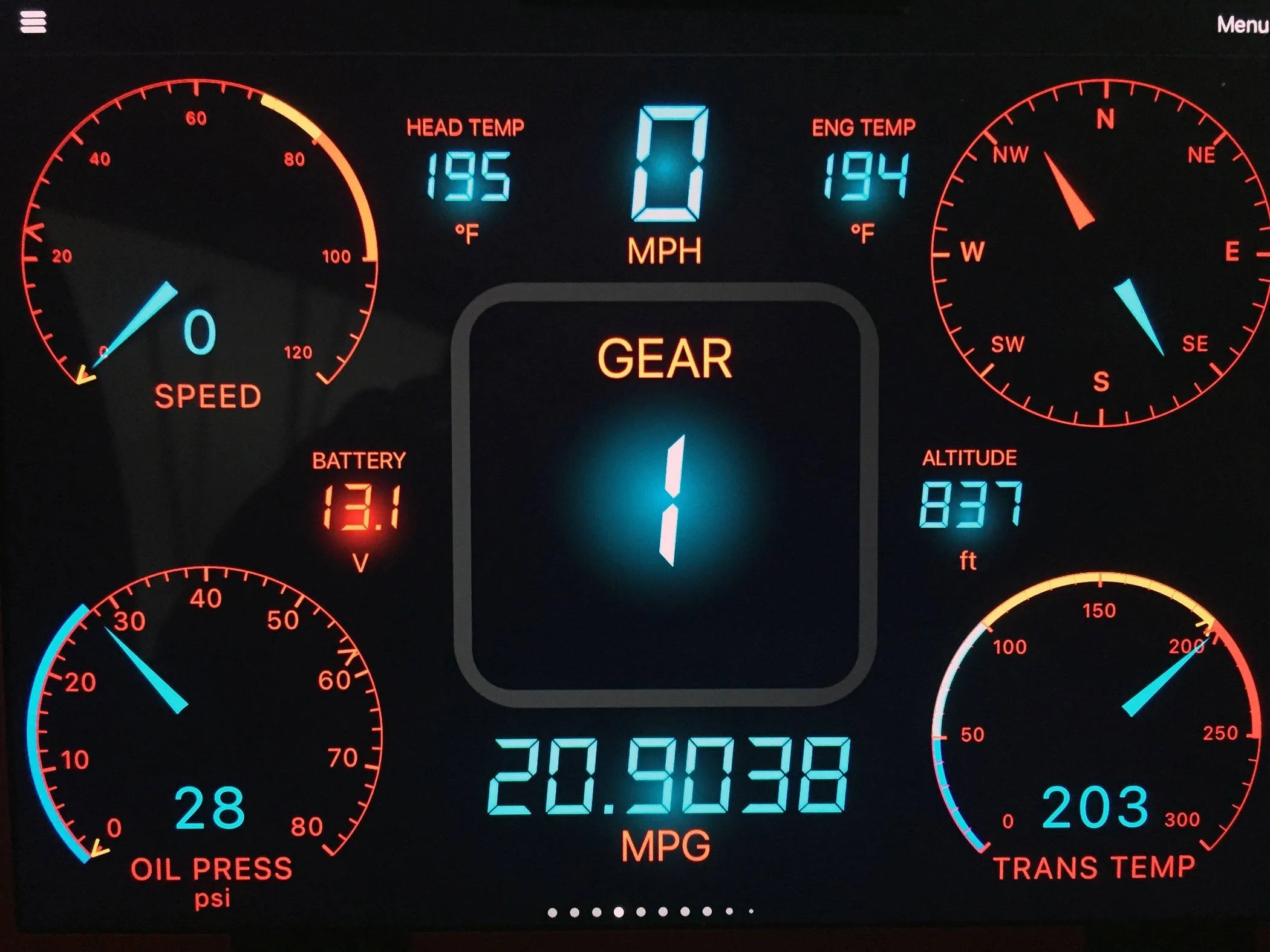

I also use OBDLink MX+ which displays Trans Temp.
Pics below show two of my customizable Dashboards . . .

I purchased the Ford Powertrain PID a while back and voila!
Enterprise mode...?
what app is that? and that is IOS? how much was the PID

You can also purchase individual years for pids at $15 if staying on a budget
