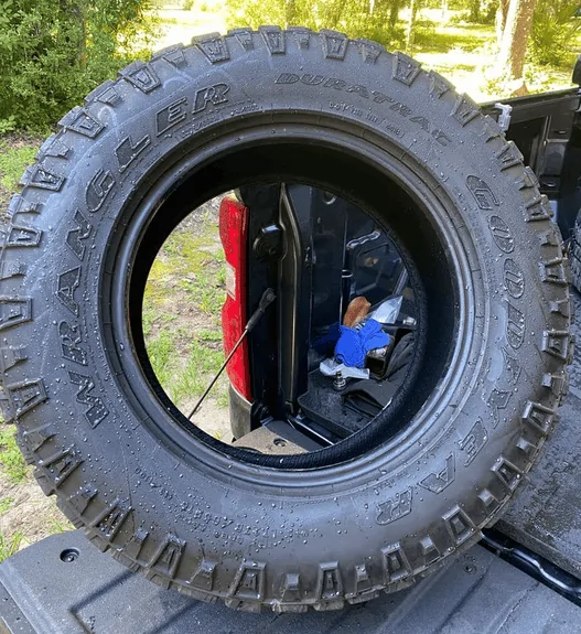

Will Goodyear Wrangler 275/75R18 A/T mud tire fit my Ranger without any mods?

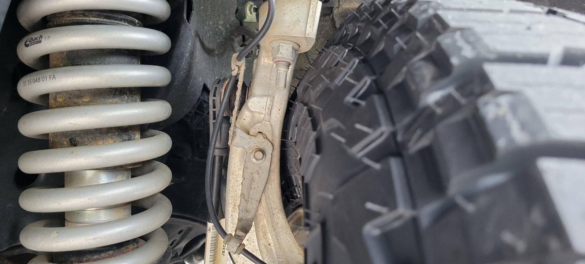

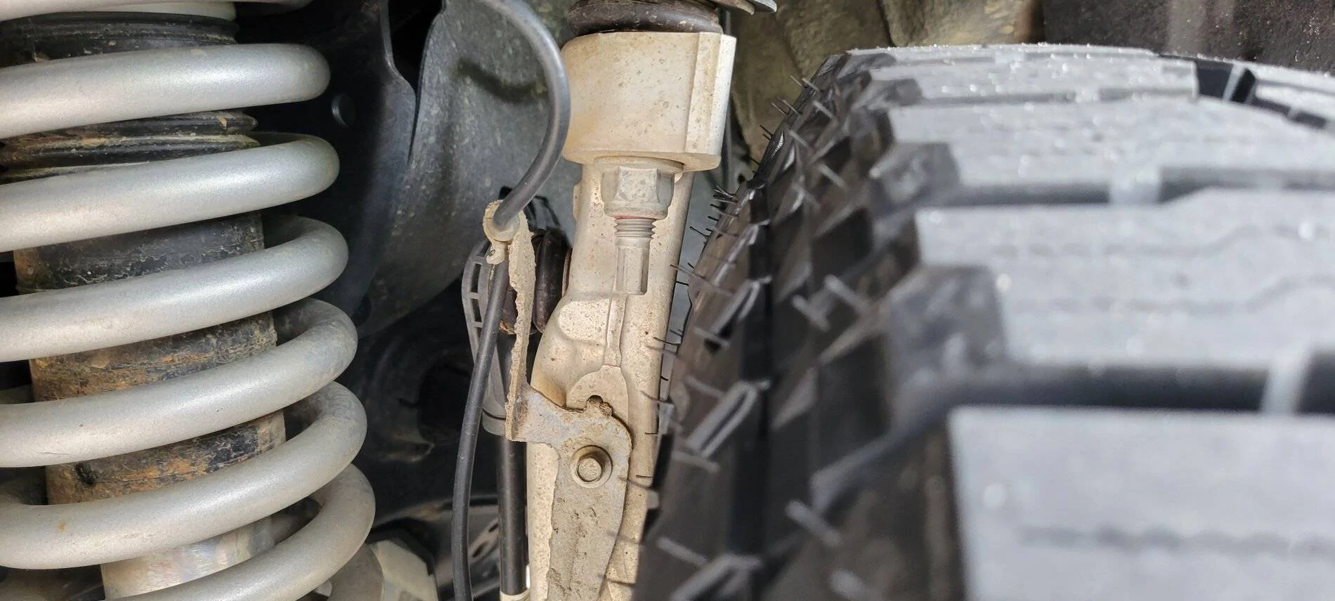

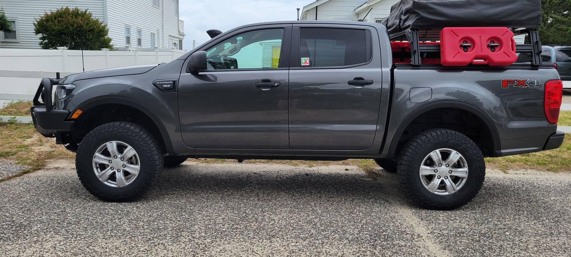

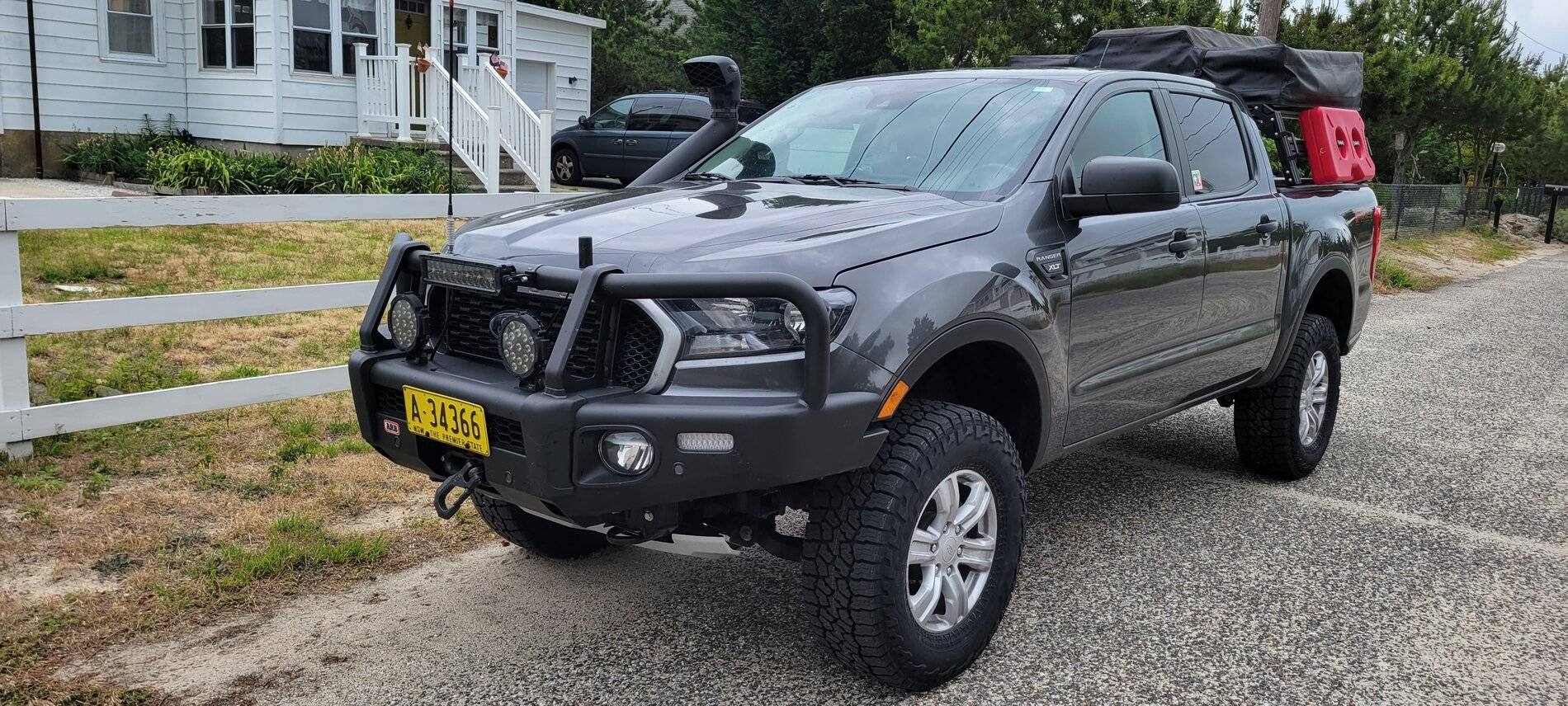

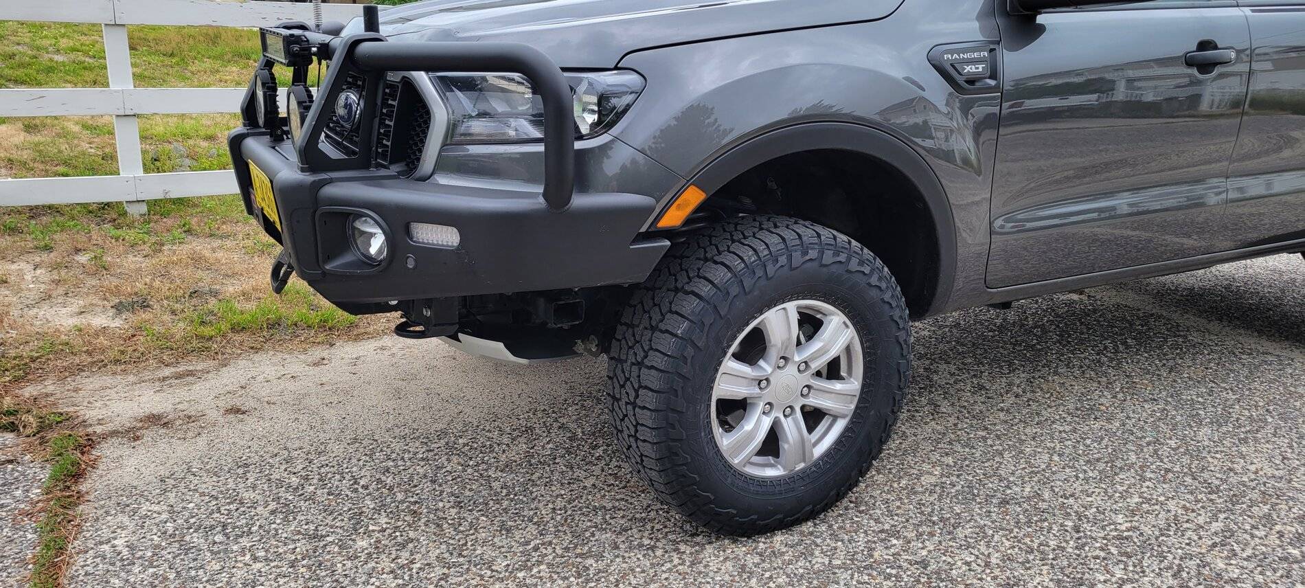

Yeah, it's going to be tight. First thing you could try is to loosen the bolts on the front crash bars and push them as far forward as you can. You might possibly have to remove them. My biggest concern would be with your knuckles up front. My tires (Falken Wildpeak 275/70R17) just clear the knuckles. I'm leveled too.
