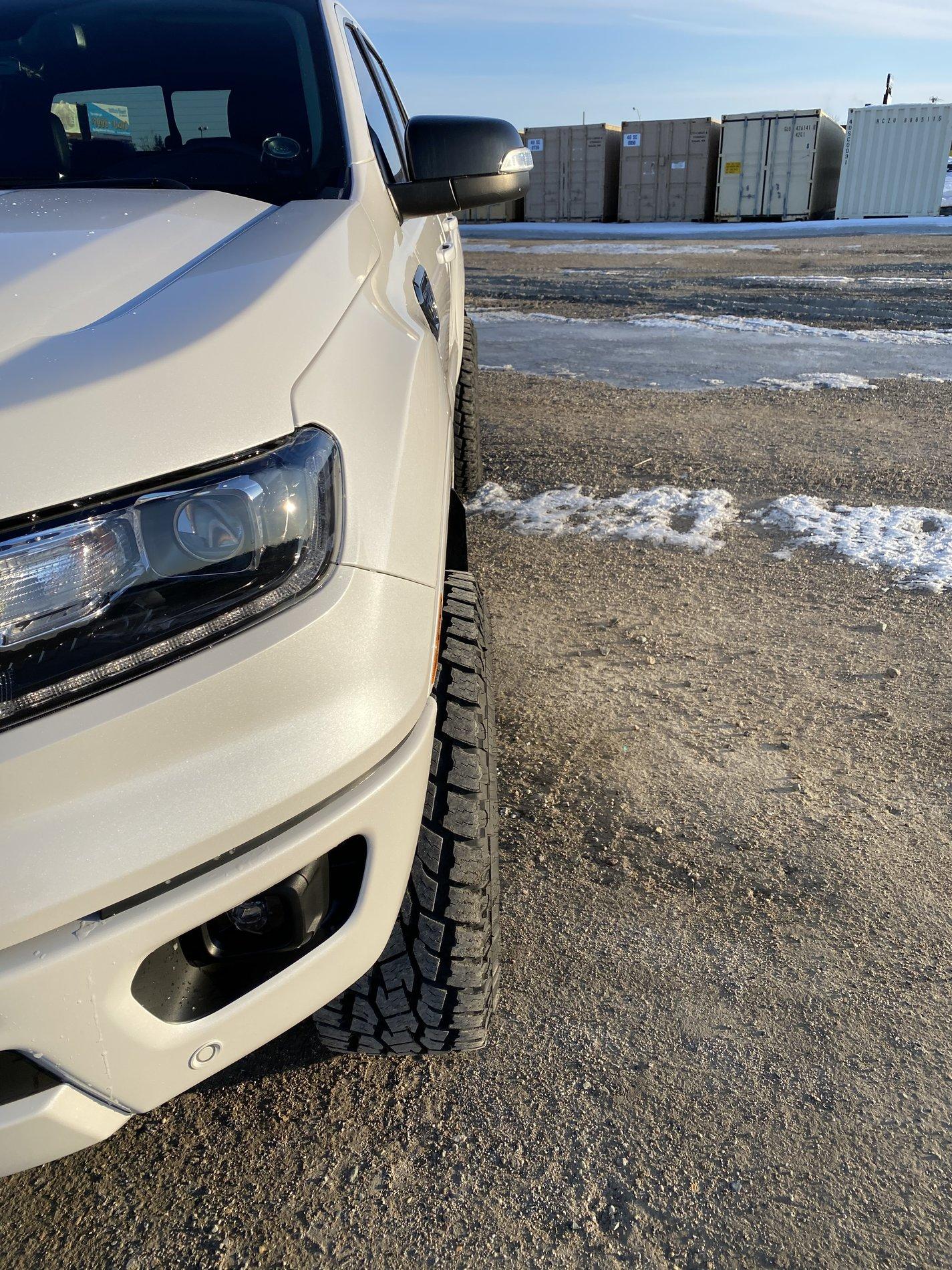

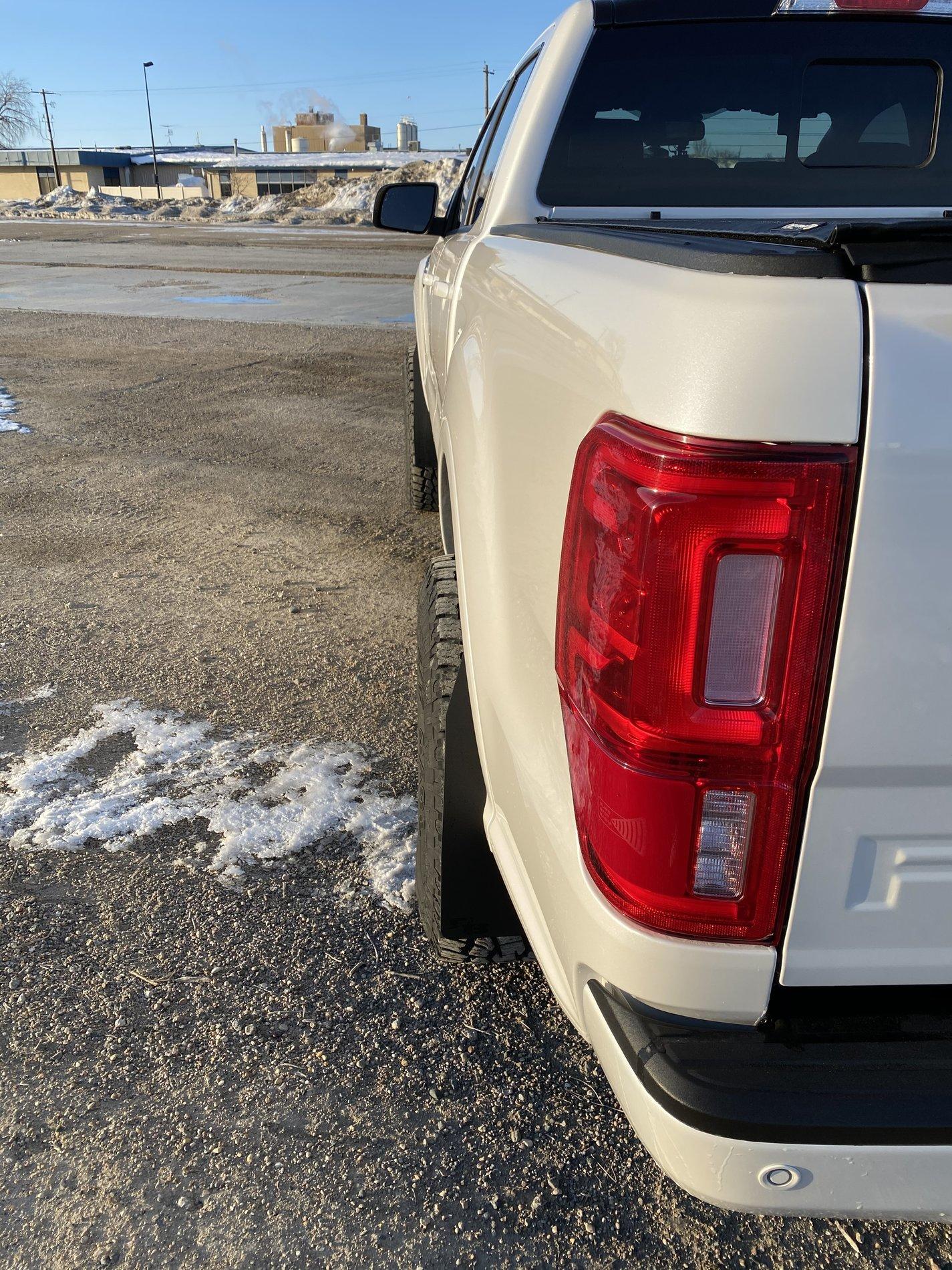

For reference, this is what 0mm offset wheels look like on a Ranger. My tires are pretty wide though, 305s. Fender flares are up next.
Skyler
Skyler
Oct 29, 2020
Ford Ranger
What are the specs on those tires? I want to run 305/70/17 which are 33.9x12.2r17 but idk if I’ll have to trim the wheel well for off-roading. Crash bars for sure
treimche
Troy
Apr 8, 2019
722
882
FORT MYERS, FL
2019 Ranger SOLD. 2005 S2000
Accountant
Mine are 305/70/16. Wheels are 16x8 0mm offset. They rub on my mud flaps at full lock. I'll be going with 285s once these tires are worn out.
