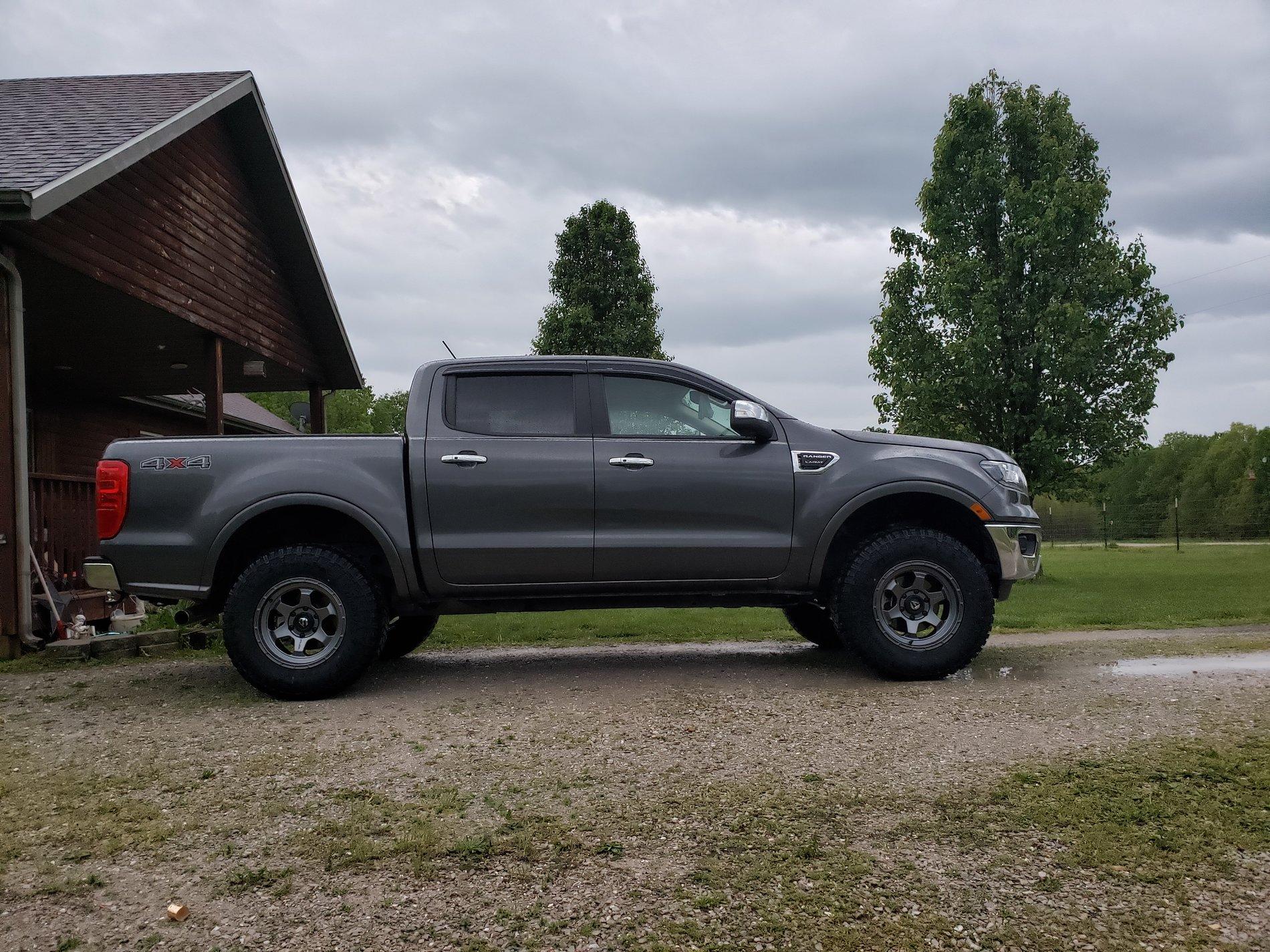

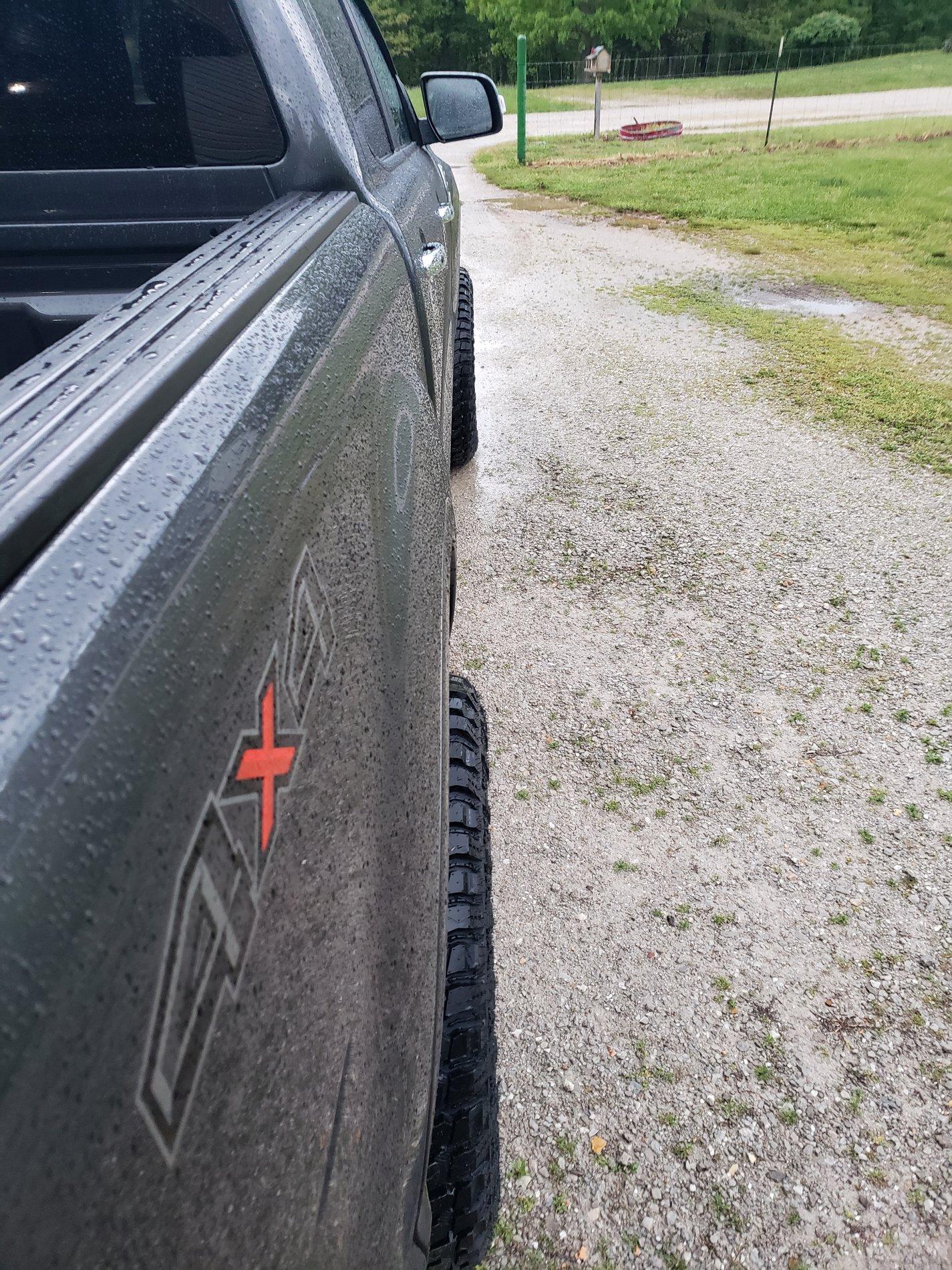

i can relate to your question. I did some searching and looking at tires and offset. I finally settles on 285/70/17 with 17x9 +20 offset and very happy. i have thread in build section with all the details.
tires very quiet and yet look aggressive

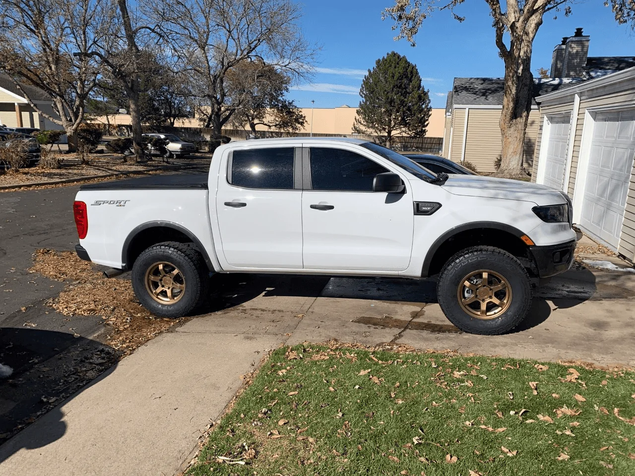

WheelHero.com
$1550 for tires, rims, TPMS and they came mounted and balanced with new lug nuts.
Motegi 17x8.5 +18mm offset
285/70 17 Ironman tires
Just a slight rub on the front driver's side crash bar(bumper bar), no rub on passenger side.
2.5" RC front level
