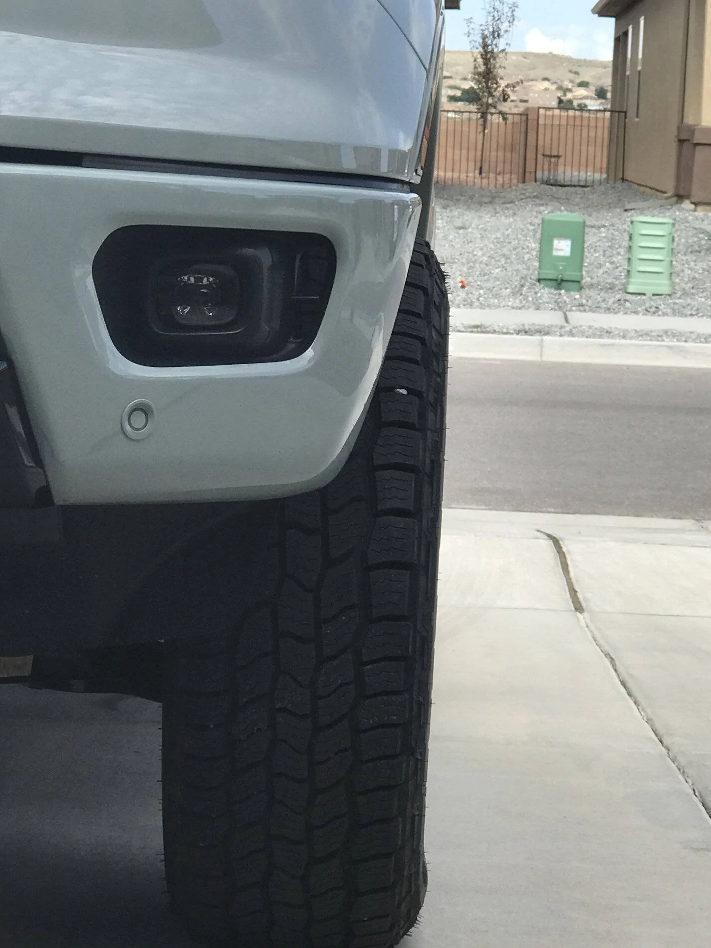

Ok. 1.25” spacers on. Just test drove. With 33” tires it’s a little too much. Shoved the crash bars forward and get a tiny bit of rub backing out of the driveway. Would definitely run offroad. Guess I’ll get 1” sometime.
