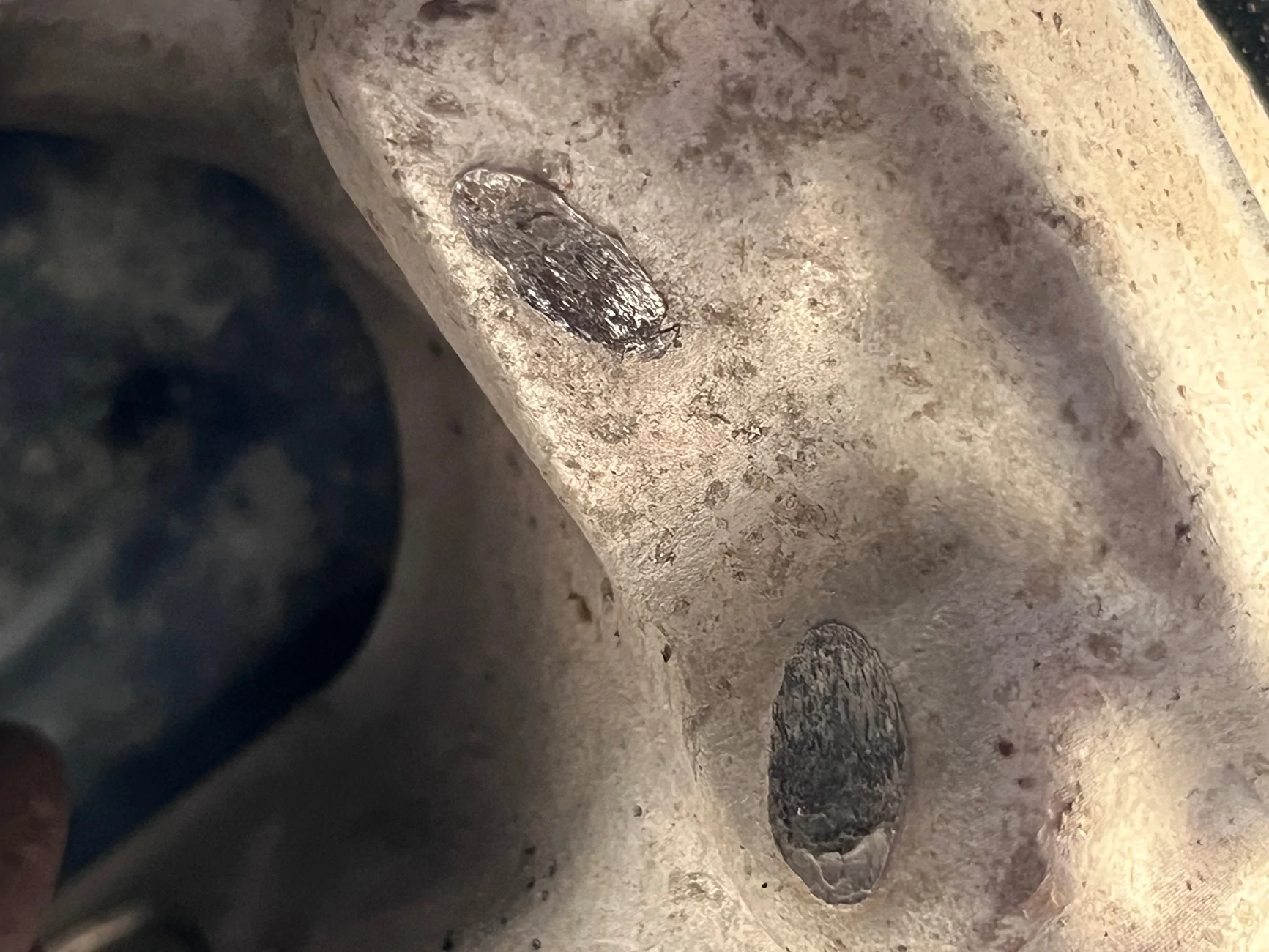

Wheel Hub contact wear Ball joint/ Alignment?

I noticed wear marks on both front wheel hub assemblies near lower ball joint / lower control arm. Have had a Fox 2.0 1.5” lift quite a while now using stock 265/65/17 tires. Recently install 285/70/17 Falken Wildpeak tires with Fuel Covert -14mm offset

Both my truck and the wife’s have the same marks. It’s your steering stops. Totally normal.
