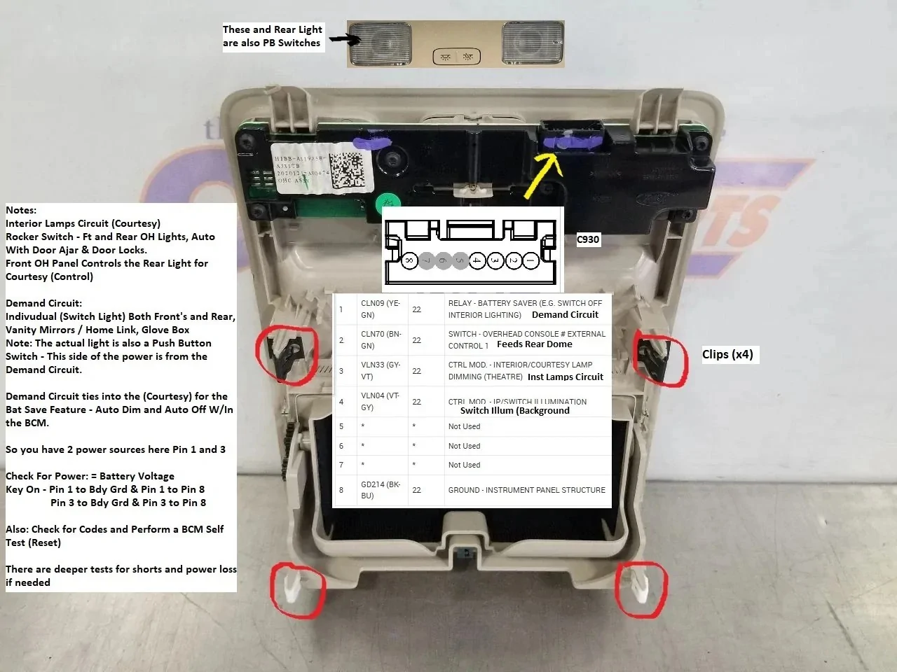

The map lights also work individually. Press directly on the light to turn only that light on or off.

It sounds like the (Pass) Light/Switch is sticking - Try Cycling it.
As stated, each Light is also a switch - Press on the actual light
as noted here

Amazing. I pushed on the passenger light once, and now there is no problem. I don't know that I would have ever figured that out myself. I can guess how it got that way, though. My wife has dementia, so it would have been logical in her mind to press the actual light. It certainly wouldn't have made sense to me. Thanks!
