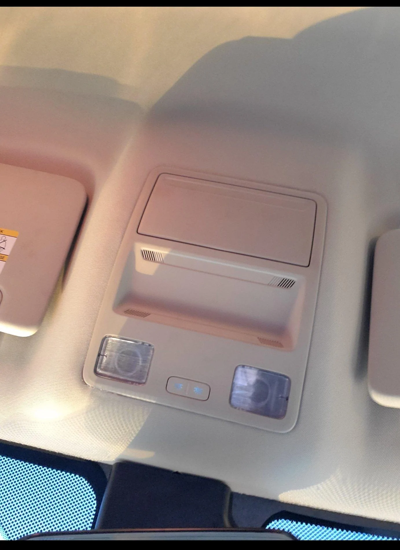

does the headliner on the XL look the same so that the piece shown above should be able to pop into place?
I have an XL on order, and would like some overhead storage as well, but haven't spent enough time inside any models to know the differences in the headliner....
I don't think it will be a direct replacement unless someone has a suggestion.

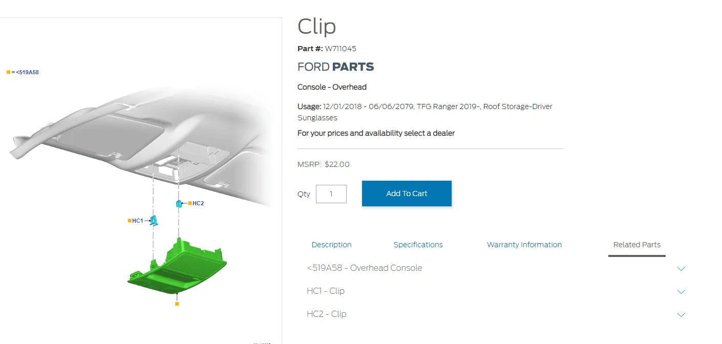

Overhead console, not really enough room to hold sunglasses but here's the info.
The more I look at the diagram and think into it, I have to wonder if Ford really went through the trouble of making different headliners or if the replacement console would be a drop-in with a tweak to the inside of the roof. Anyone have input on that? Just drives me nuts that they nickle and dime stuff like the glasses holder. Makes no sense.

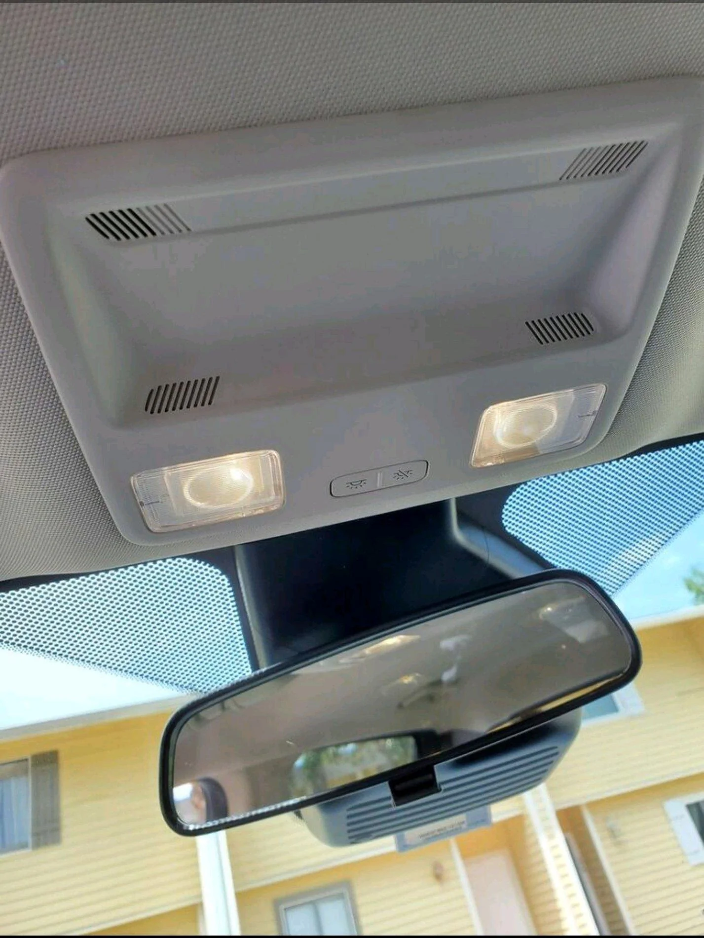

Alright so I accomplished the overhead console switch out. It was not super easy but it is doable. I bought the overhead console from a junkyard, then I had to buy a special bracket from cheaperfordparts.com. then cut the headliner a bit. It is harder then you might think.
