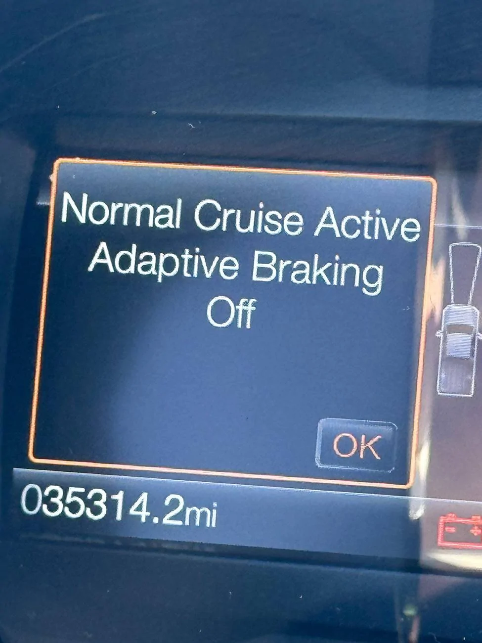

The U014 code may be related to your Adaptive Cruise Control message.

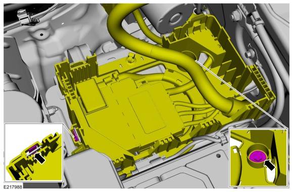

I would pull the Run/Start Relay as a starting point, I think the PCM Power Relay is good, as in your first video post - I hear the - Waste Gate Actuator - Moving (Whine) so the PCM Power Relay is closing.
The relay is located in the (Upper BJB Box) Engine Bay Fuse Box
