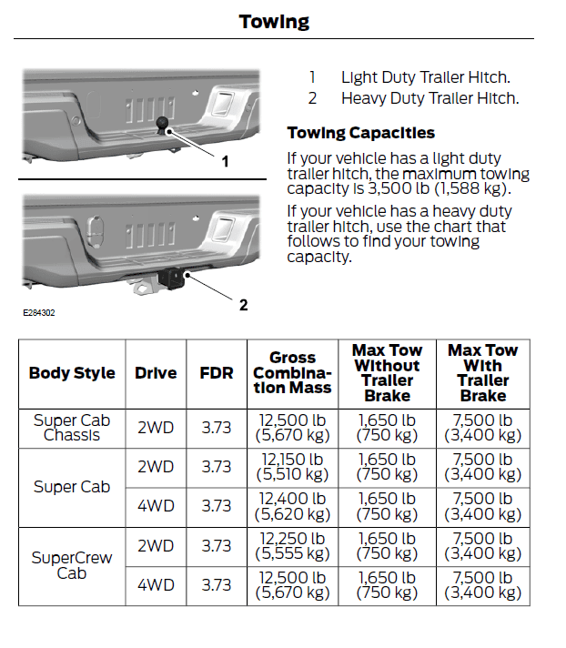

Towing is 7,500 lbs (with tow package) across the board. Payload is different based on options.
SuperCrew 4x4 has a 1560 lbs payload. Take off a little for FX4.

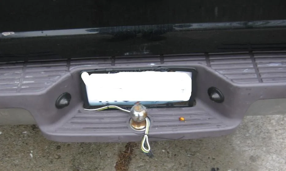

tow package is different than bumper tow with a ball only.

I was saying that you sure wouldn't pull as much w/ a bumper pull set up like in this attached picture compared to the tow package set up.

Sorry, As I couldn’t emagin someone towing 7500 with the bumper only, I missed what u were pointing out. Thanks
page 210 of 2019 Ranger Owners Manual
