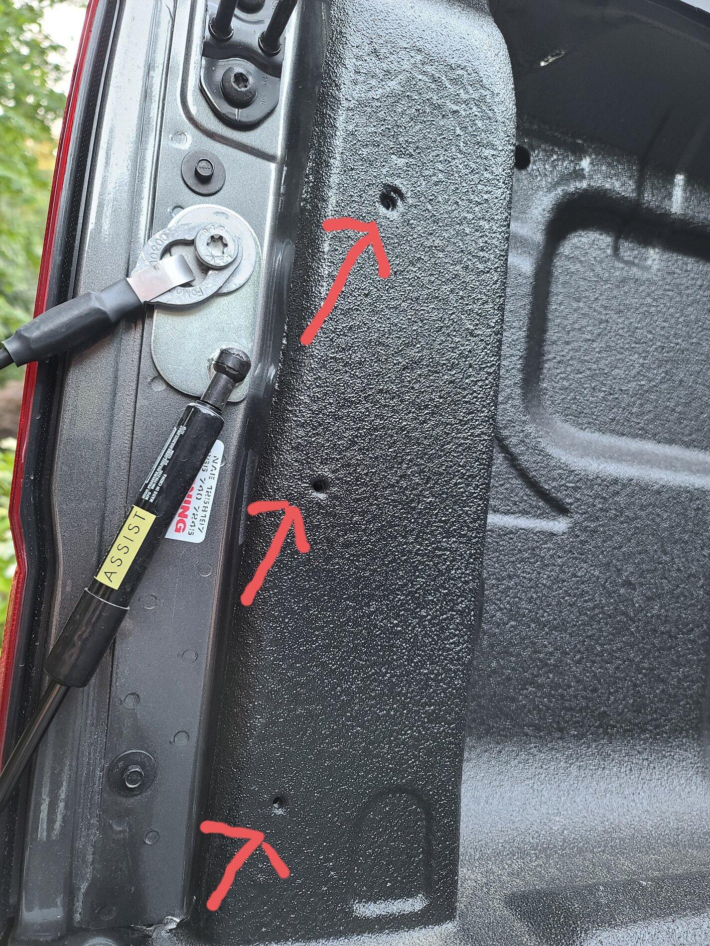

Try as I might, I've been unsuccessful at finding what size bolt and thread pitch these holes are (see photo) I know they are metric but the actual size eludes me. I'd like to get them cleared out of the spray-in bed liner before ordering the swing out
storage box. Any help would be greatly appreciated.

the swing boxes come with the screws so you can measure them (with a die)
to be certain

M6 x1.0 tap to chase them out. Just had to do that on mine, after finding the damn holes in the first place.

The threads are 8M 1.25 tap and drill at Lowes about 8 bucks i think just did mine was cross threaded worked fine. I think the brand was Easton came together.

the cargo tie down spots are different (those are M8). had to clean those out, too, when I put the middle tie down in.

Thanks for all the input they are in fact 6mm x 1 bolt holes. I ran a starter tap through them this afternoon and I'm good to go now.
