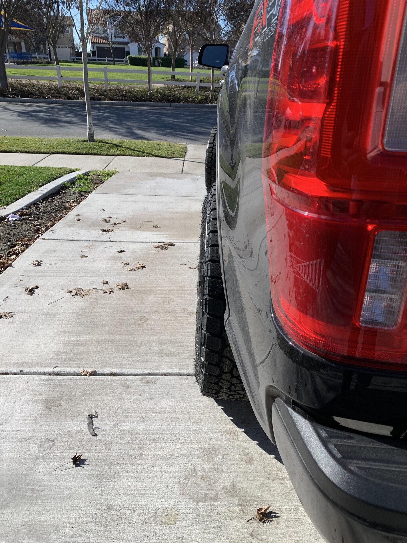

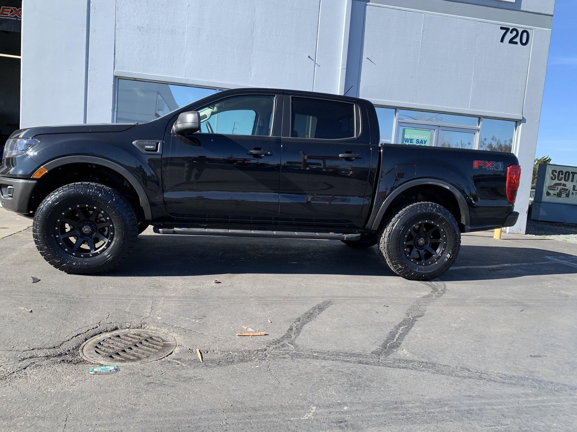

Took the running boards off and there is a side picture the front is turned to the right so it looks like it’s sticking out but it’s not.
I have to take it and get the tires re balanced next weekend as there is a shake in the steering wheel around 50 but love it so far!

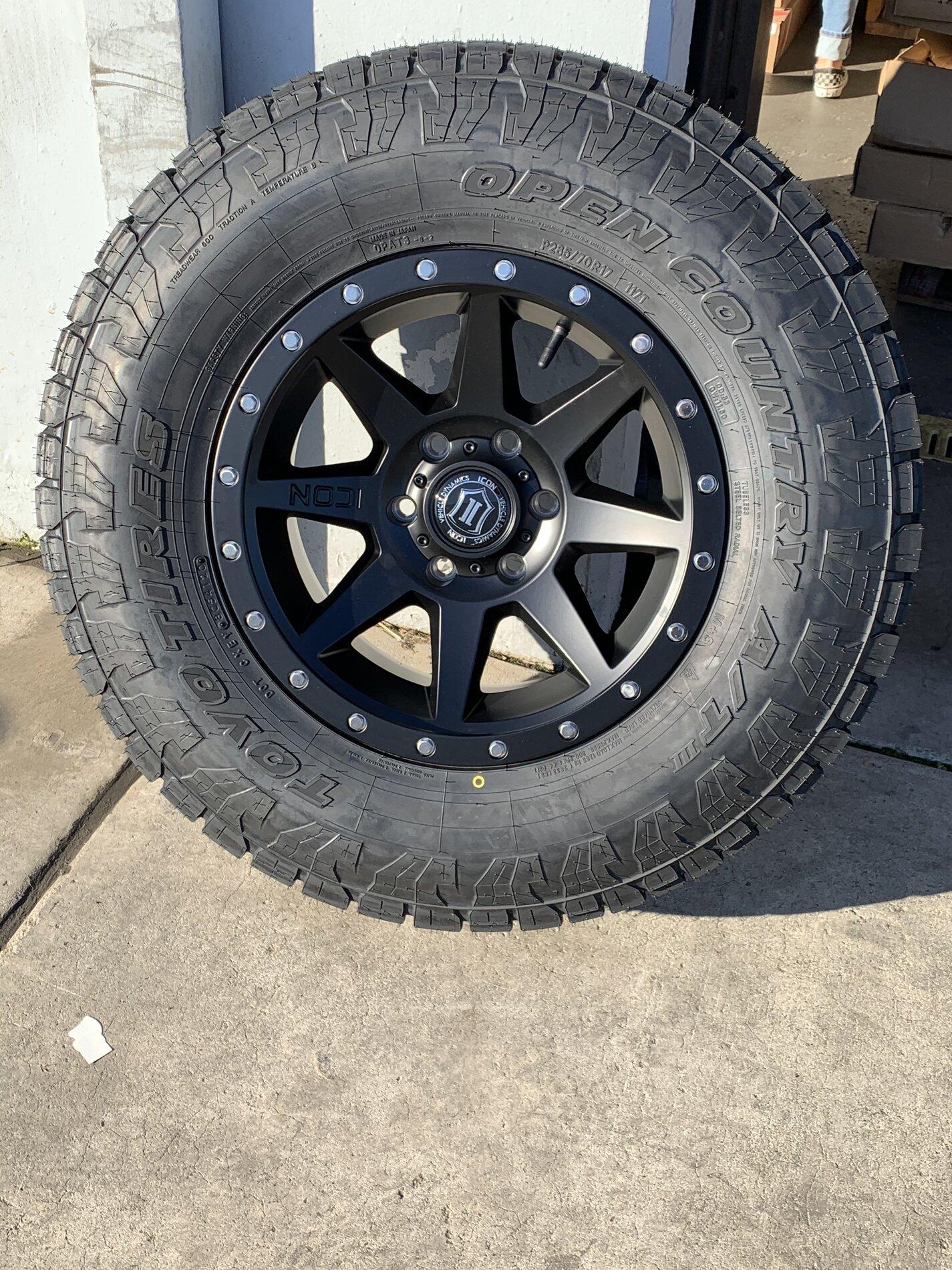

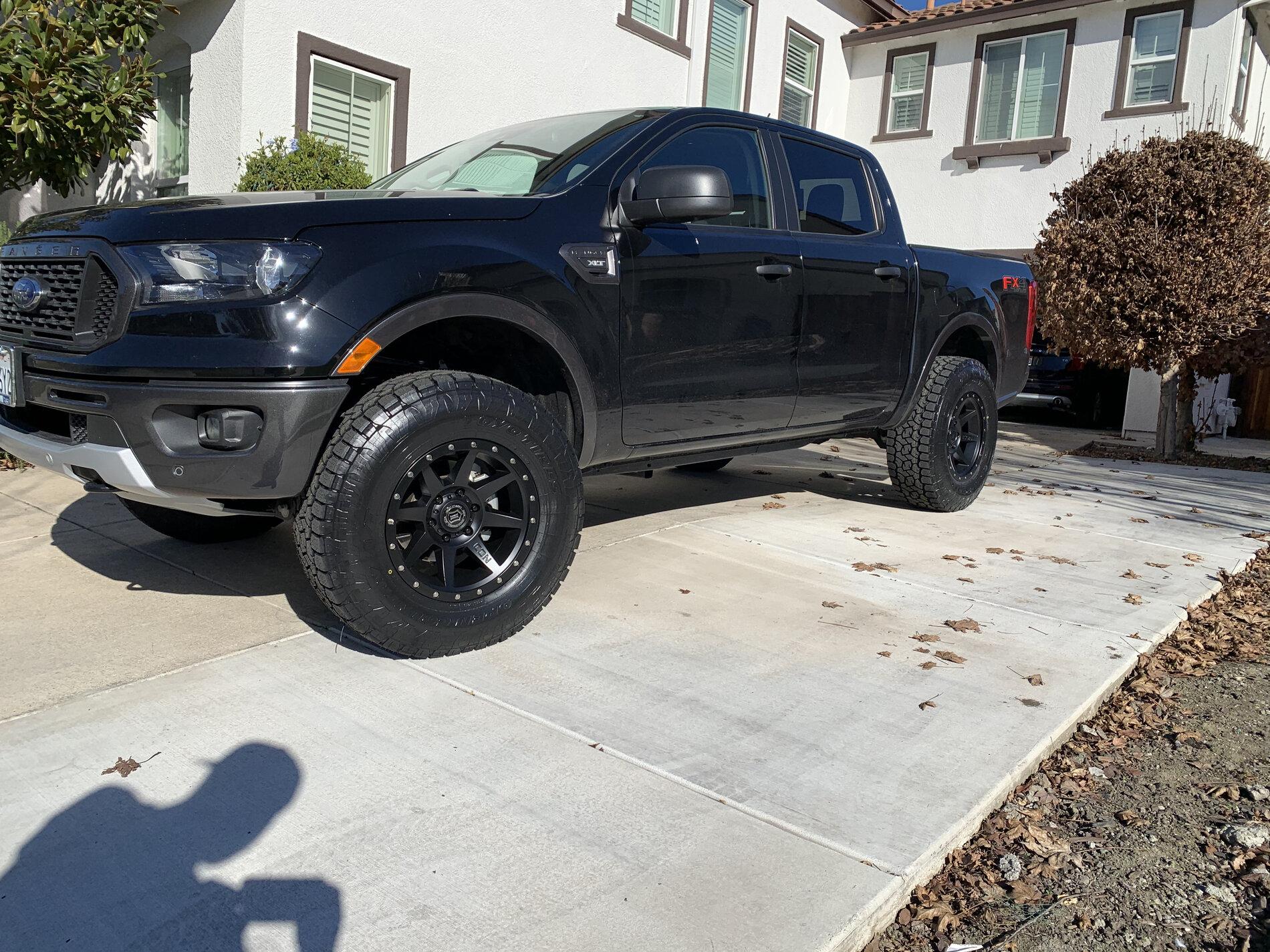

Ok here she is 2.5” level with bilstein fronts and rears with 285x70x17 on 17x8.5 icon rebound with 0 offset.
to get this setup to work you have to cut the crash bars out in the rear and you can remove or trim the front crash bars.
You also have to cut some of the wheel liner closest to the cab on both sides.
is there poke? Yes but it does not look like a roller skate like I’ve seen people say it looks perfect!!!!!! To me at least!!!

So I had to go back to America’s tires for a shake a still felt after the second balance. They found the issue and were extremely apologetic that they didn’t find it the second time. The Toyo was heavy on on side so they turned it 180! And boom problem solved the Toyos are very smooth now!
