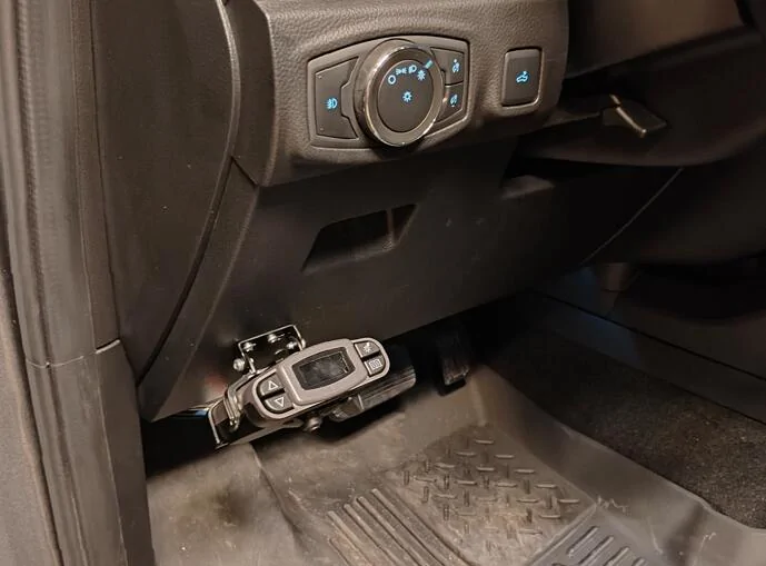

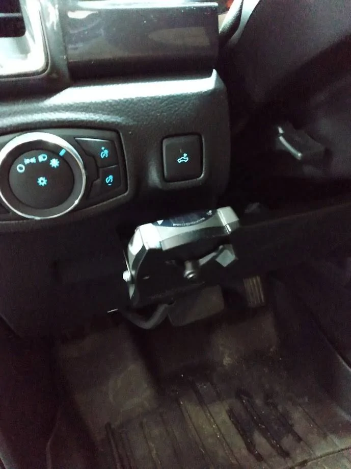

I mounted my P2 under the dash, left of steering column.
It's out of the way, and once you get your P3 dialed in you probably won't have to touch it again...
Aside from manually testing it when I first start out towing, I don't adjust it or touch it again.
