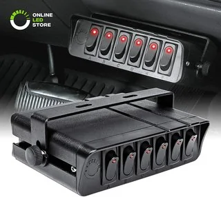

The following are wattage claims by the company, I suspect they are exaggerated for the price, but anyhow here is what I have so far...
120W 6" Pods (x2)
126W 20" Bar
Here is the 6 Gang 12V switch box I am looking at (for expansion for any future additions):
Now, I get it, now we toss in some wiring, some relays, and some fuses. My question is, should I go ahead and splurge on something like a water proof stand alone fuse box to put under the hood? Same for a multi-relay box? I can find plenty of how-to videos online, but sort of wanting some feedback on having all the components on hand that will be needed.
Edit: Correction, this particular product has a fuse system (40a per circuit board) - so I think all I have to do is add some relays?
