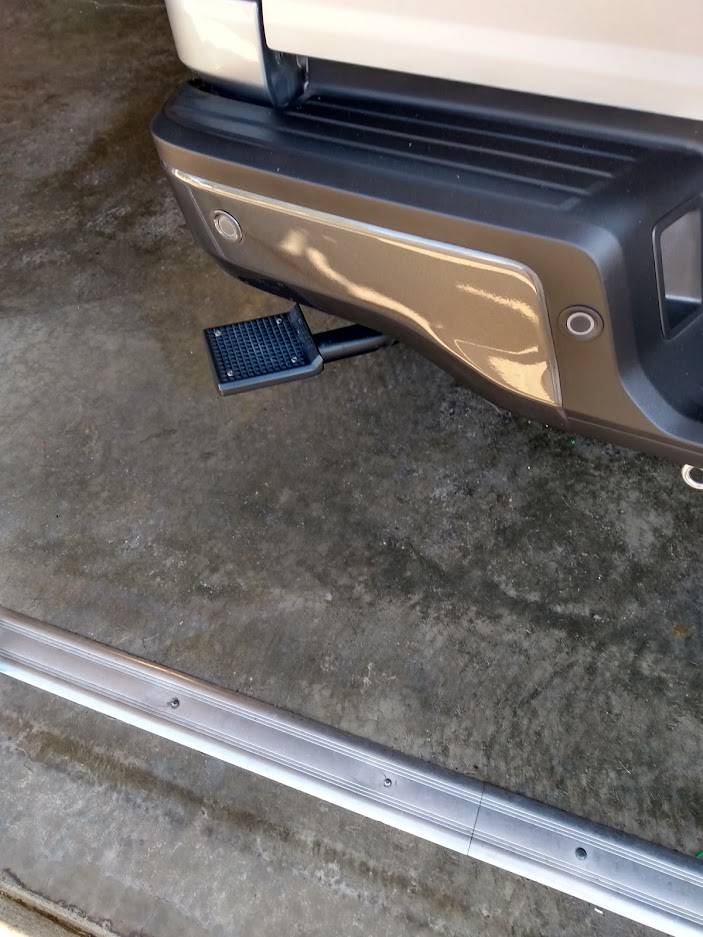

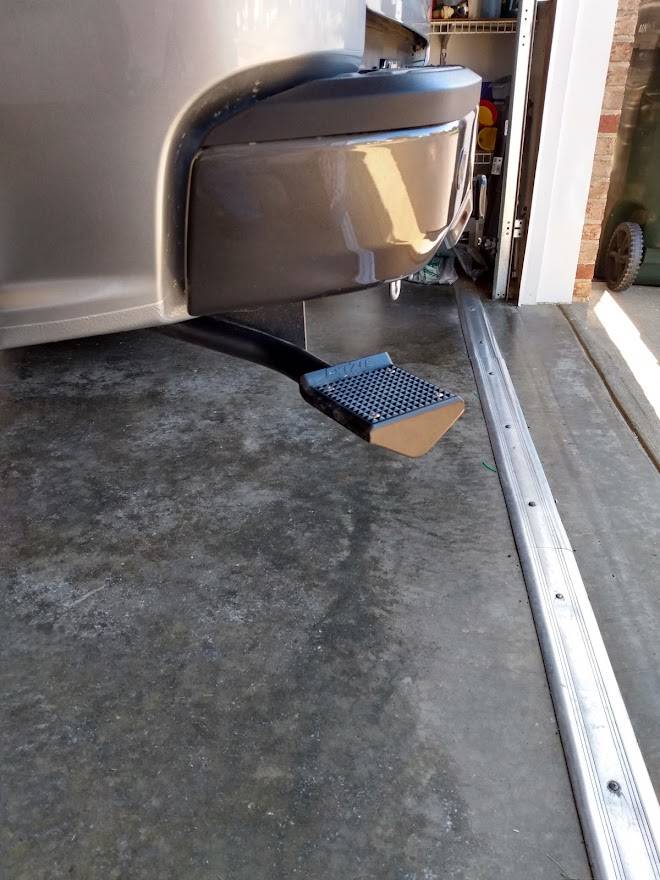

DeeZee makes a nice permanent mount step for the drivers side. Custom fit and uses 2 bolts from the bumper support. Nice quality, steel and aluminum. Bought mine a year ago and use it everytime I get into the bed. But price has gone up since I bought it...now around $90.00.
Are the two mounting holes pre-drilled in the bumper support?

I've had and been using the Dee Zee step now for a year and a half. It is very rugged, steel with an aluminum step plate. No, it dosen't fold...it's permanent, but does not "protrude" and I have yet to hit my legs on it.
Have used it hundreds of times now without a problem....rock solid/no flex.
Nothing against the Best Stop Step, but $90 vs $300.

Yes...the Dee Zee mounting plate, part of the entire steel support, has pre drilled holes that match up perfectly with two of the three bumper mount supports. Simple matter of unbolting 2 of the bolts, aligning the Dee Zee Step, and run the bolts back up into frame. Takes all of 10 minutes to install.

1. Does this step work when the tailgate is both open and closed?
2. What size socket do the bolts take? Regular or deep socket?
3. Any issues installing on a truck with a Ford factory installed receiver hitch?

Yes, works with tailgate up or down.
Don't need a deep socket, standard will do with an extension, either 21 mm or 13/16 will work, but your going to need a proper 1/2 inch drive, preferably an impact rated socket...those bolts are TIGHT. I have a 1/2 inch Kobalt impact driver, so it was easy for me. If you don't have one, a good breaker bar will do it.
Mine is installed with the factory hitch.
If you look at the bumper mount/hitch mount, you'll see 3 bolts holding the mount to the frame. Only the two rear bolts come out, step goes in place and re-bolt. The nuts are captive/welded to the frame, so only the bolts come out. When the 2 bolts come out, nothing falls or moves out of place...the third bolt that you don't take out holds everything tight.
Really, with my impact wrench it took me less than 10 minutes to install....
