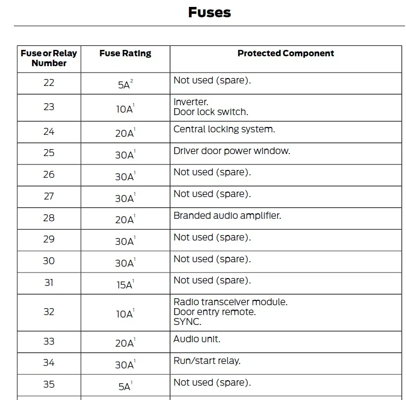

From the owner's manual:
Fuse 31 is not used according to the owner's manual. Fuse 32 is for RTM and Sync (APIM).

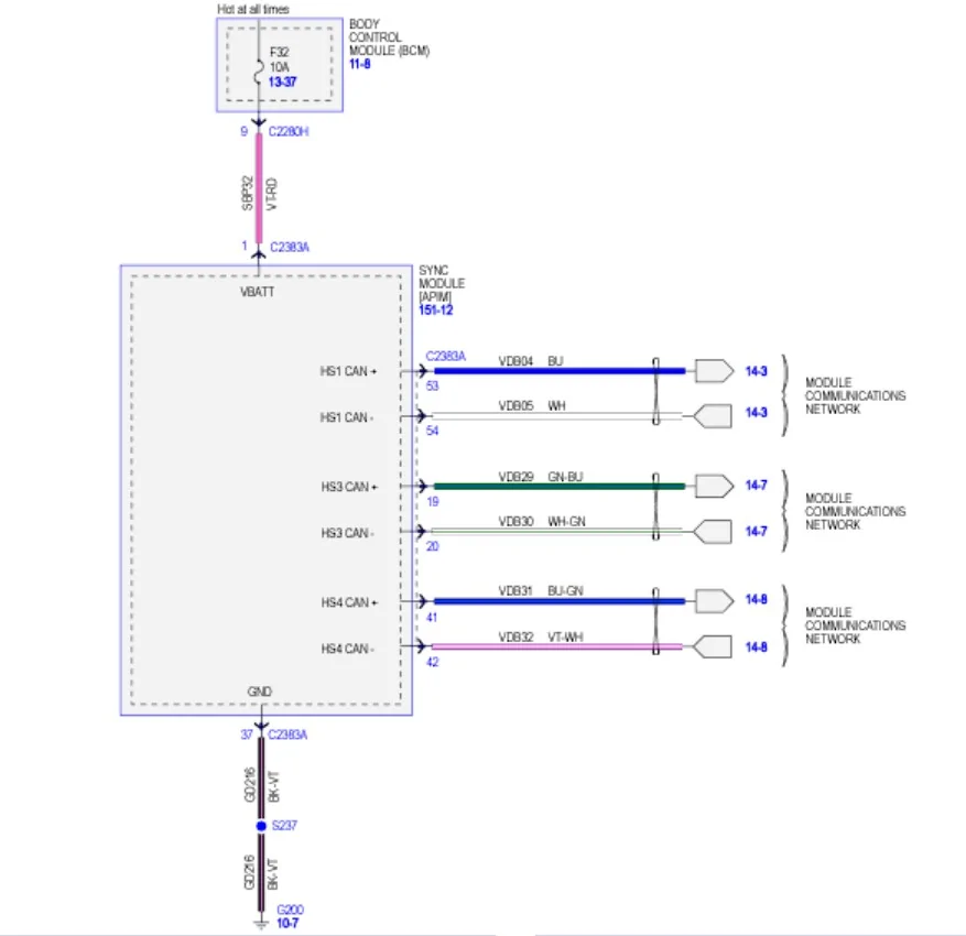

Power distribution:

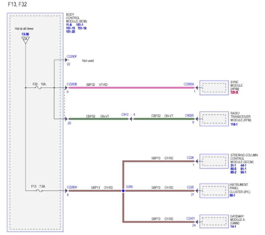

Ref: Diagrams

IDK why they have the circuit wired differently (diagrams) or even in your owner's manual.
II suggest checking your BCM fuse box to verify which is correct.
If you are correct, then we have (FOUND) a wire change, that has not been noticed or documented before - and with all the (posts) for the Sync Reset (Pull Fuse) nobody has brought it up that Fuse 31 was empty or no reaction (power-off) of the APIM.
Something is (OFF) here and I suspect it's the information you have (both your wiring diagram & owner's manual ref)
The only way to know for sure is a physical check of your BCM-Fuse Box and see what fuses 31 & 32 are actually powering.
Fuse 31 will drop power from the APIM
Fuse 32 will drop power from the RTM, and you will have lost remote FOB functions

All I can say is that the shop manual (2019 Helm) and the owner's manual for the 2019, show fuse F32 as feeding the Sync (APIM) module and the RTM.
