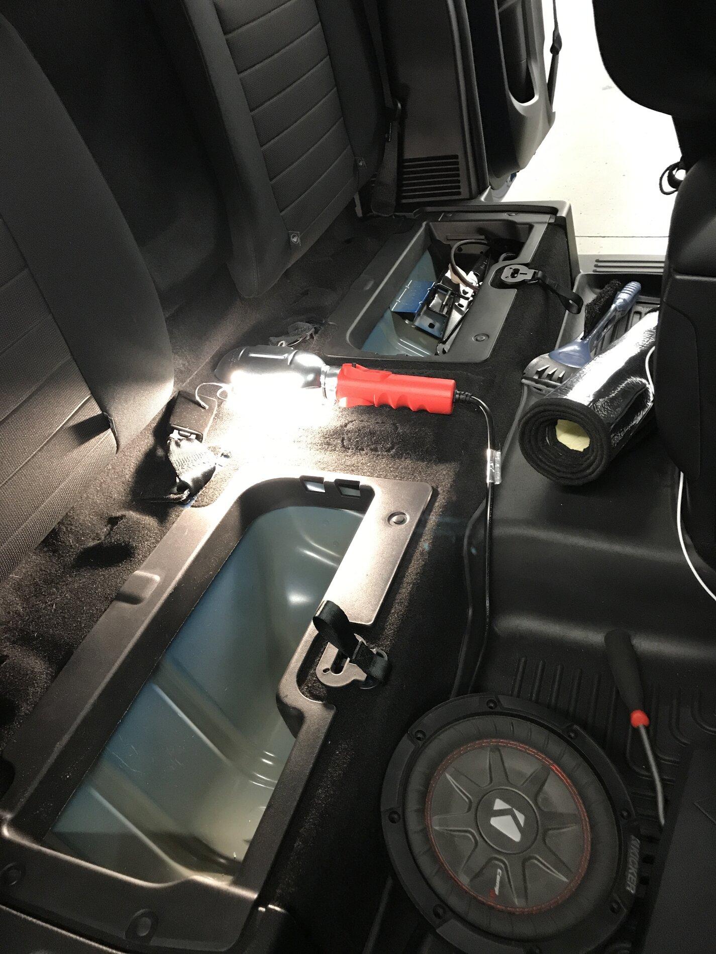

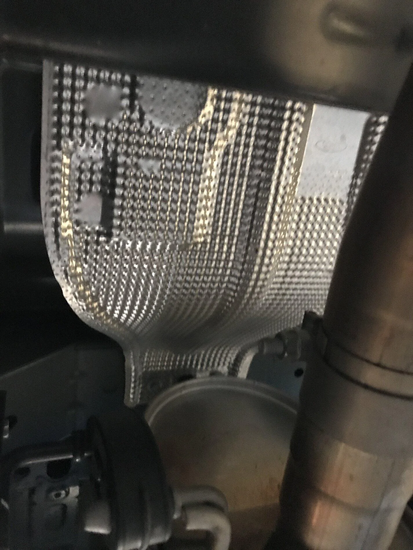

Started inspecting & testing for amp installation last weekend. As much as I’d love to use the unused 20A fuses in the Body Control Module, I really don’t want to brick a BCM if the amp starts heating things up. Still gonna use them
, but will run power wire from the engine compartment. Luckily only 8 gauge is needed, so passing thru should be easy.

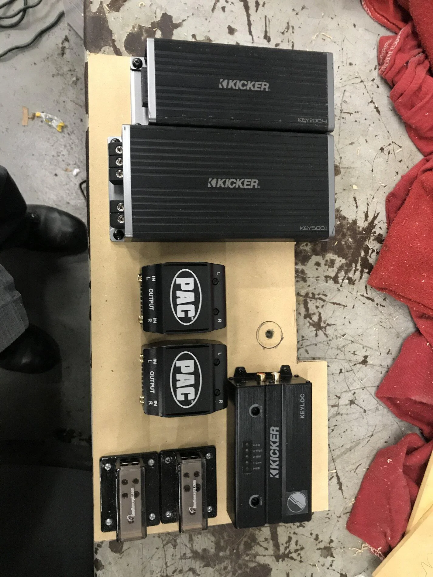

Made an amp mounting platform from a scrap piece of 1/4 inch mdf. Will probably make another as more room is needed for the sub amp in the future.

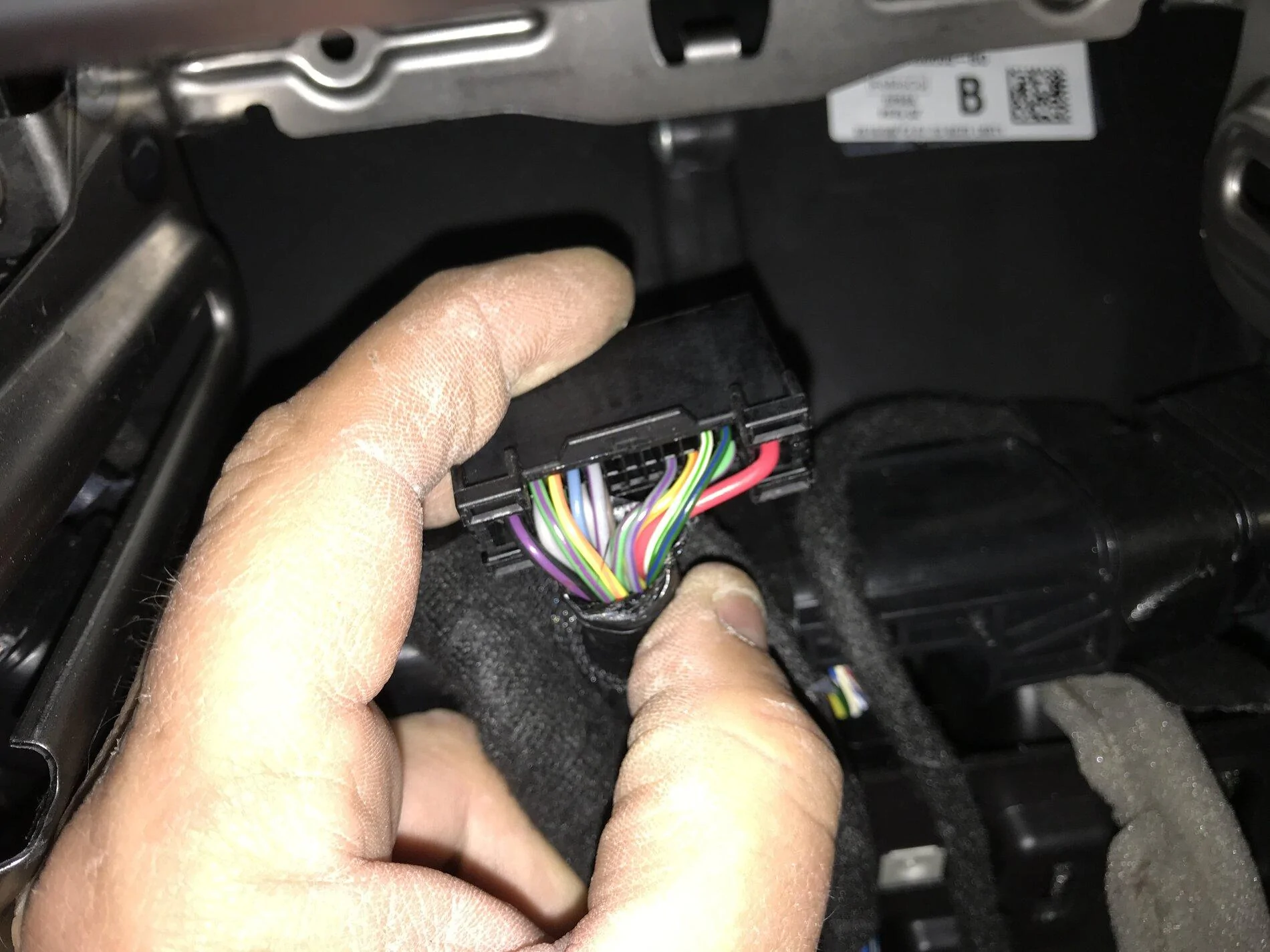

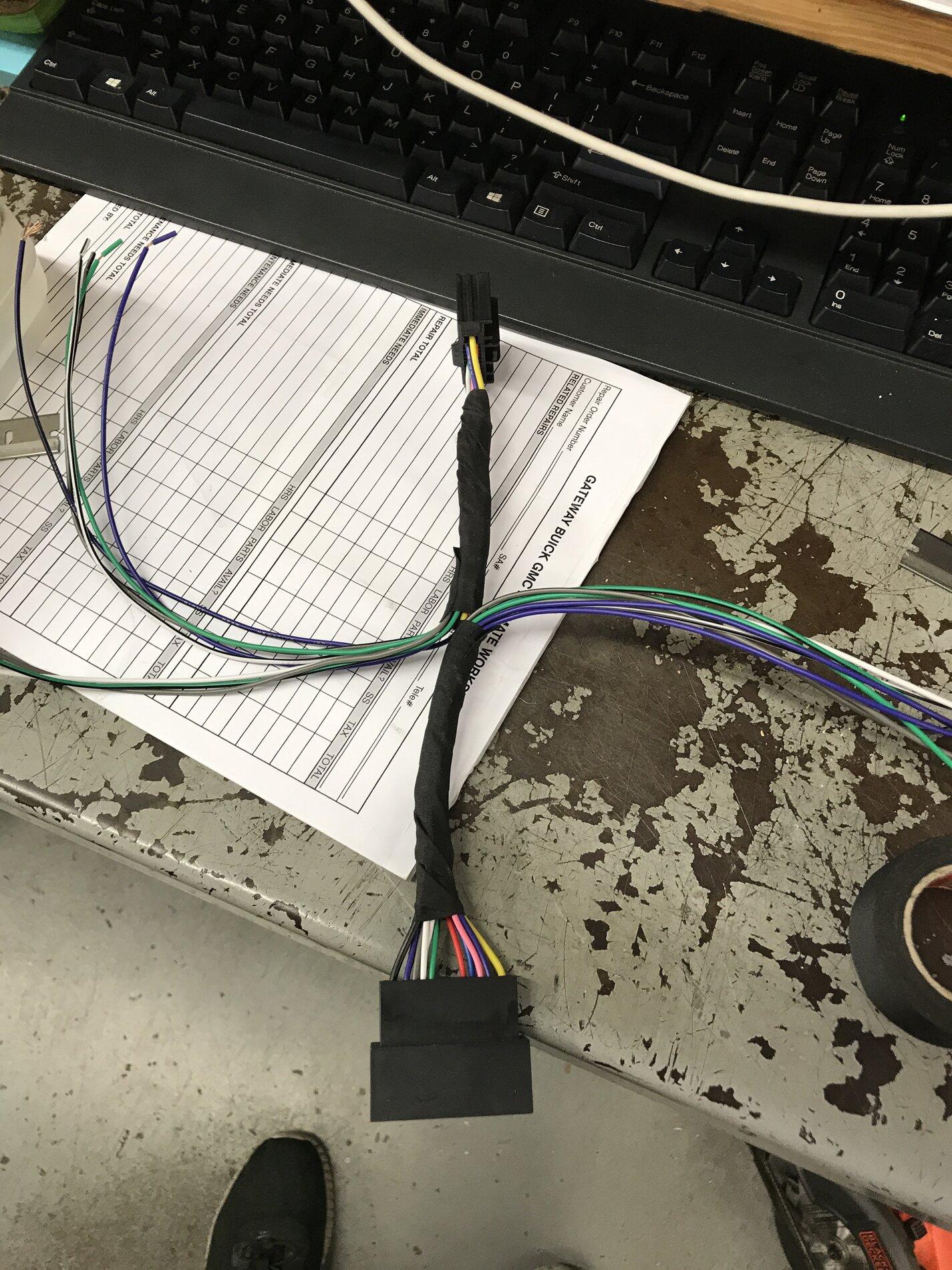

Pulled the radio to compare the radio connection with the t-harness & removed unnecessary wires. Still debating on whether to install connectors on the 9-wire to the t-harness as space is very limited in this dash & connectors cost more than I wanna spend, but are very convenient if stuff needs removing.
I have 2 Kicker low profile 150-300w RMS 8-inch subs gathering dust, so I did some inspection of the right rear hidey hole to see if installing one 8-inch sub is possible. Might not go in the way one would expect, but I’m betting I can get one in there, so I took some rough measurements for the future.

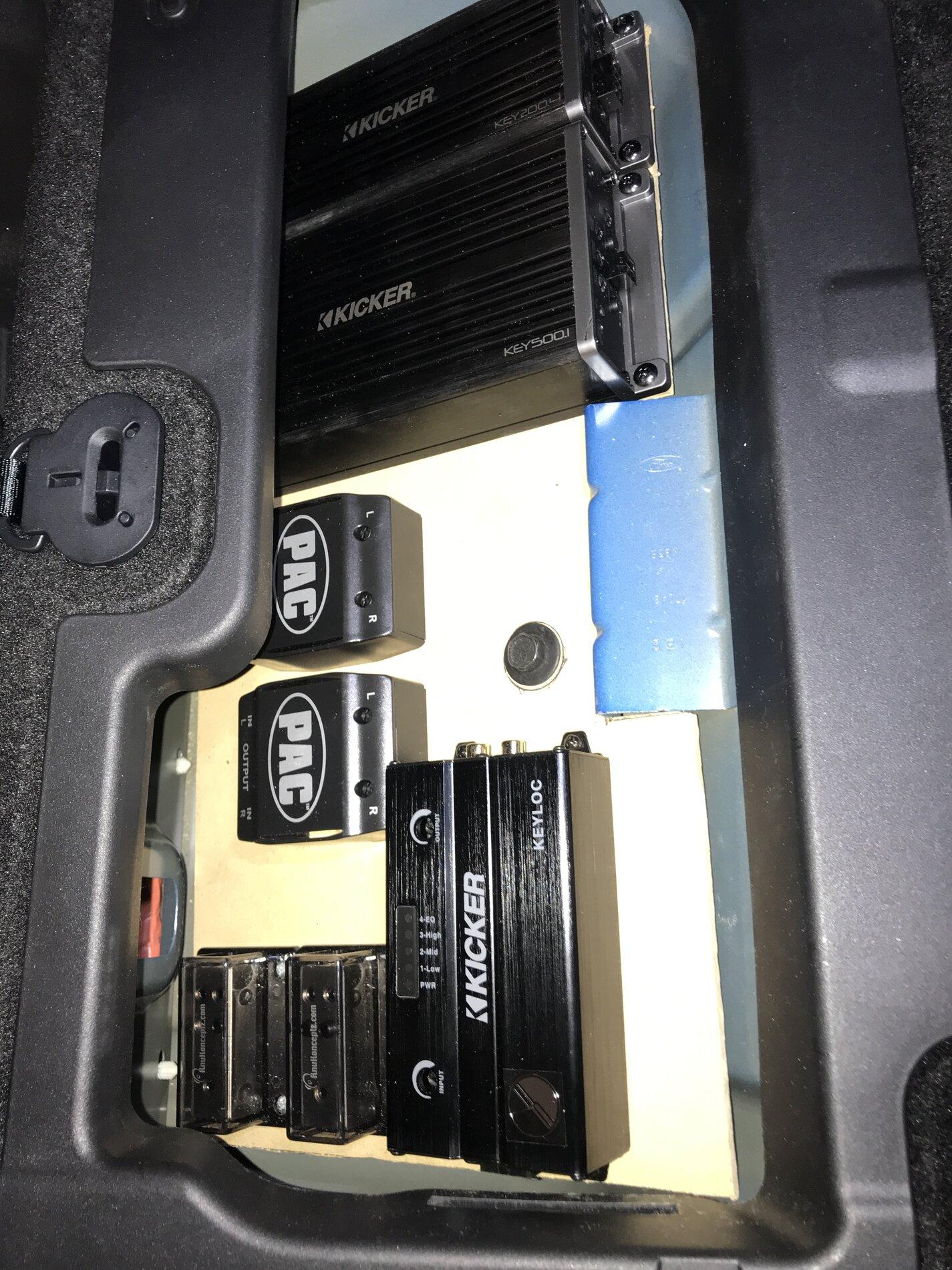

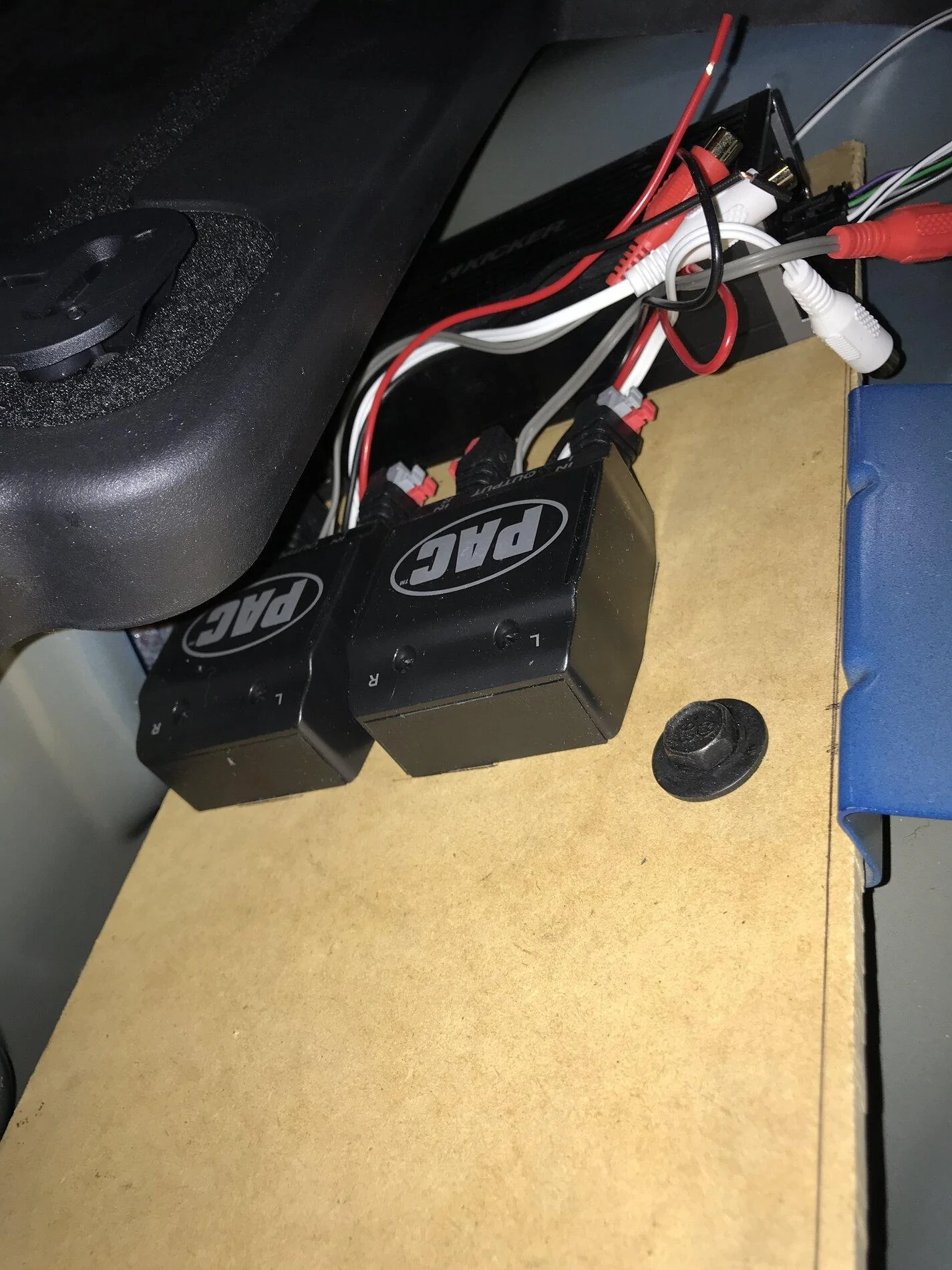

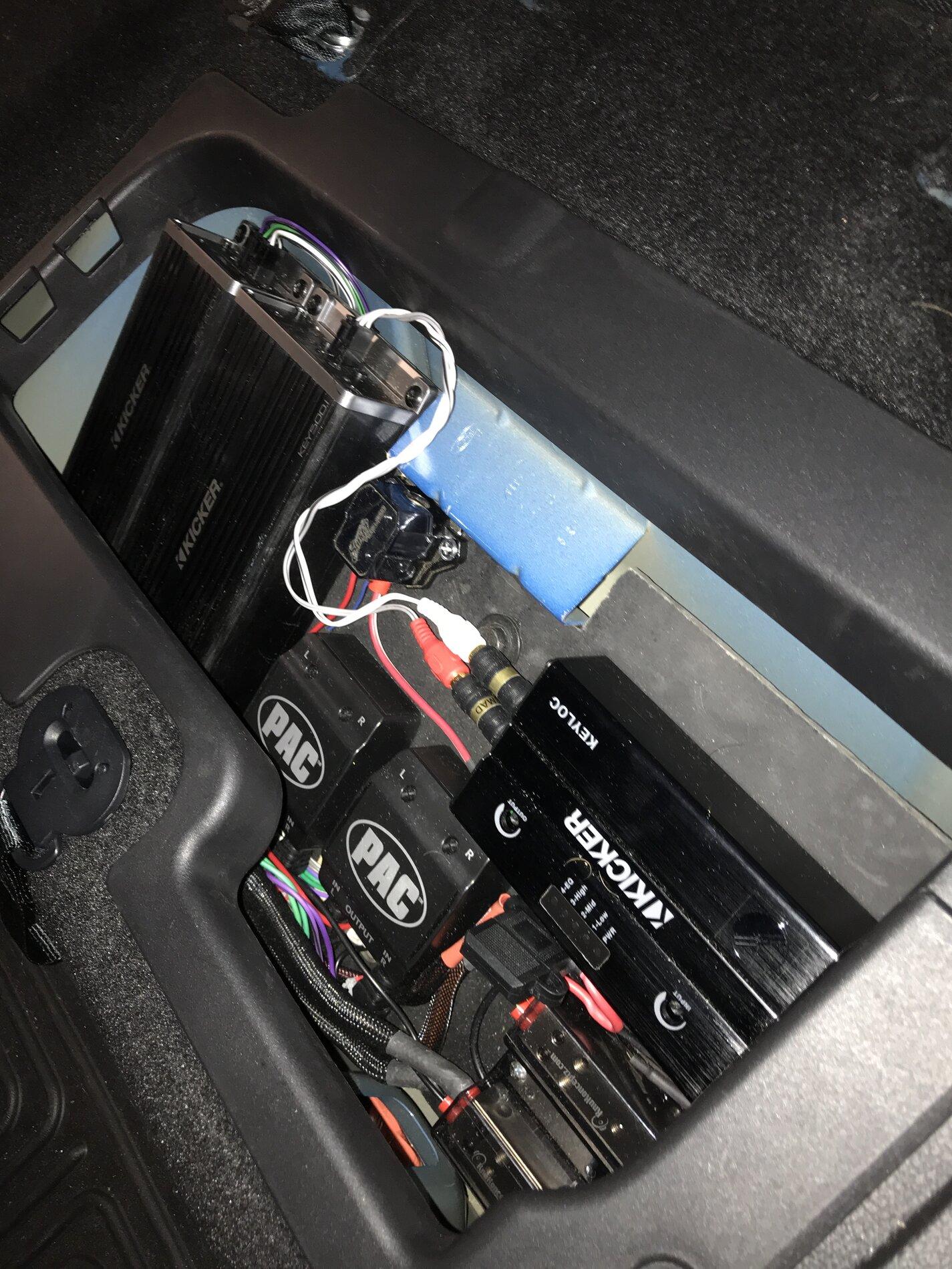

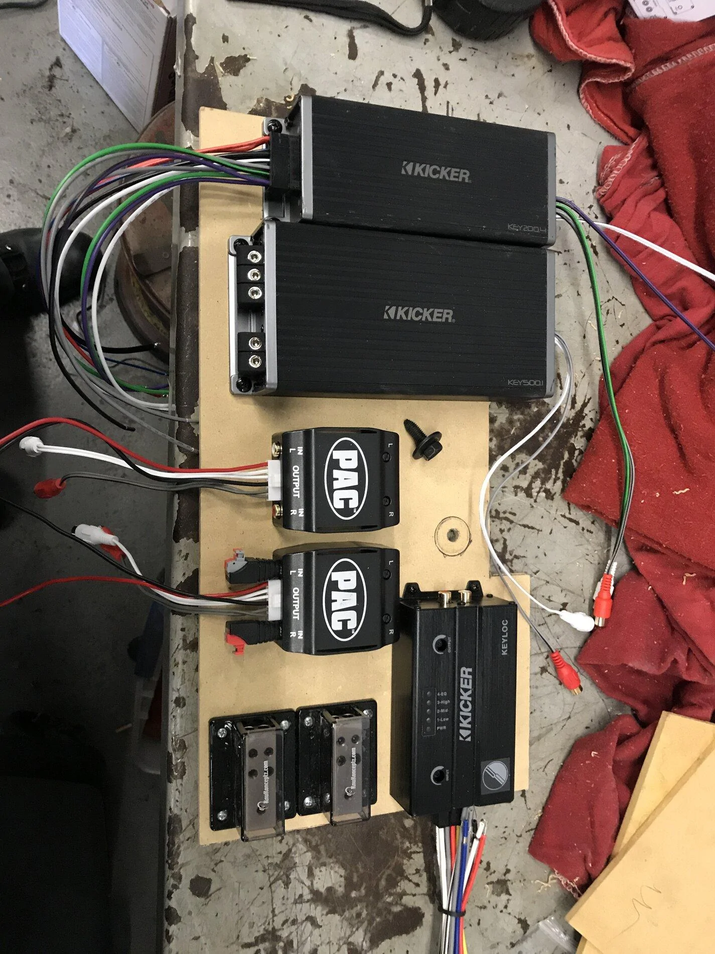

A bunch of parts showed up, along with a slow day at work, so got a little accomplished today.

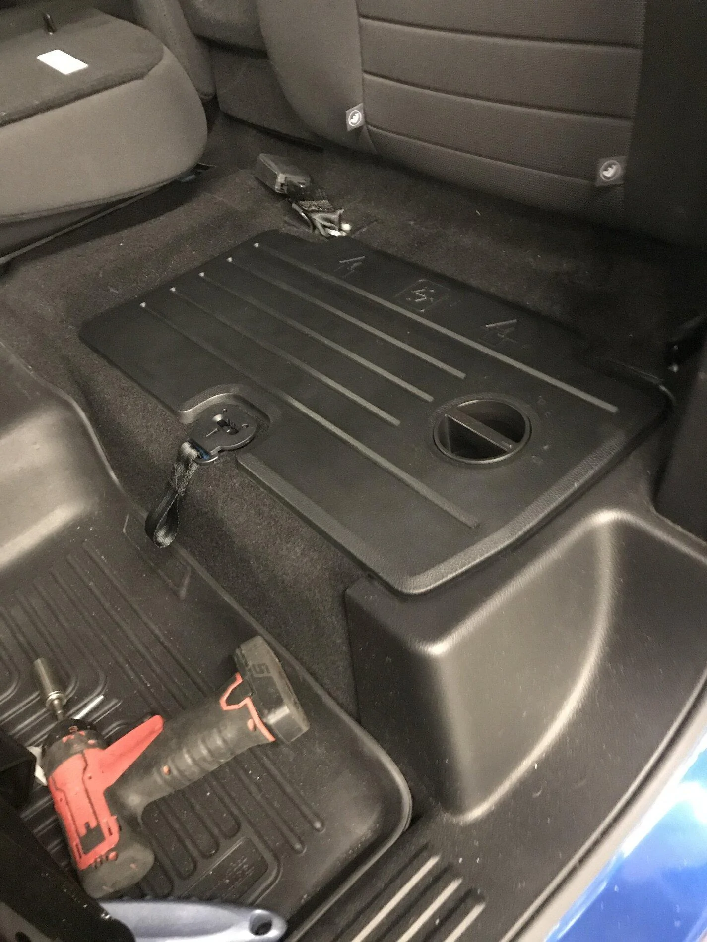

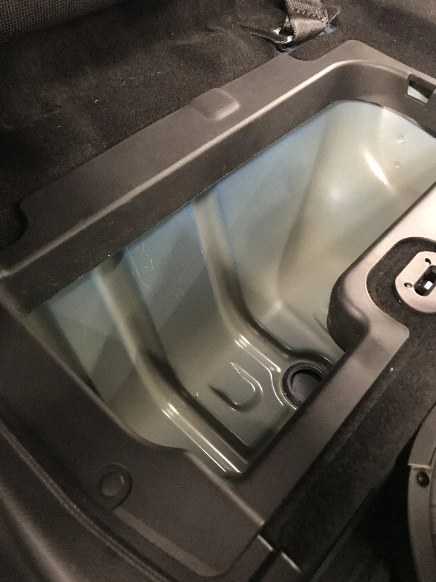

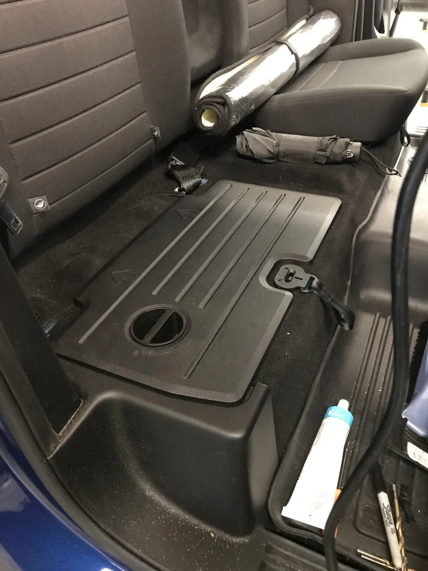

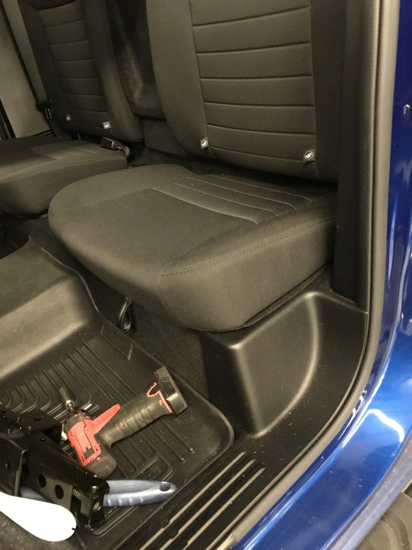

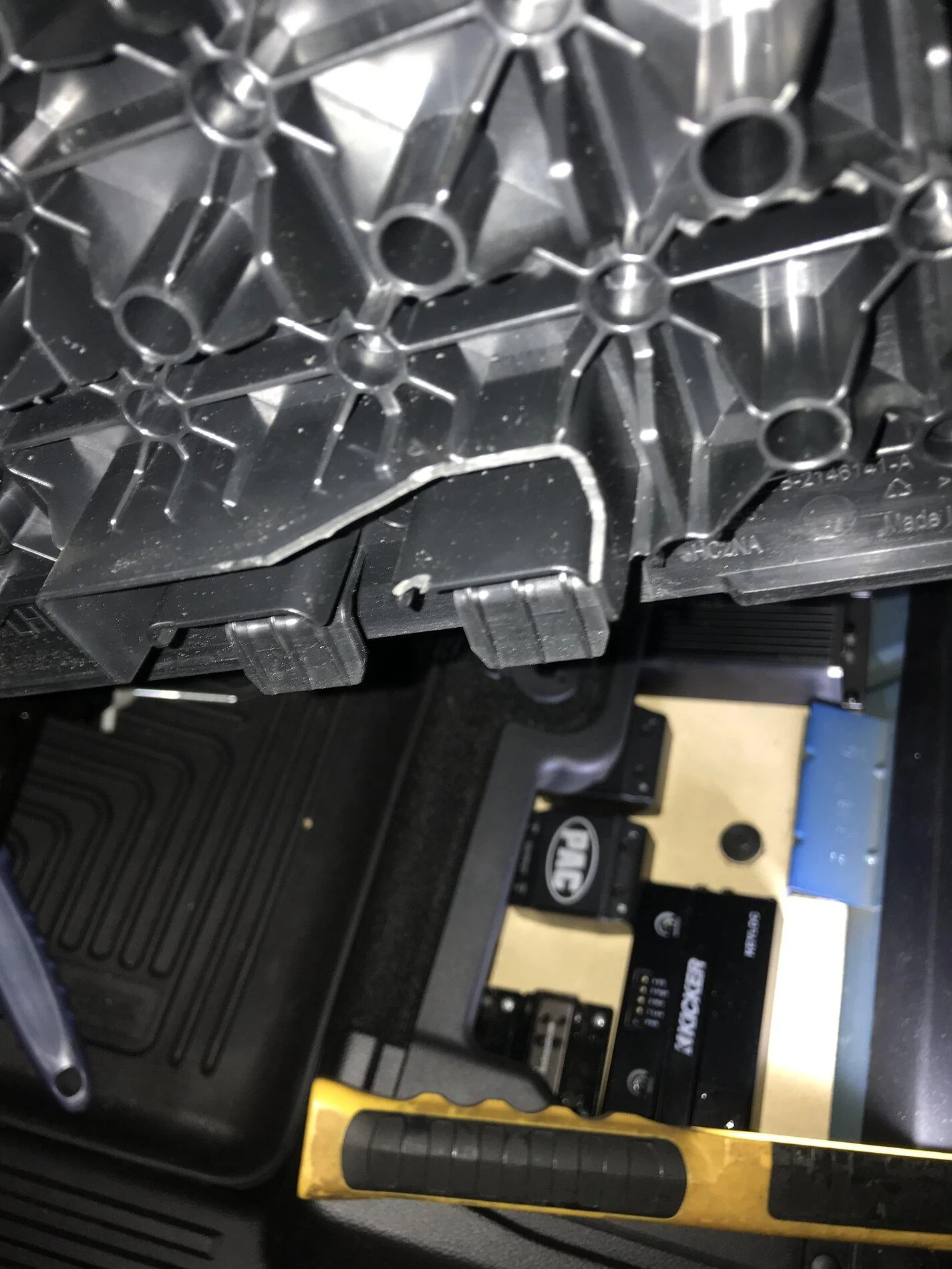

Didn't have the room I was wanting (not like I have much choice in this vehicle), so I reassessed & made another mounting board for the amps, boosters, distro blocks, & LOC. Amazing how much 1 1/4 inch makes (TWSS).

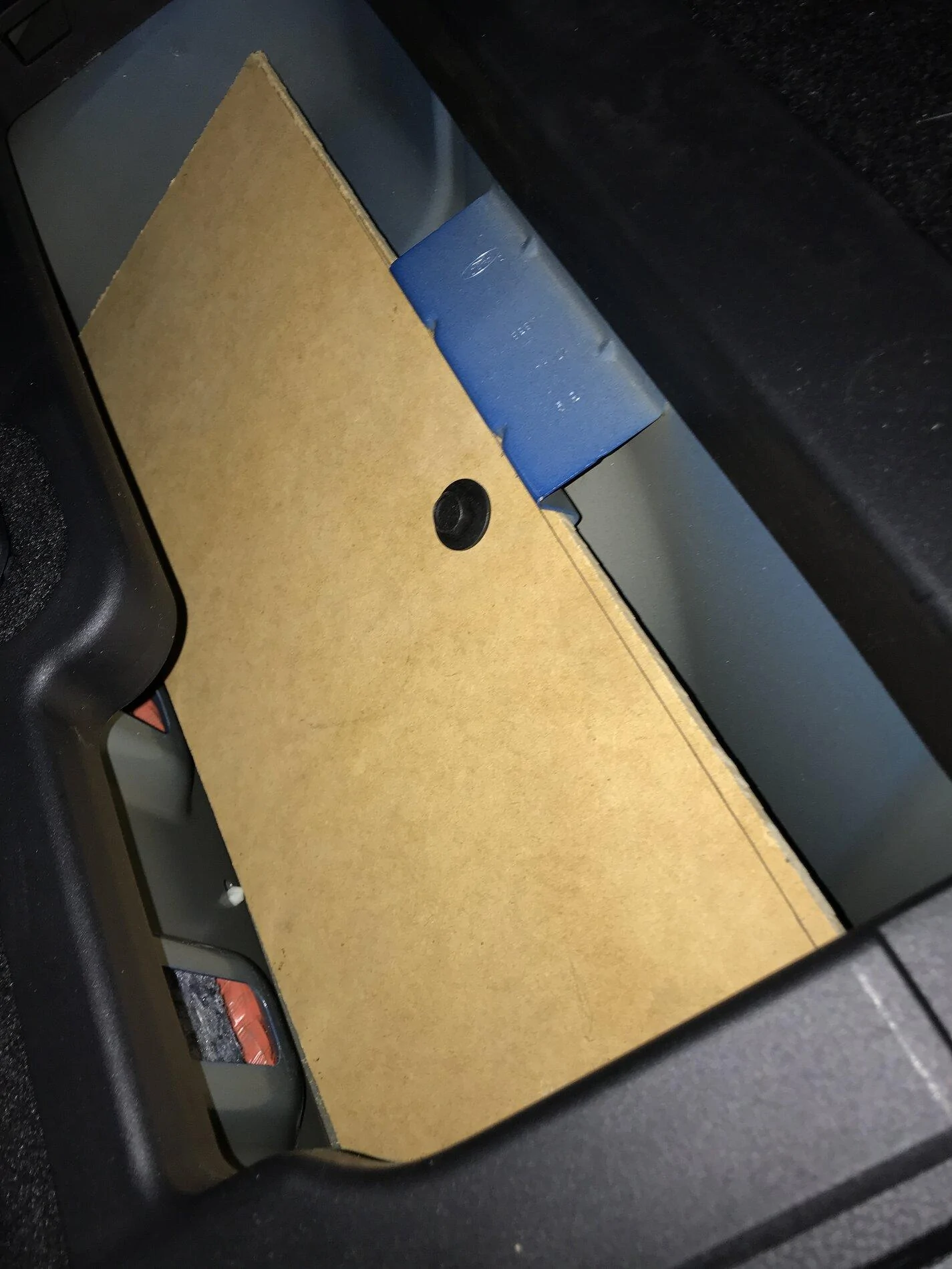

Like a glove! Plan is to also put some fairly stiff packing foam I have from headliner shipping containers underneath this to keep it from rattling around. I did have to make a slight modification to the hidey hole lid as it was hitting the 4 channel amp, but very minimal. The lid latch does hit the LOC, but it doesn't mar it, may have to put some felt tape on the lid in that area to keep rattles down. So far, fully assembled you can't tell anything's under there, but I will eventually have to buy one of those swing out boxes for jack storage.
Power wire will route through here, with some vacuum line around the perimeter of the hole, & covered with Noico mat to keep the sharp edge at bay. From there it'll head up the driver side through the bulkhead into the engine compartment. If I have any that'll fit I'll probably install a rivnut & make a ground point nearby here for everything rather than look for an existing one. More on that soon.
I also have to make this look somewhat prettier. Once again...more on that later.

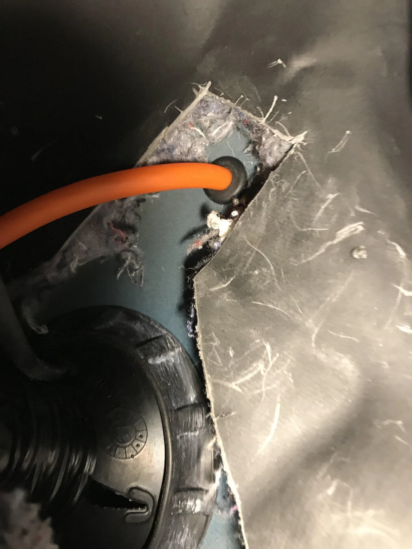

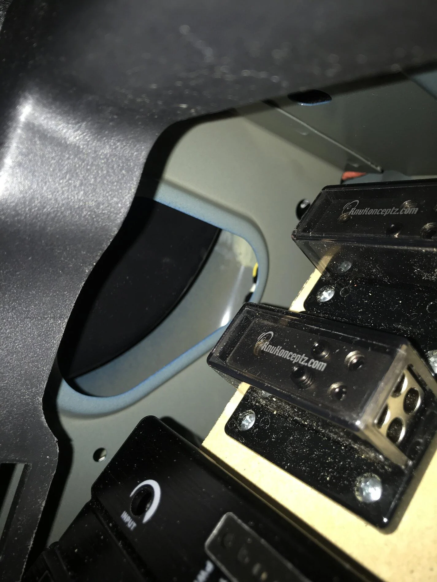

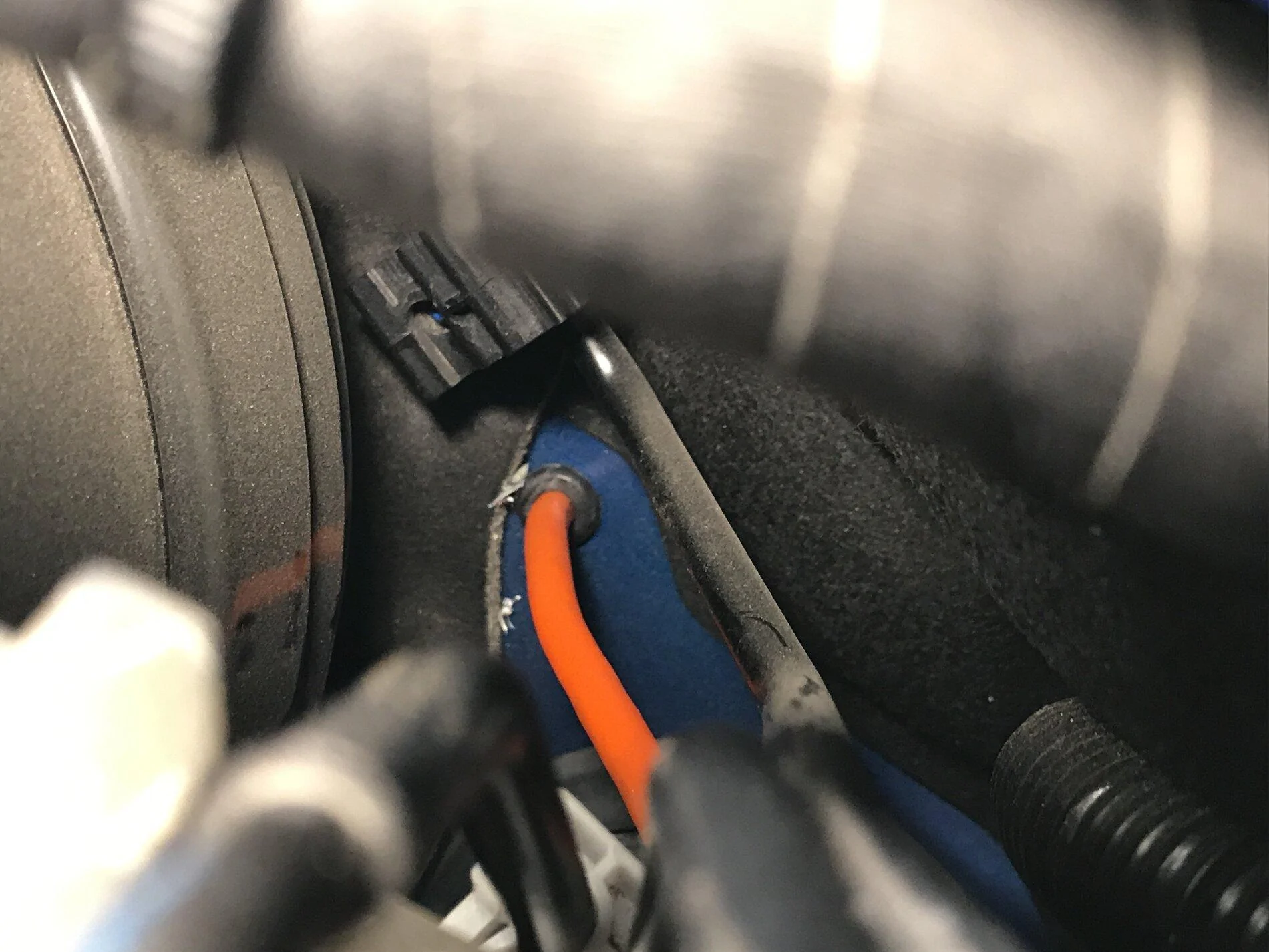

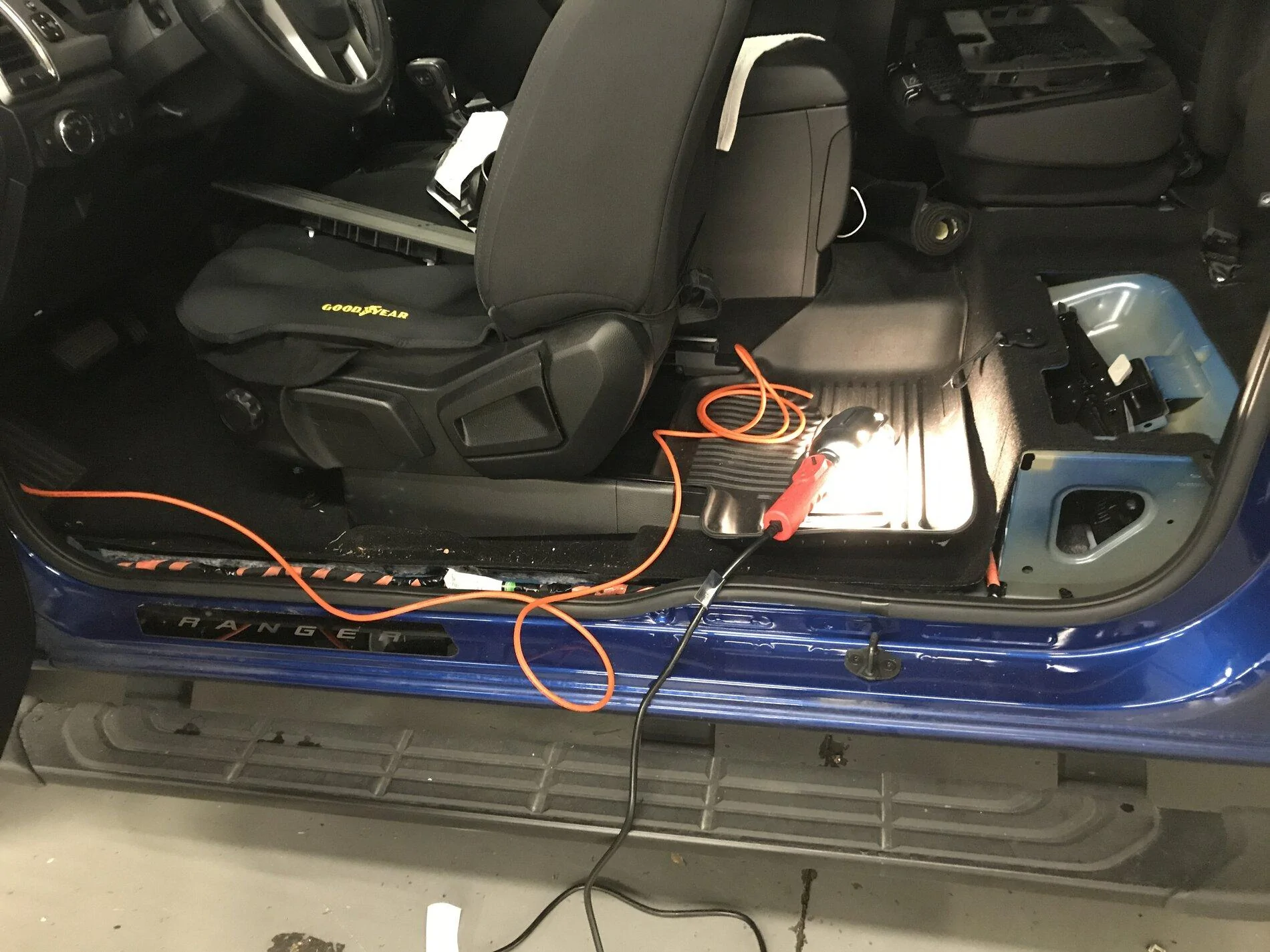

Weekend off, so I wasted Saturday at work working on the Supercab.

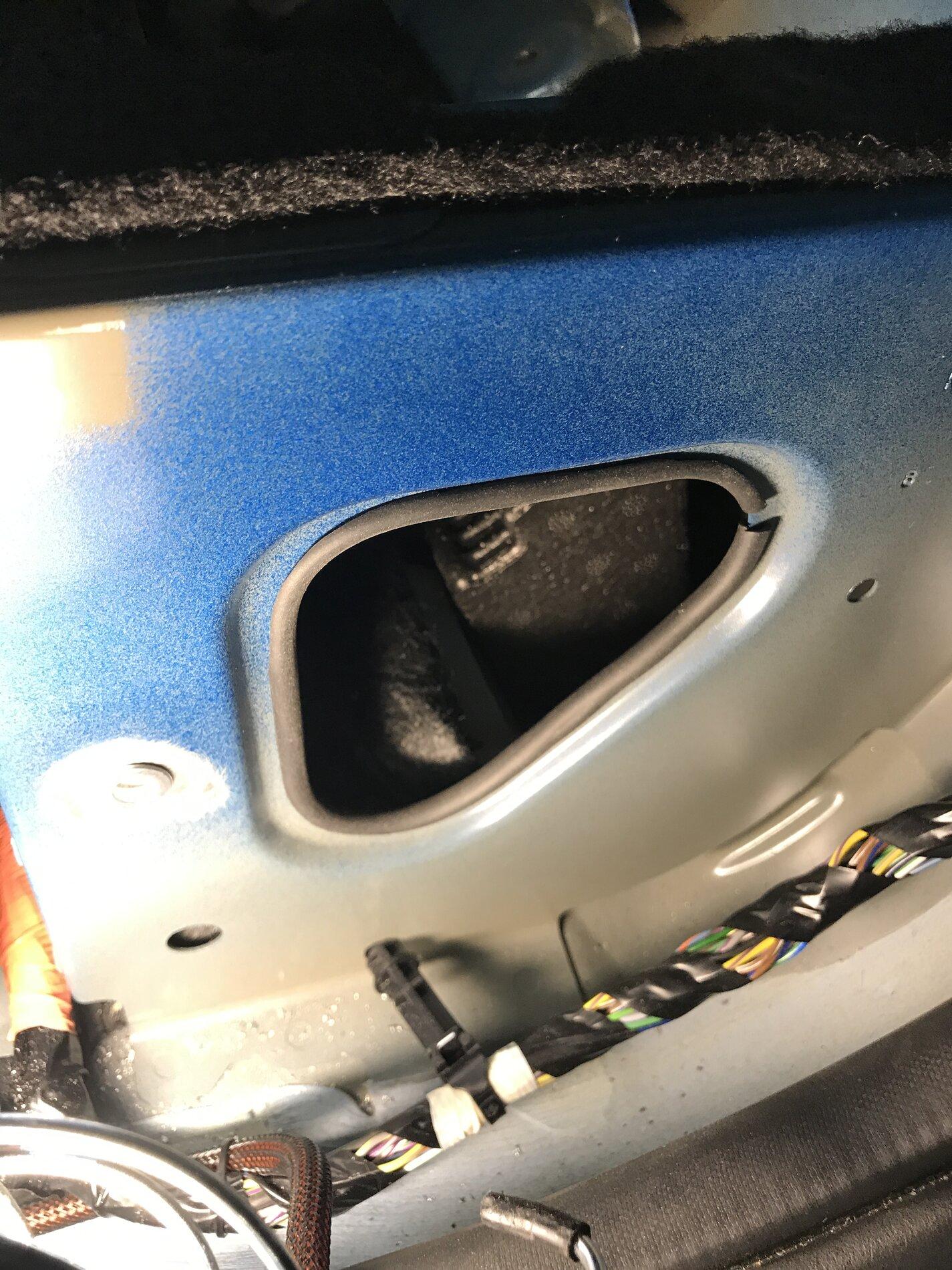

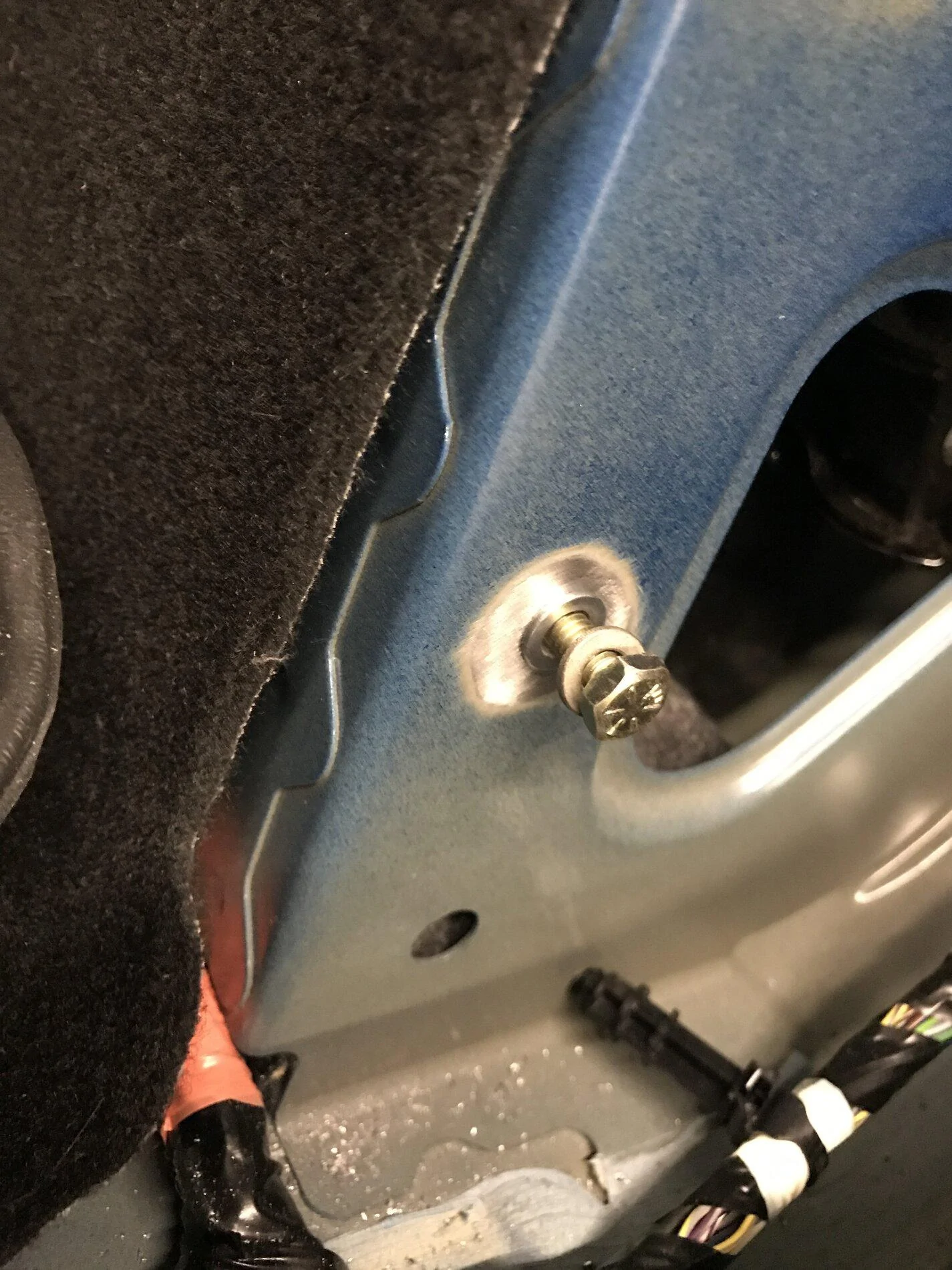

Got the amp power & ground wiring ran through the bulkhead via a 3/8 inch hole about 1 1/2 inches northeast of the main engine harness pass-thru with a pass-thru grommet of it's own. I did cover it with braided sleeve tubing & secured with zip ties for protection & I must stress if you attempt this routing, do not let the wire rub against anything on the brake system - brake lines or the EBCM. I've seen a certain electronic retailer radio install nightmare on a brand new Cavalier that required a complete brake system replacement (power wire shorted to brake lines), so better safe than sorry, not accepting responsibility if it happens to you.
From the engine compartment side:
Routing was pretty straightforward, alongside the body harness to the rear seats. Thankfully, the trim panels can be removed from the bottom up, so no need to remove the complete LR cab quarter trim.
The seat looks like it was spot welded to the floor, so looks good enough of a spot for a ground. If not, I'll find somewhere else. I still have some rivnuts left.
Split a small piece of vacuum line to cover the sharp edge of the seat opening, then covered with Noico mat:
All done here for the moment.

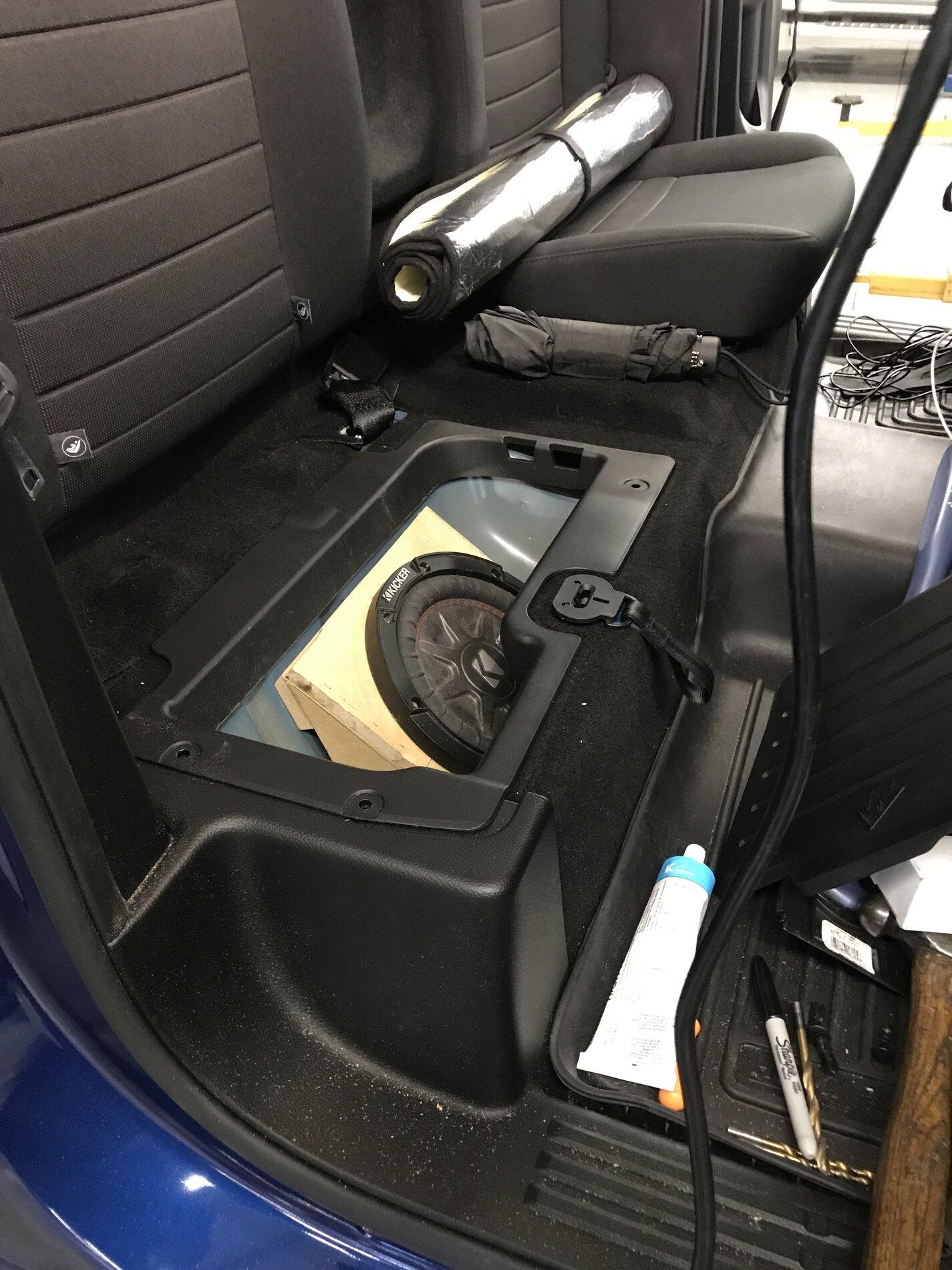

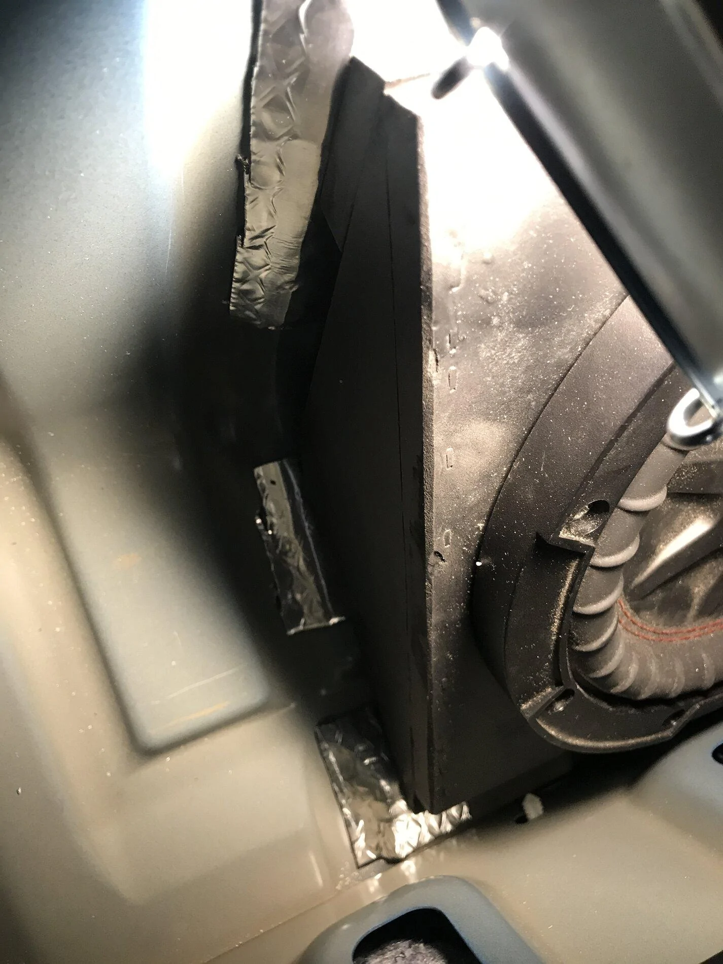

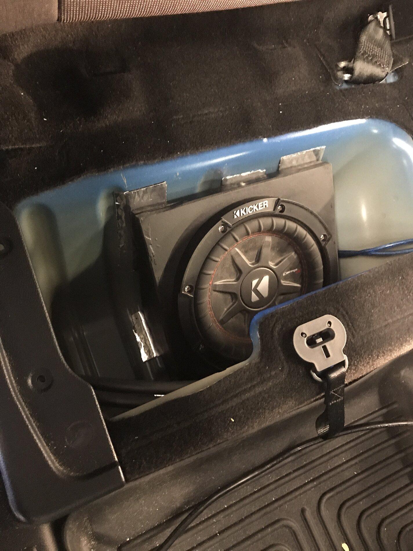

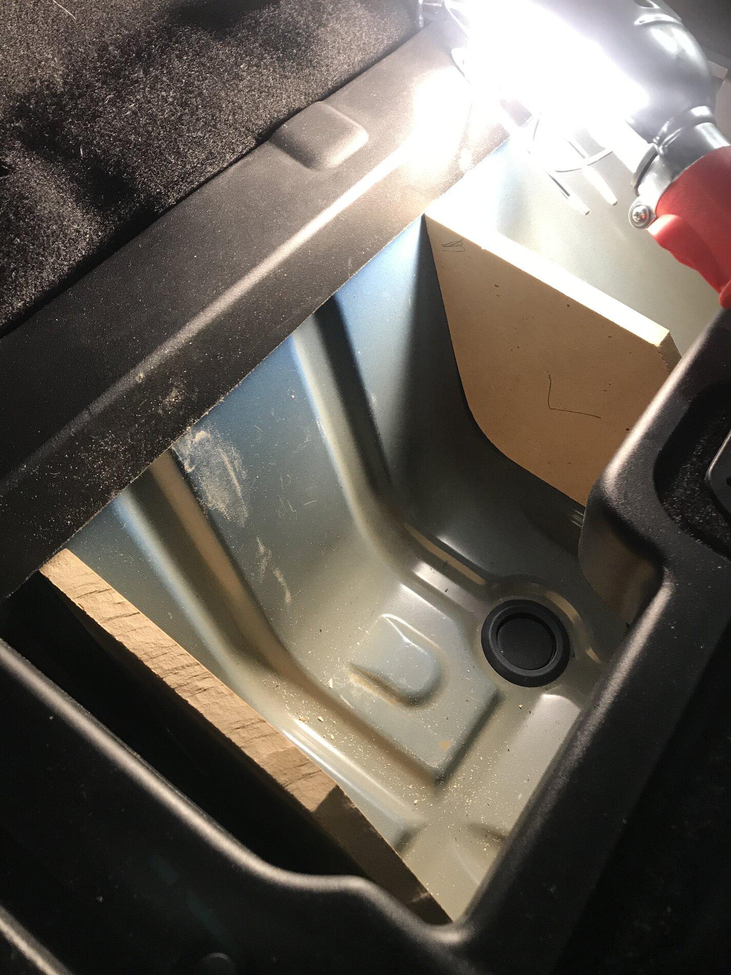

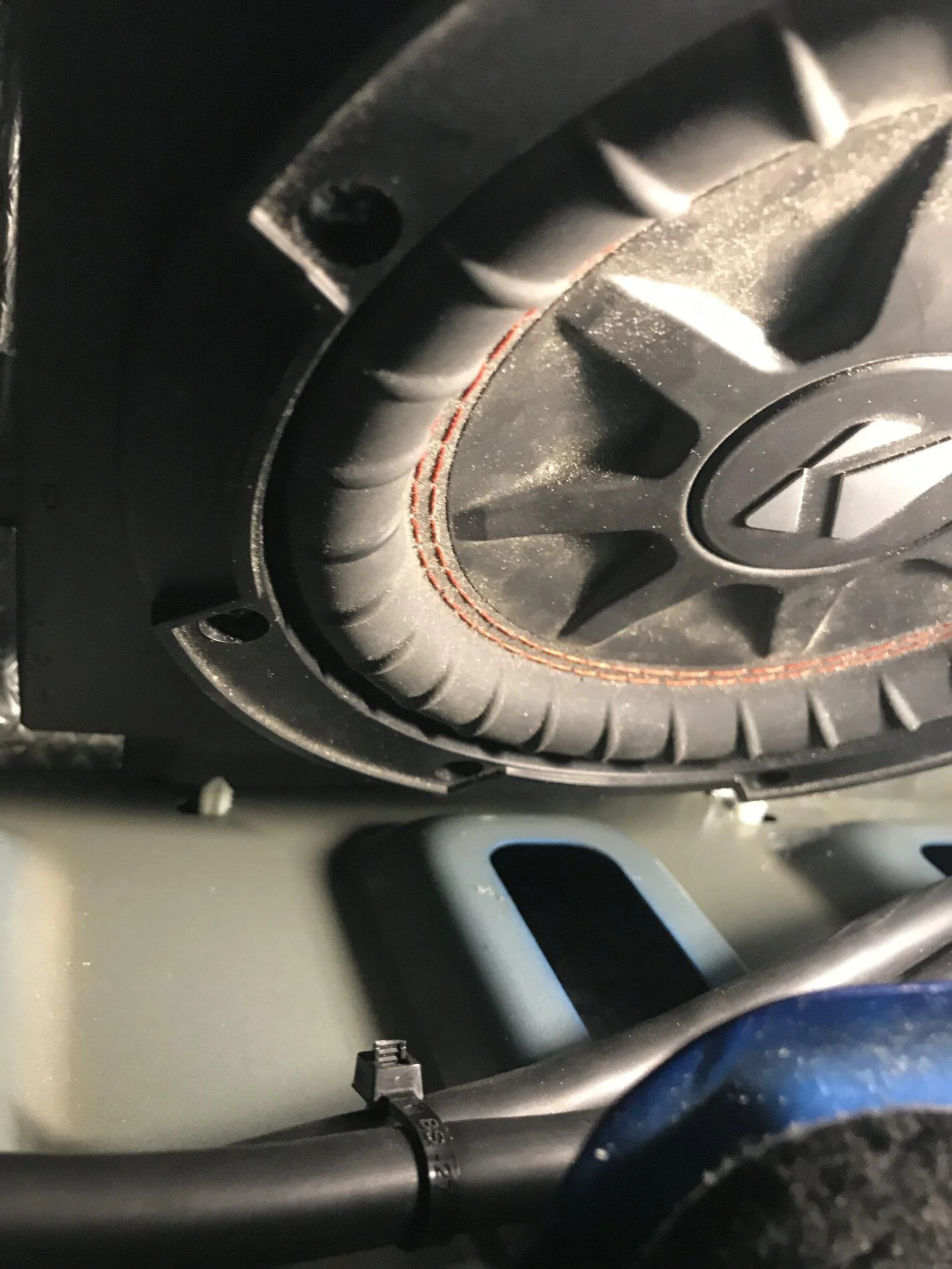

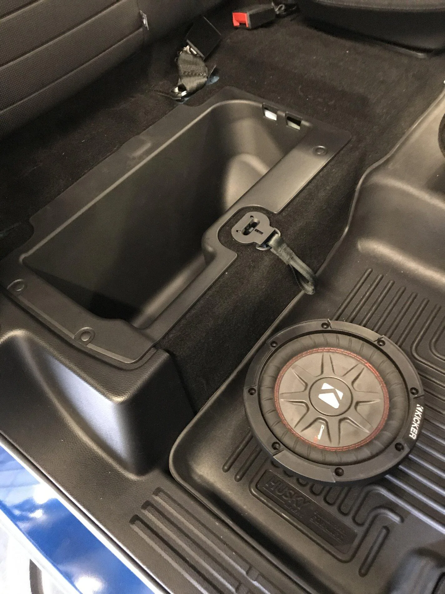

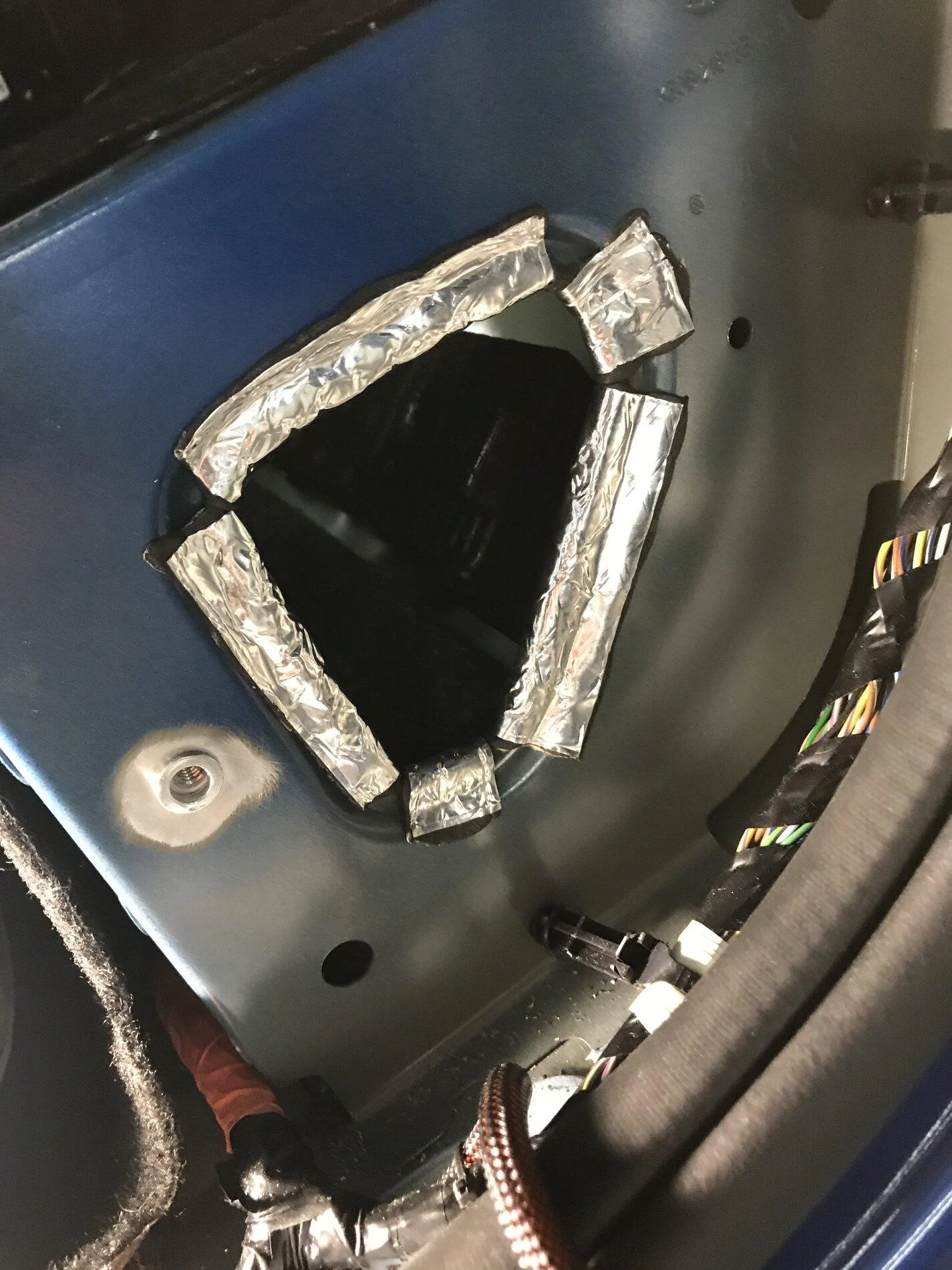

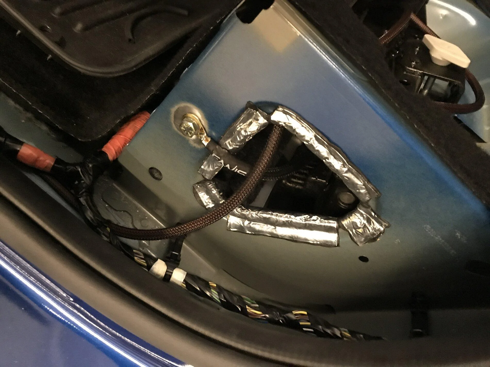

Time to get creative...

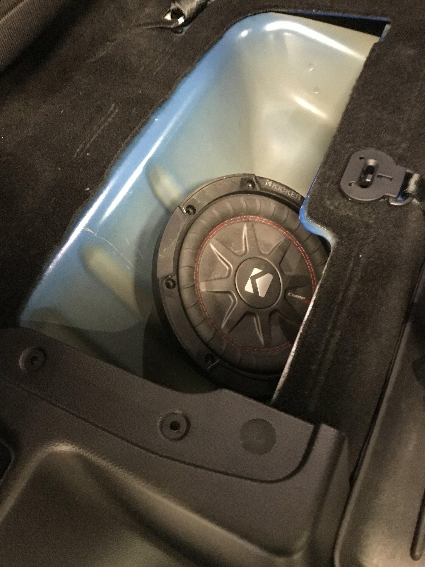

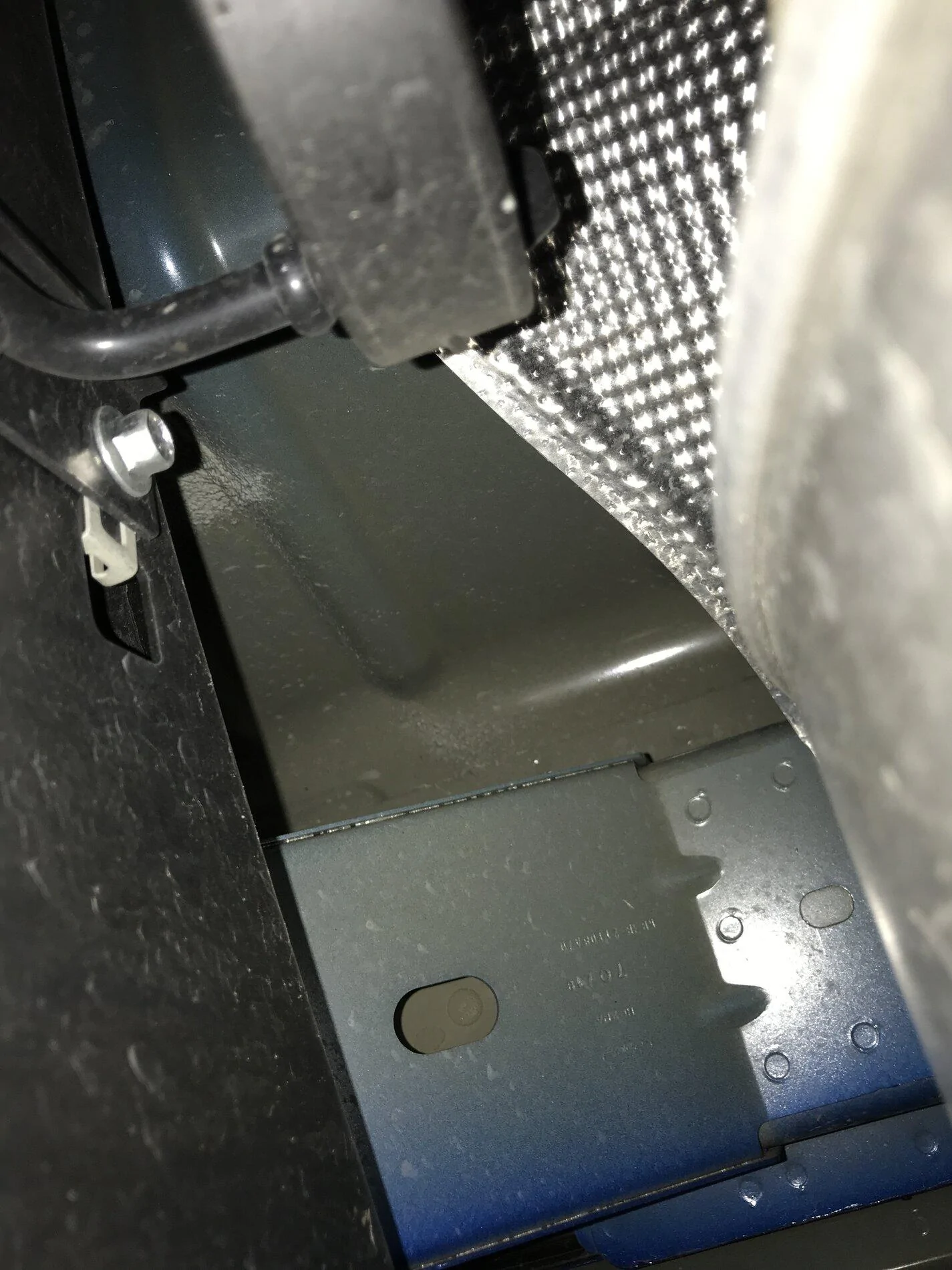

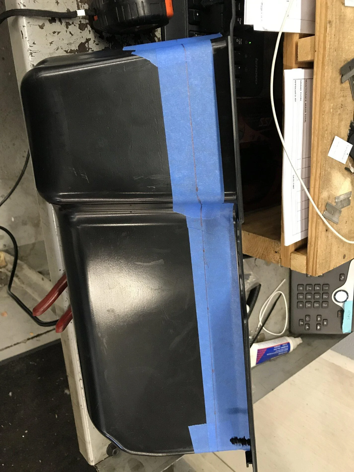

Nothing under the hidey hole on this side, so a bracket bolted to the body will work here.

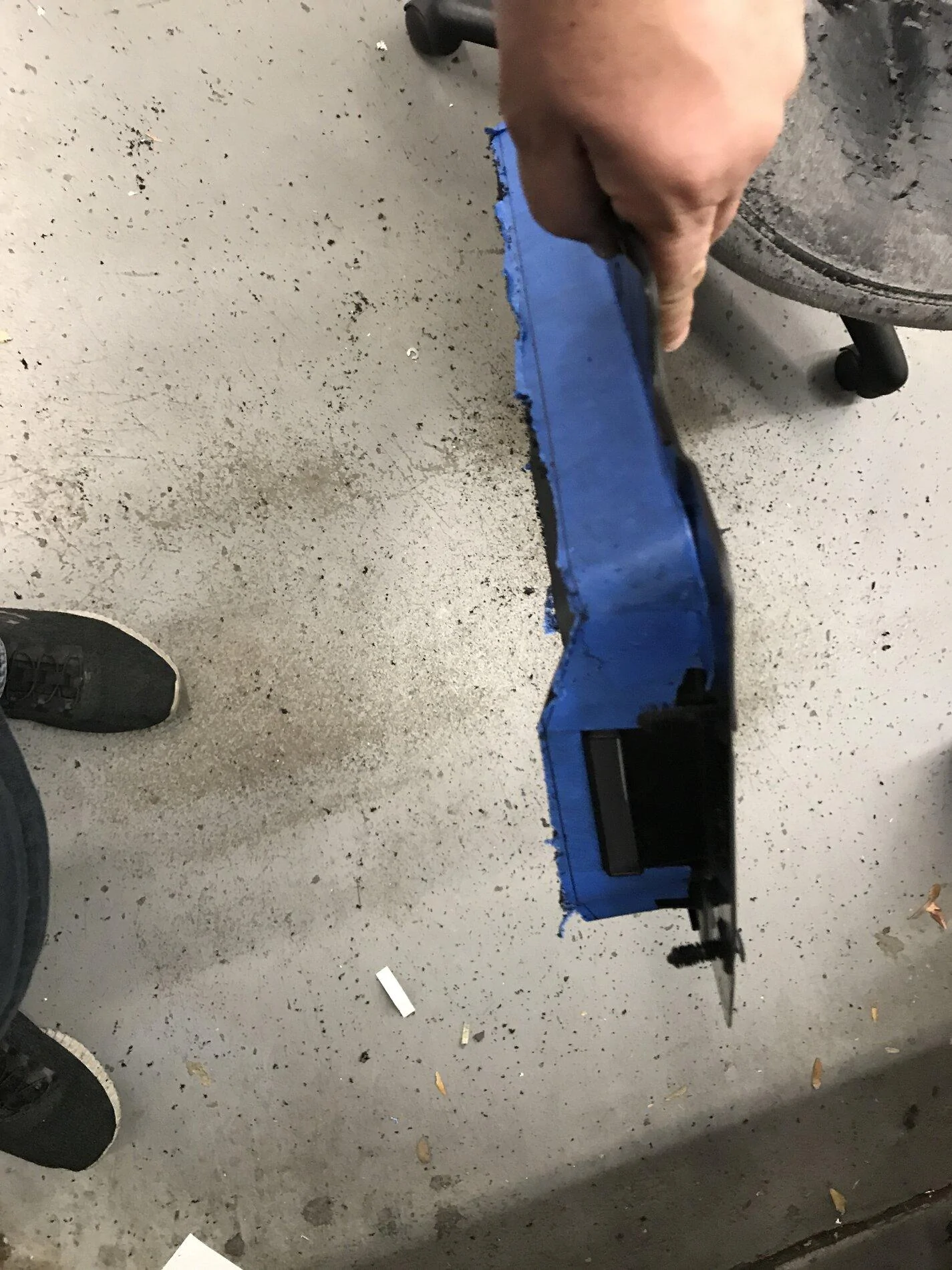

First things first...make some space.
Fun with an air powered sawzall.
A little massaging with a DA sander & voila:
In comparison to the driver side:

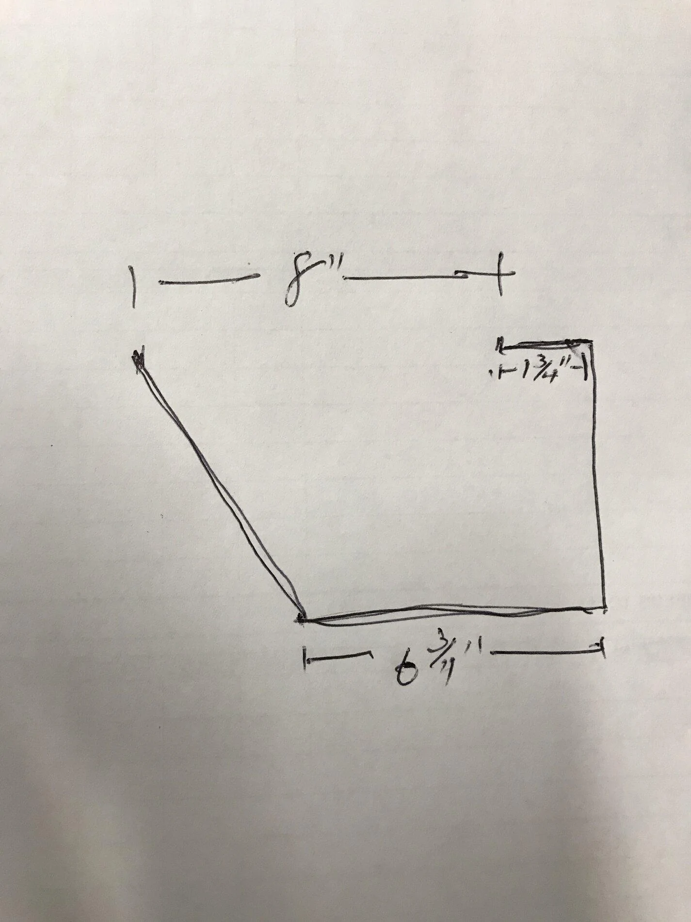

With the help of a contour gauge & some more DA sanding skills I have the beginnings of a sub bracket.
Mock up in the hidey hole.
BTW, the LED bulbs for the old school shop lights at Lowes are awesome. No BS USB charging cable, brighter than the lights that use said charging cables, & no holes burnt in the upholstery.
That's all for now.

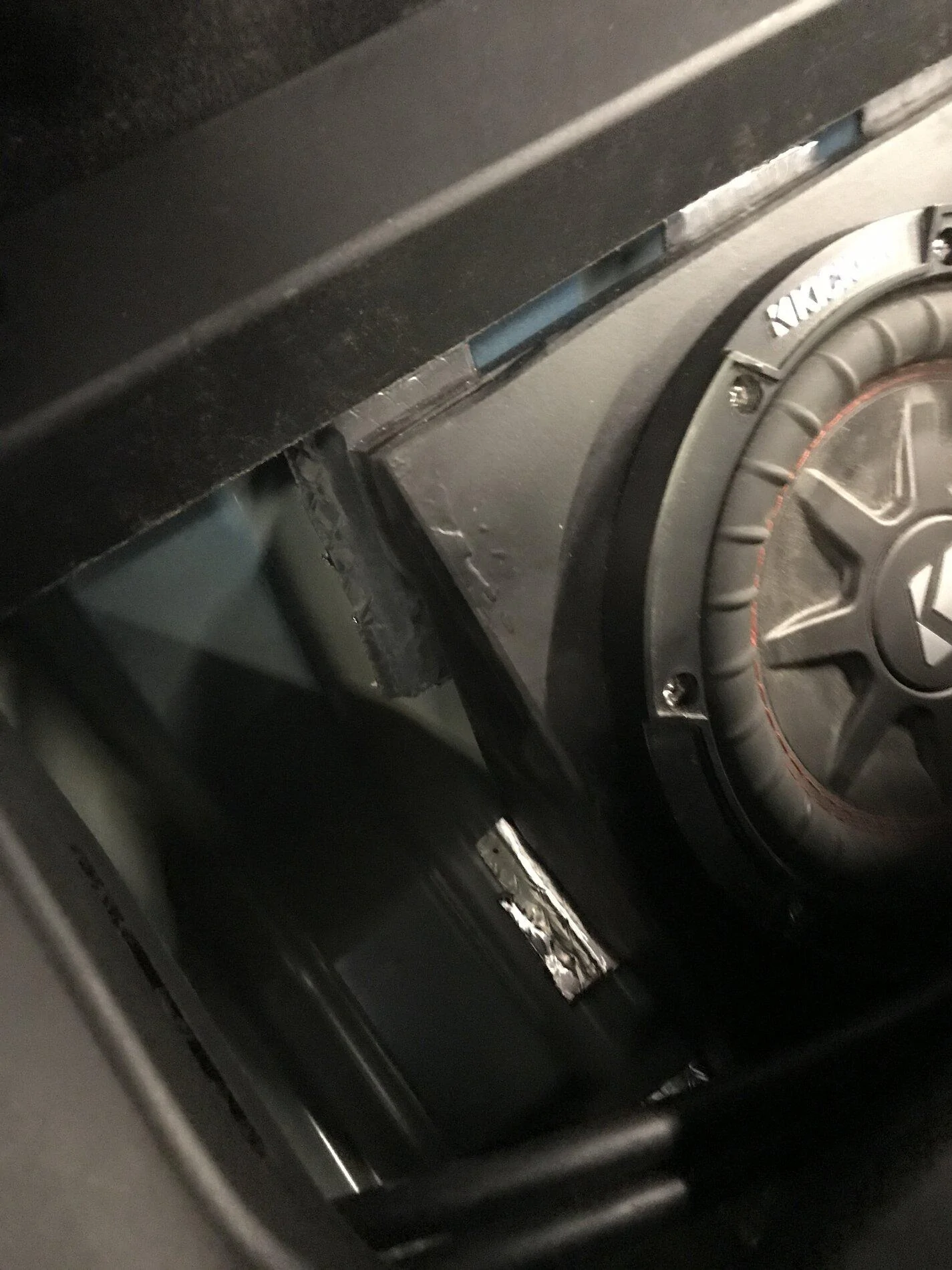

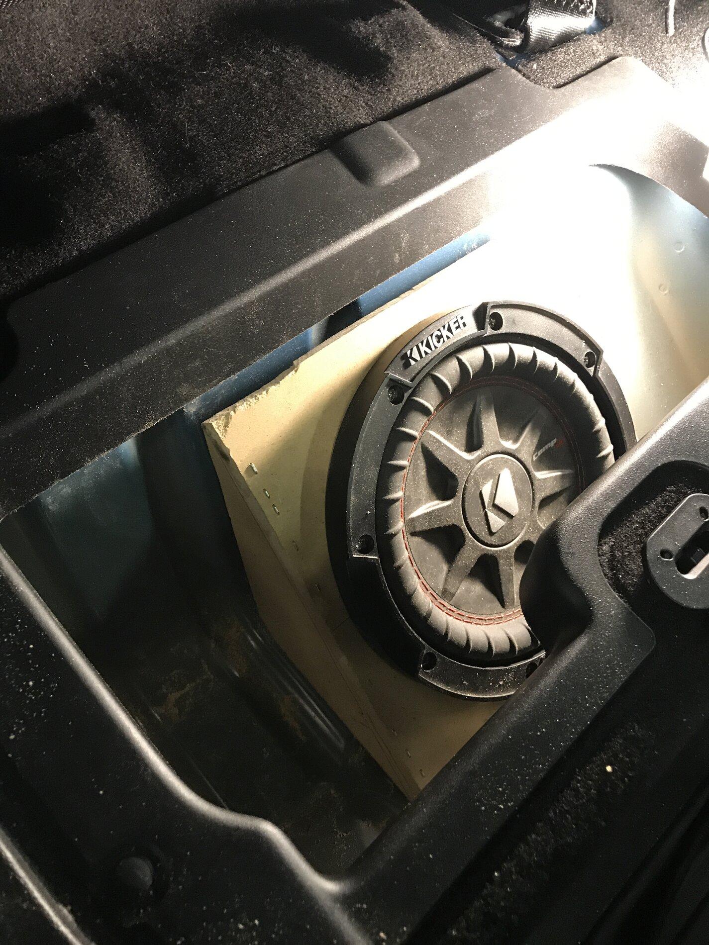

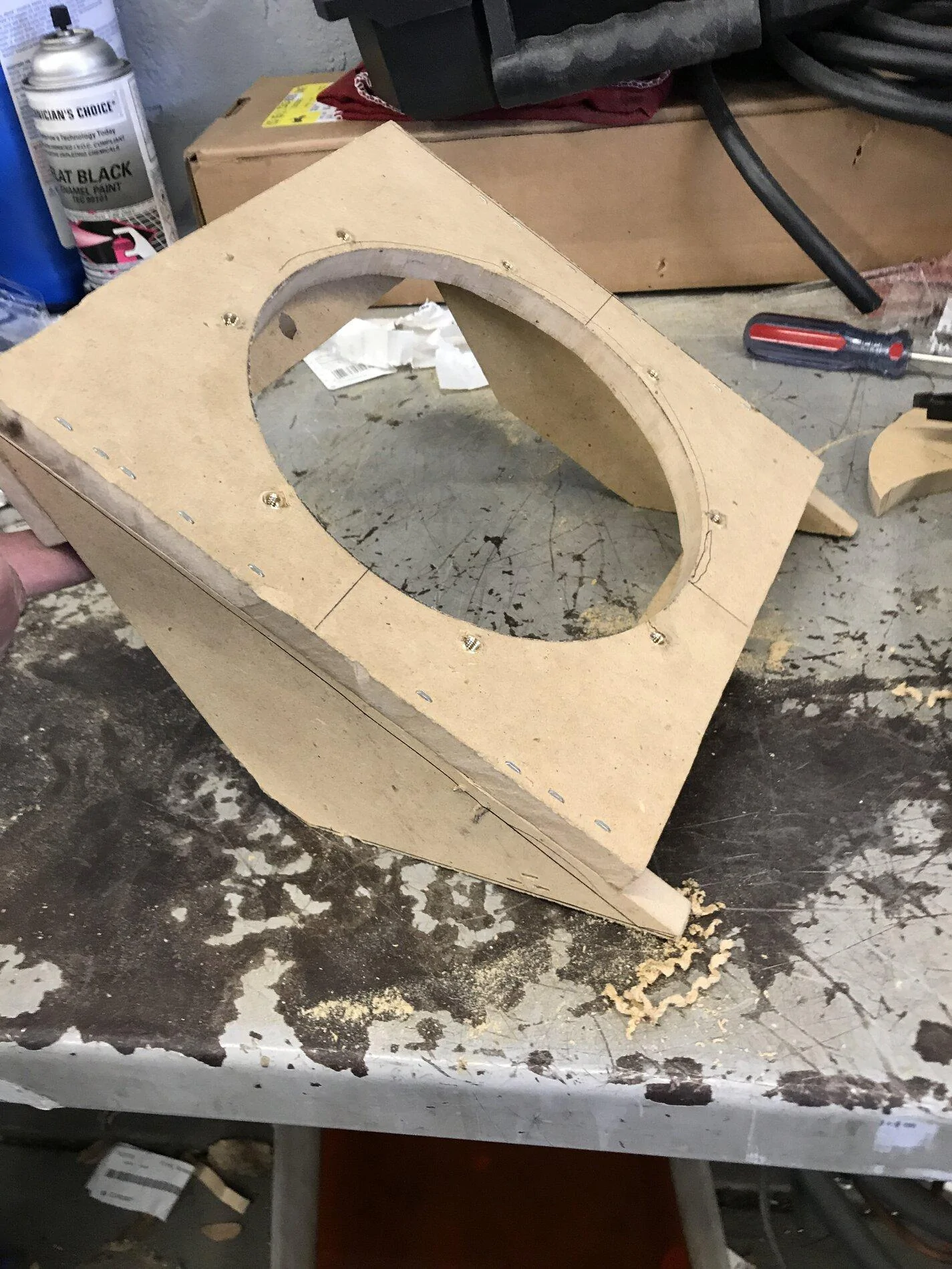

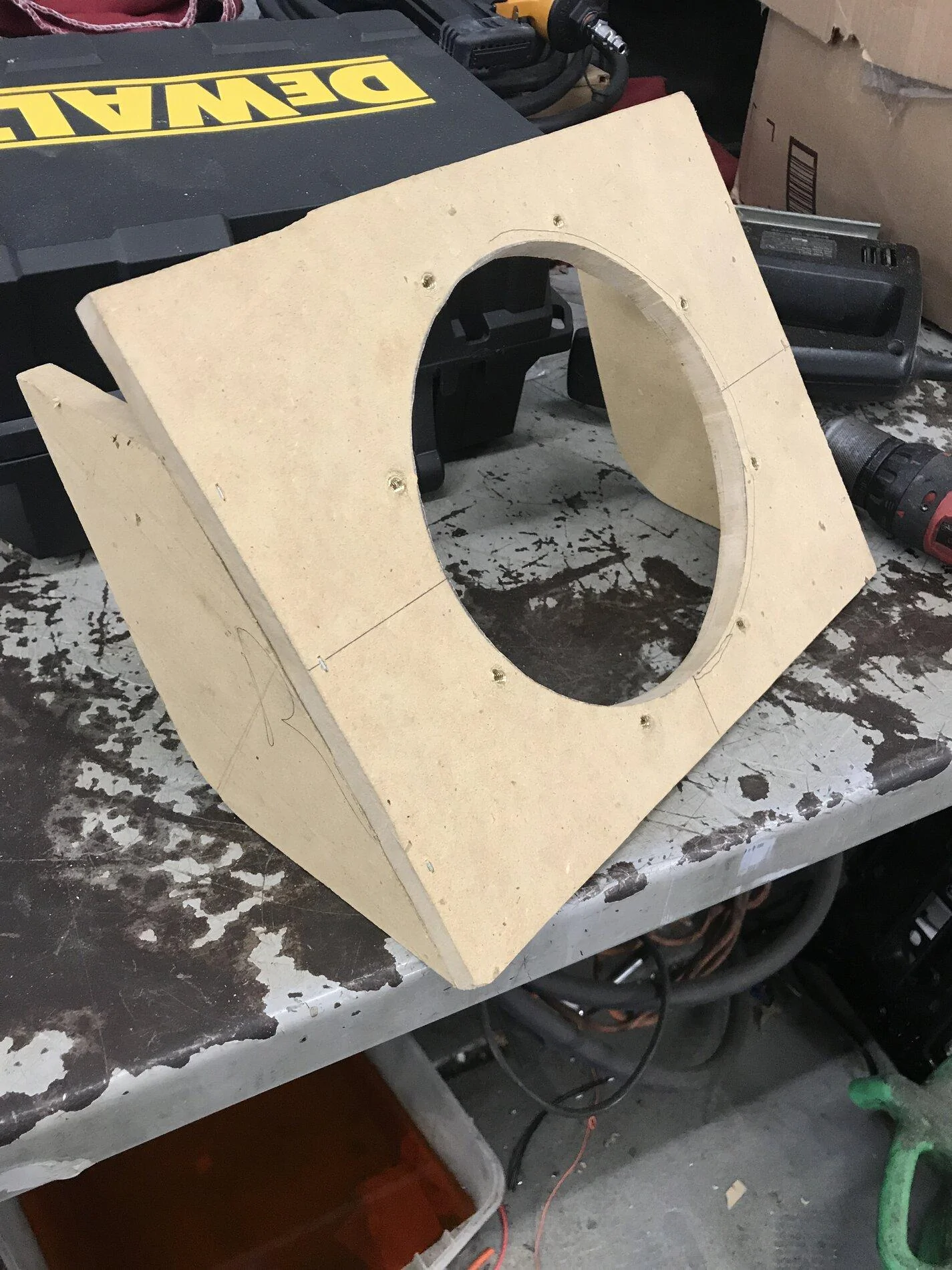

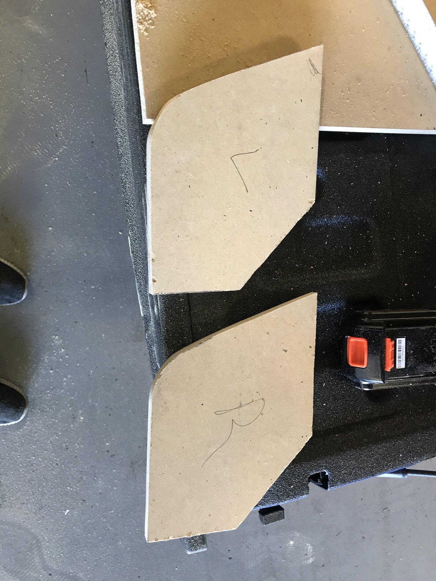

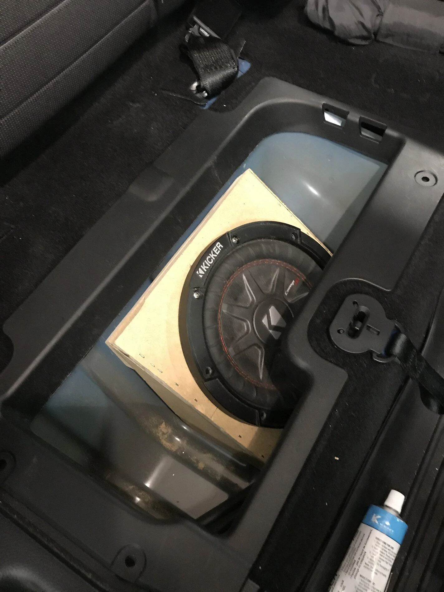

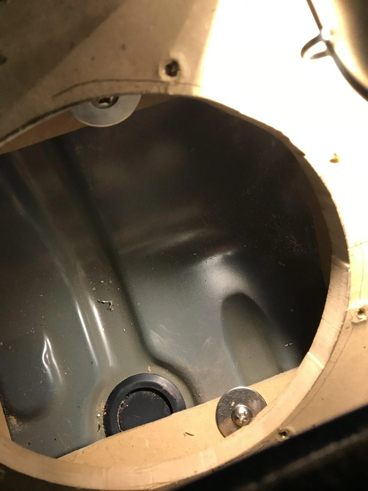

Installing the subwoofer today. Started out with this, but ended up trashing it & slimming up the speaker mounting board on the sides by about 2 inches. Big problem aside from little to no space is major carnage to the compartment lid would be needed for it to fit as it sticks up about an inch or two, plus the inboard side of the pocket conforms upward to form the transmission tunnel, so this will be a massage to fit on the inboard side of the "enclosure". Installed some brass inserts for the speaker mounting bolts as well.
After measuring about twenty times & cutting about ten I came up with this. The angle of the speaker now allows the lid to be installed without modifications, plus there's enough room to add some brackets to bolt it to the body.
After adding the brackets & installing some rivnuts to bolt it all down. I sealed the rivnuts with body shop clear seam sealer to keep water leaks at bay. Could probably use some silicone sealer as well.
It's not going anywhere.
Final piece. Never claimed to be an artisan woodworker, but it fits snuggly & it's pretty solid now, & will be even more so after I fill in the seams & smooth it all out. Not sure if I'll carpet it, might just paint it black. Hopefully next weekend this will get wrapped up. Have to insulate the pocket, then finalize the wiring, & setup the sub amplifier.
I'm pretty sure it's not gonna be the best sounding sub install ever, but I'm not looking to blow the windows out & I'm all about discrete rather than show everything to the world.

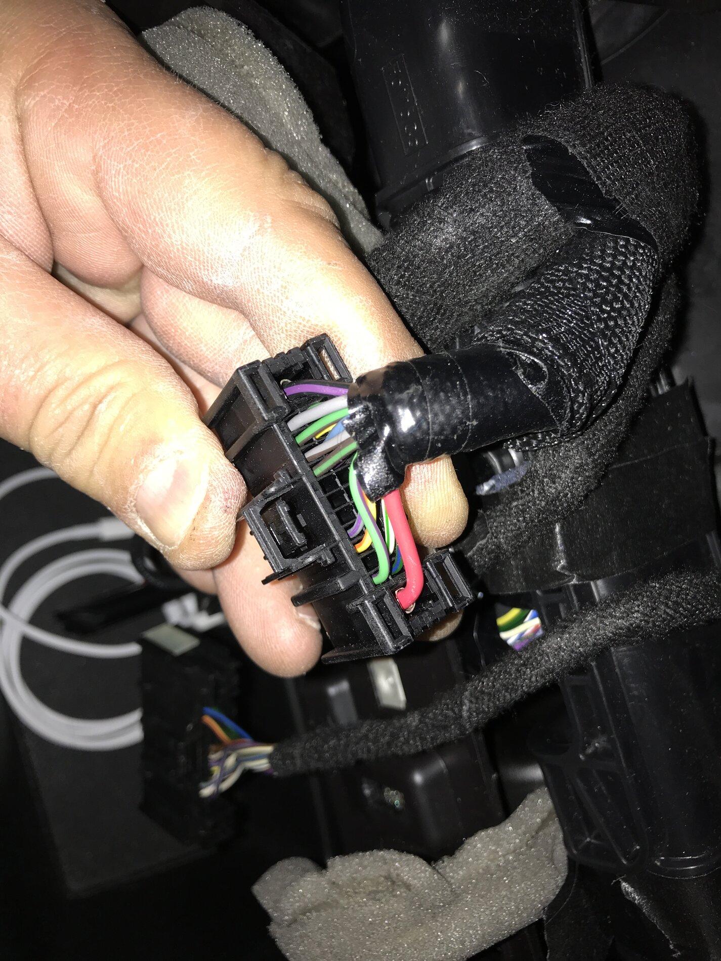

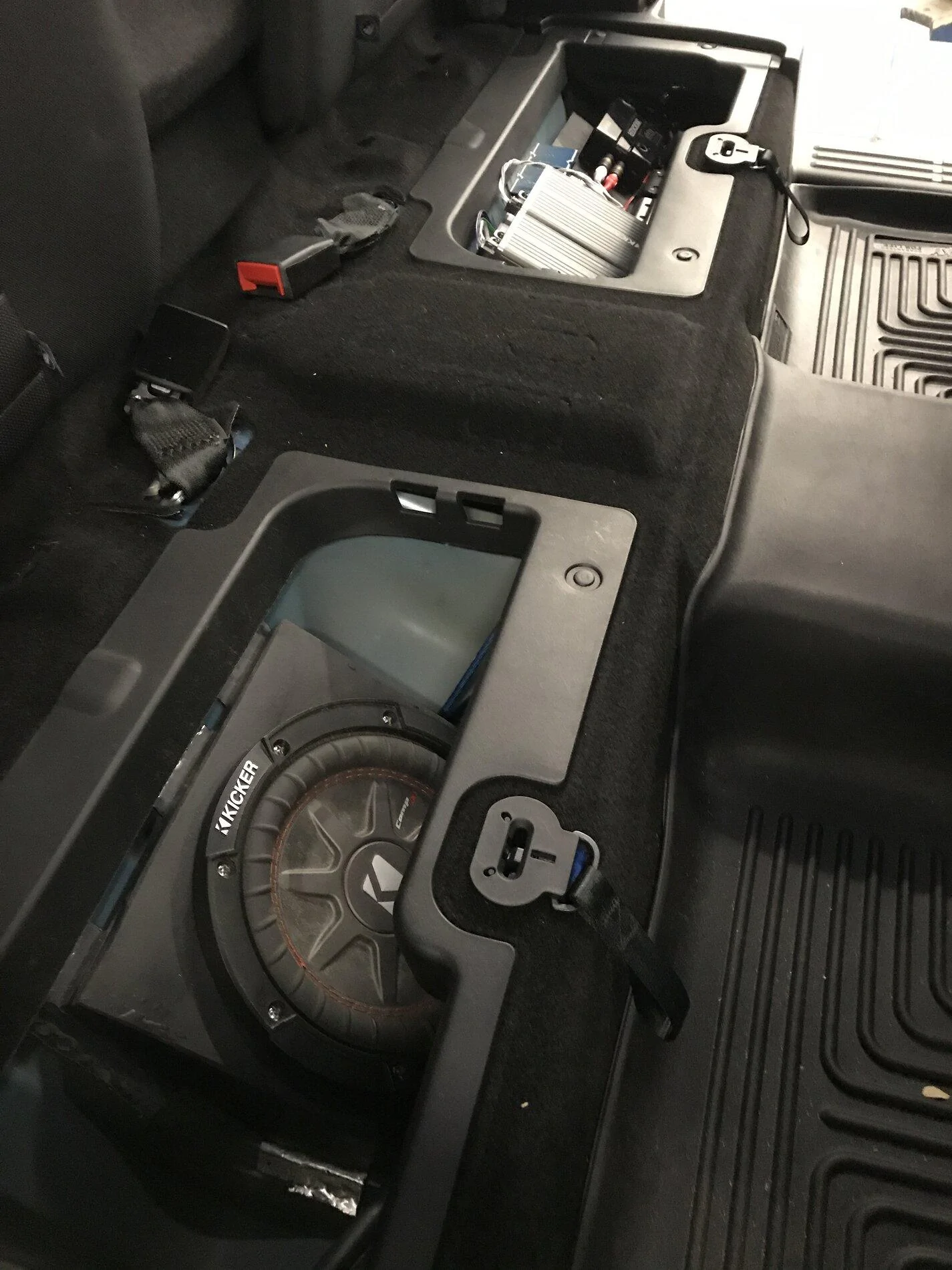

I believe I am officially done. Another slow day at work, so on to tweaking.
Originally I had 2 sixteen pin GT150 Deplhi connectors joining 2 sets of 9-wire between the head unit & the amp board. Problem with that is the Key 200.4 has the speaker outputs on the same connector as the power, ground, & remote turn on, so I couldn't set the gain levels without blowing out what's left of my hearing.
Ended up swapping the 16-pin at the amp board with 2 8-pin GT150 Delphi connectors, separating the inputs/outputs, thus enabling me to disable the speaker outputs & set the gain levels painlessly.
In a nutshell: dropped the 4-ch amp input voltage to 4 volts (with the PAC line boosters), set the crossover back to 80hz from 120hz, & re-ran the auto setup. Allowed me to actually move the gain knobs off of zero & actually push the amp harder (used 1000hz sine wave signal).
For the 500.1 amp I had to redo the KeyLOC setup. Voltage was a bit low initially (like 2.9v), which would explain the weak sub output. After redoing the KeyLOC setup I was able to push the output voltage to the 500.1 input up to almost 10 volts, but evened it out at 4 volts like the 200.4. Re-ran the algorithm for the 500.1 (using the 0db 50hz signals for the KXMA and KMA amplifiers to set the gain matching & not the 500.1 gainmatch sweep tone) & lowered the crossover to around 80 hz, & added some bass boost.
High & lows coming through much clearer now. Subwoofer is definitely moving air, as the low end is much fuller without distortion. I have some distortion free midbass once again as well.
Hope this was useful & entertaining. Good luck on your own build. ;)
