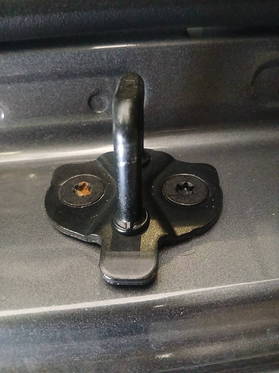

Look at both strikers and see if the paint is worn uneven, mine is super easy , barely touch it and it latches...

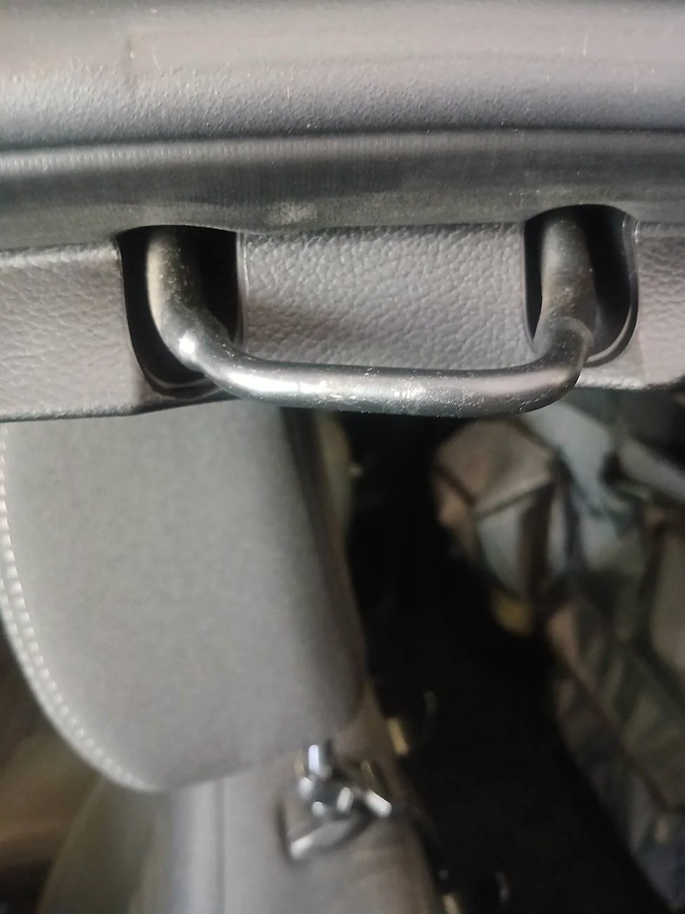

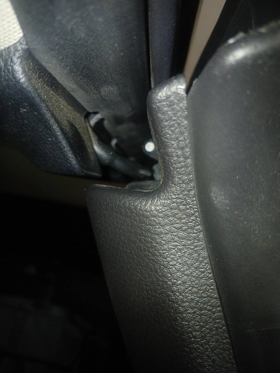

The uppers strike has a plastic cover that’s says “airbag”, so I’m a little hesitant to remove the cover to investigate.
@airline tech needs to check my work but in this scenario I would simply disconnect the battery before I remove the cover and fiddle around for peace of mind.
Yes, did looked at that. The bottom is slightly scraped along the top right side, the top is scraped dead centre which should be normal. There is no way to adjust the bottom as the screws self centre. The top striker hasn’t been investigated yet as there’s a black cover over it that say airbag. I’m hesitant to mess around with it. I think my next step is to try the door hinge adjustment. The door is definitely not meeting the top and bottom strikers at the same time. Door meets the Bottom striker first as there a gap at the top most likely due to the door hinge out of adjustment.
