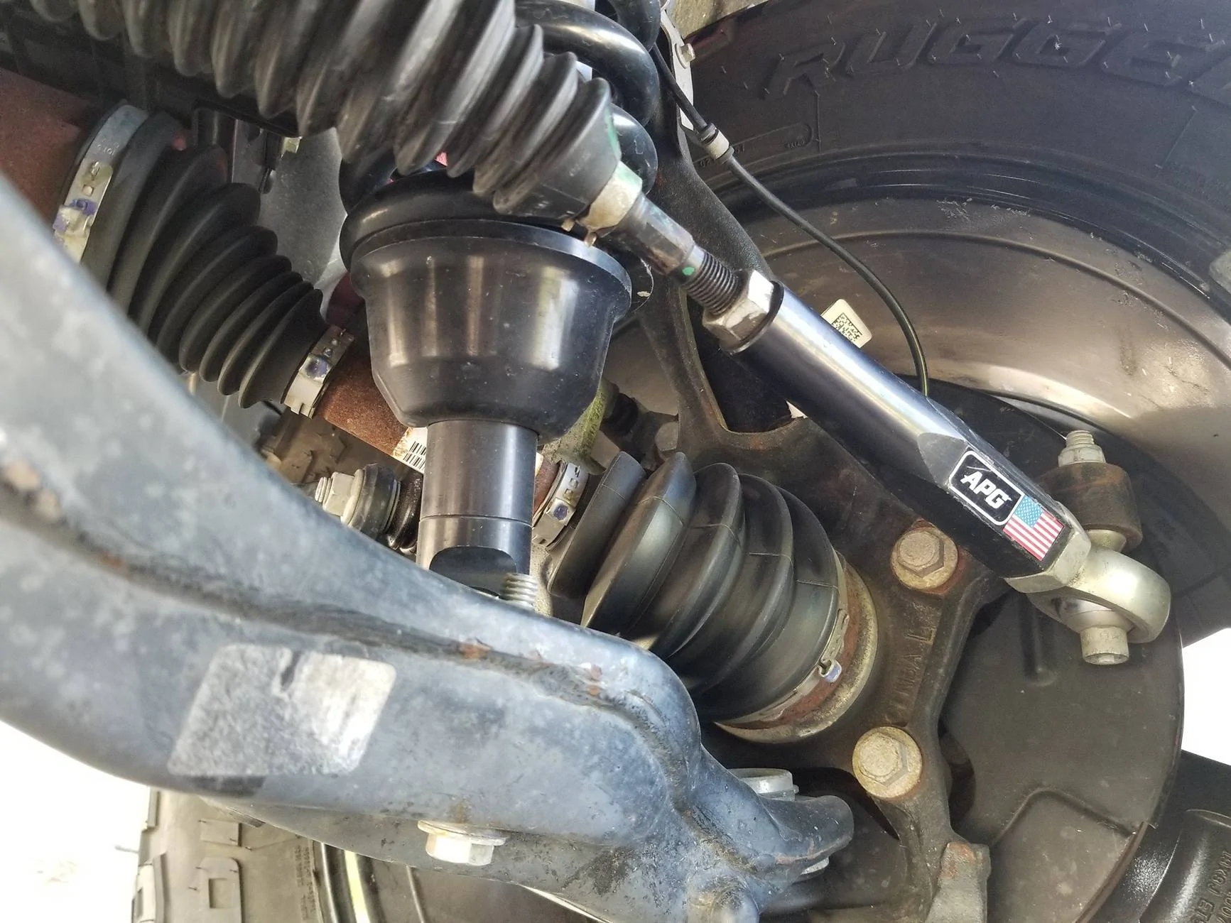

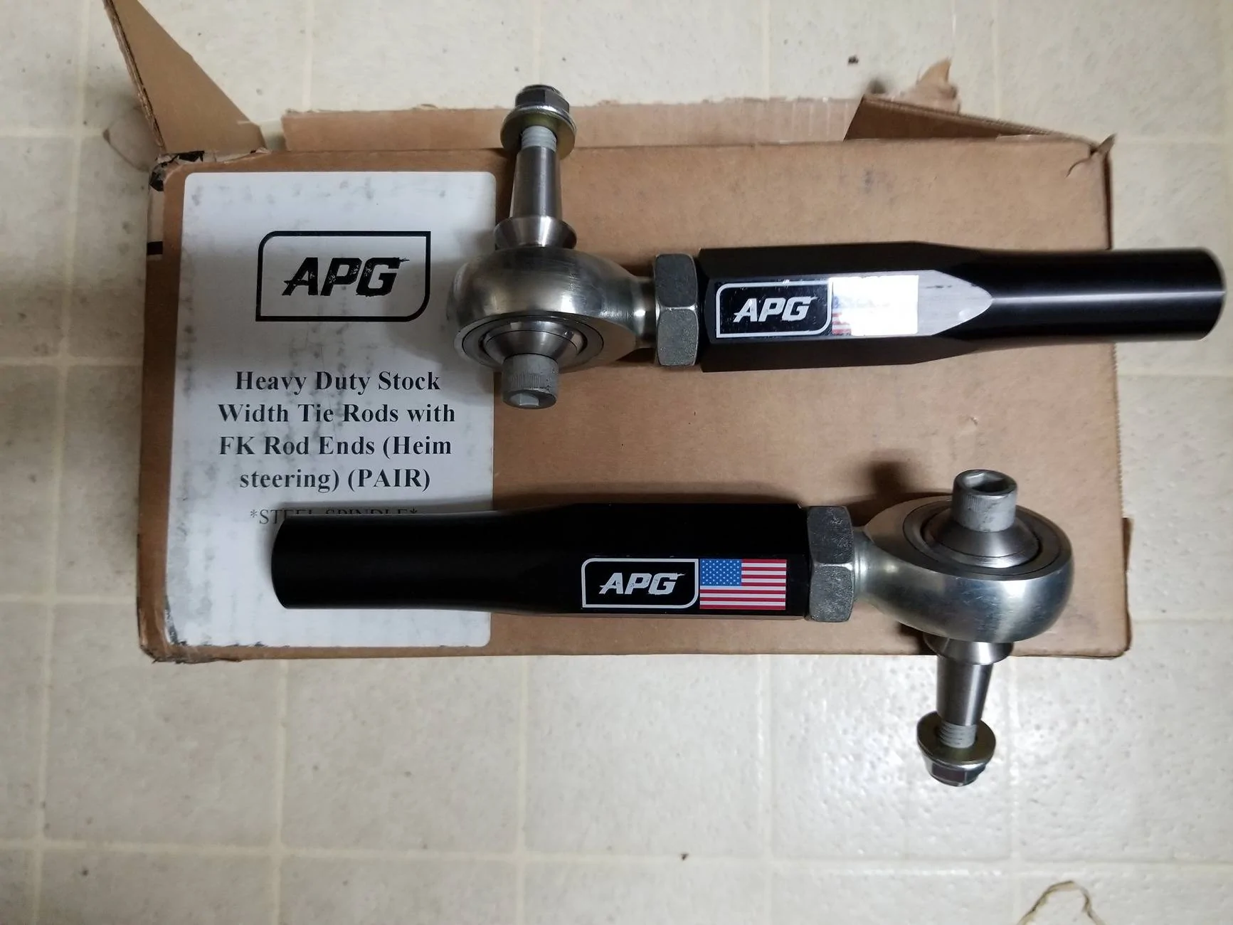

Not the Cool Factor of the Soupie spinner knob......my upgrade to my steering, APG Billet Tie Rod end...no deflection , Fk Bearing Heim joint end...greater range of motion , and holds toe alignment angle much better than the O.E.M Balljoint...

My lift came with upgraded tie rod ends. However they're only suitable with the lift. - I haven't had any problems with them. However, I second @Whiplash and APG; I had a buddy bend his OEM tie rod ends with 35's offroading (hardcore jumping- this wasn't the only thing that broke) and replaced with APG. If you're not an offroad guy though, i'd say you're fine.
