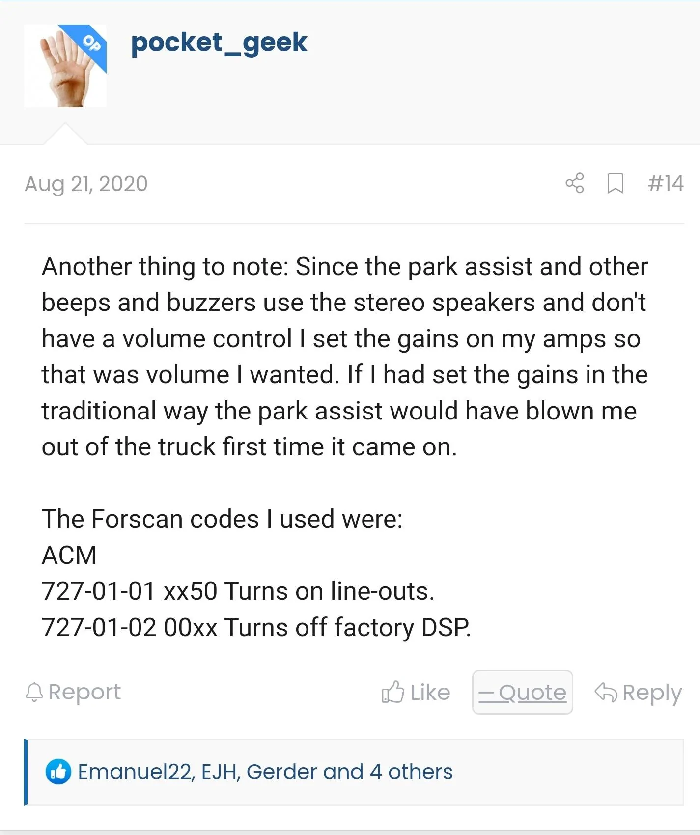

***UPDATE***
Mainly typing this out for others who may find this thread useful and not have the time and troubleshooting tools Im lucky to have ?
Issue is not polarity. Used some test leads and miniature alligator clips to try a few different setups and it was noticably worse at any significant volume. Stage3's harness recommendation from Metra is spot on, the metra ring adapters function great on the rear doors, use the Kicker rings on the front (or else the door won't sit flush *window will clear just fine*).
After reading other posts, here and elsewhere, over the past two days I've derived that the solution could infact be more powwaaa baby.
The "thunk" is making me feel like the cone is attempting to percuss and move enough air to make a "boom" but falls short and ergo at low volume there isn't a noticeable difference but as the volume rises it's very apparent. This same increased volume is further undermined by Ford factory settings inside forscan.
Two take aways:
1. Disable in forscan the factory DSP settings. (yet to do myself) and this will eliminate bass roll off that would have saved factory speakers from damage but inhibits aftermarket ones. See link/photo for forscan info. I cannot 100% verify but @pocket_geek seems like he knows his stuff ????
2. A small inline 4 channel amplifier may be just the ticket to get much more powerful speakers to actually move like they should.
Will report back because I really want to like this kit and the price point and honestly Stage 3 at that...but currently this is marketed as install and let'er'rip but frankly it just isn't and I feel this deserves an answer.
(https://www.ranger5g.com/forum/threads/audio-upgrade-shenanigans-picture-heavy.8837/)
