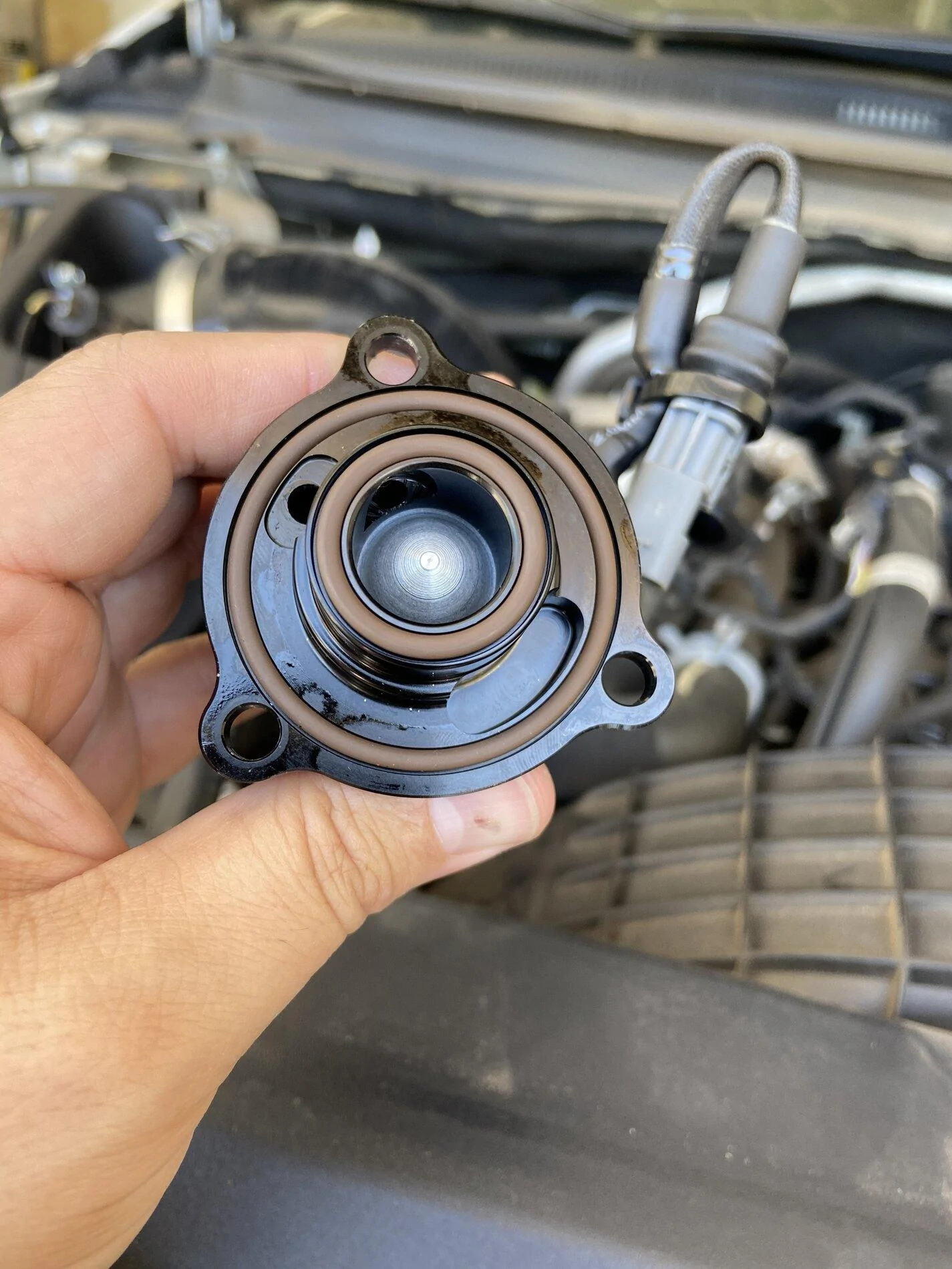

Well....problem solved. I’m happy to report back to our group that the o-ring was dry.
found this video on YouTube.
decided to give it a try and added some Lucas Gun oil to the ring and reseated everything. Worked like a charm!
thank you guys for all your input.

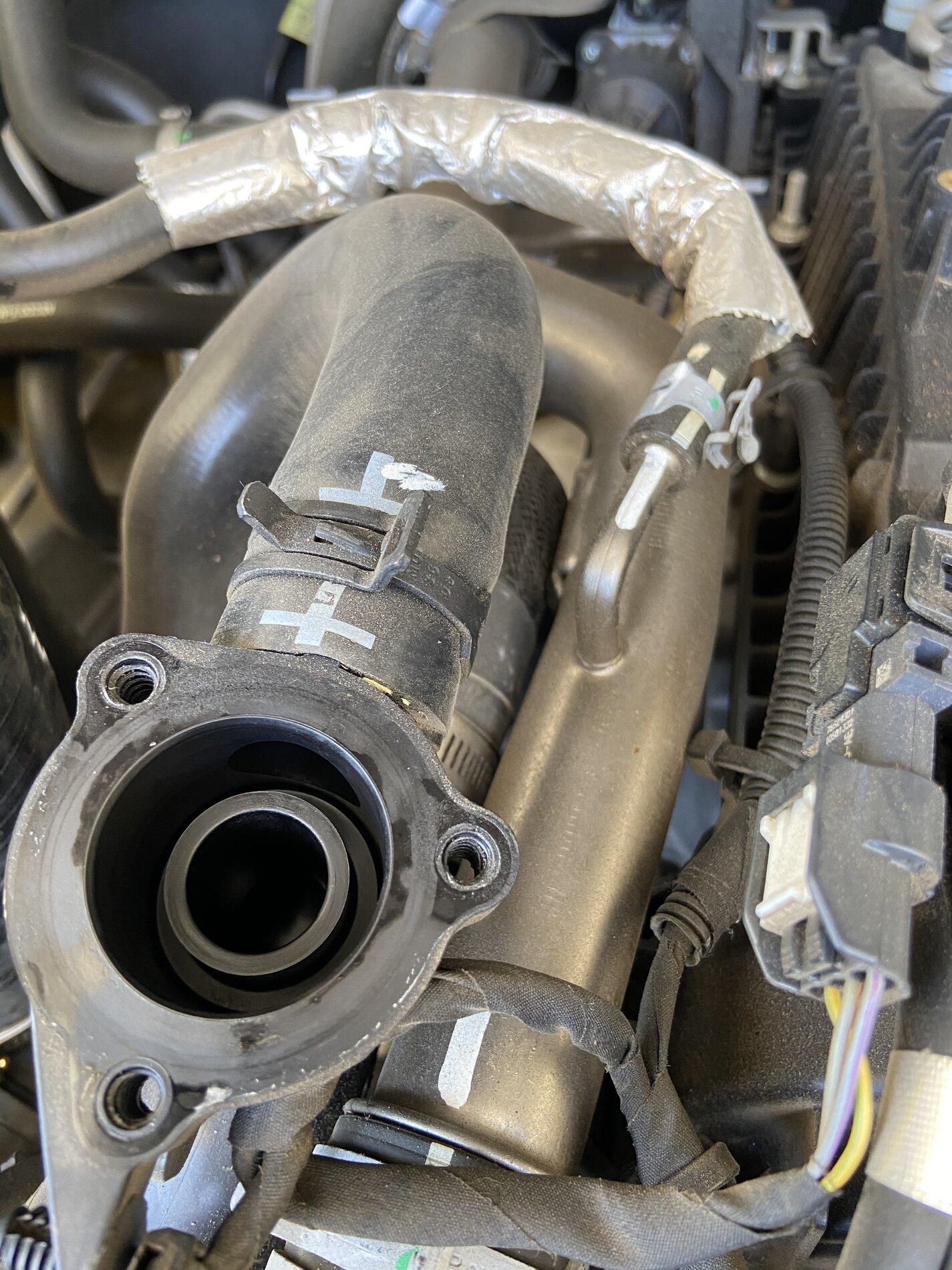

Hey guys,
So I just open the hood and double checked my connections on the blowoff valve. I thought it might’ve looked loose because of a tiny gap but I realize that was the space allowed for the gasket. I did remove it and took pictures of it looks like there may have been some type of leakage. I cleaned off both surfaces and reconnected and tightened everything down as best I could without stripping.
I took a video of the test drive.
Take a listen and see what you think.
If you would like to fast forward here are the times that I can hear the noise: 23 sec, 39 sec, 50 sec, 1:14 seconds, 1:42sec, 2min, 2:46 sec, 3:10 sec, 3:23 seconds, 3:33 sec.
