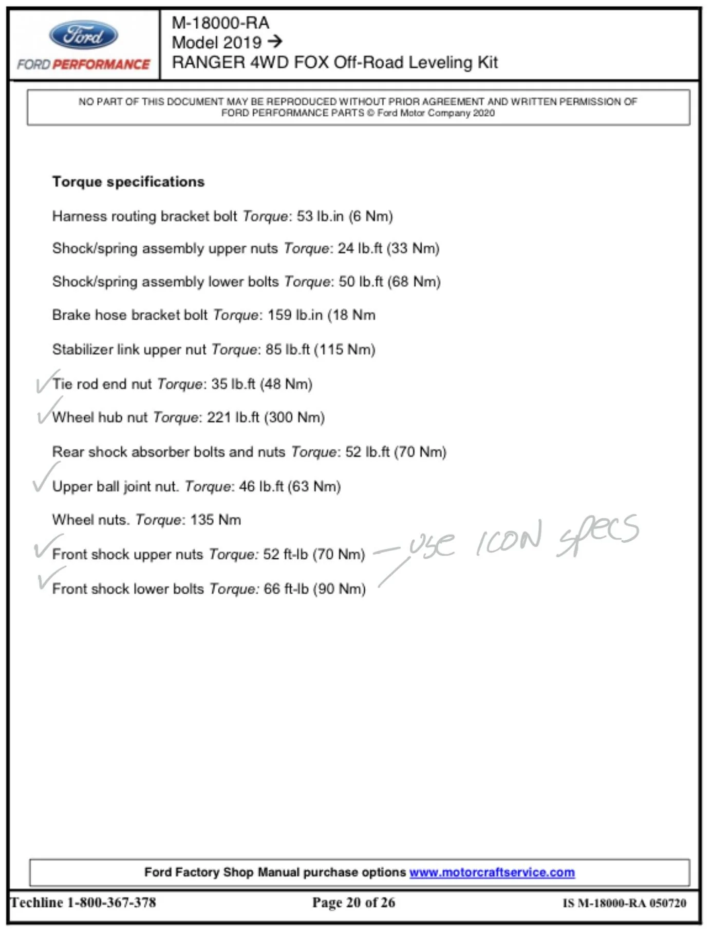

Maybe start by making sure everthing is torqued to spec.
If there are items that are loose, consider changing out those nuts for new or add locktite.
