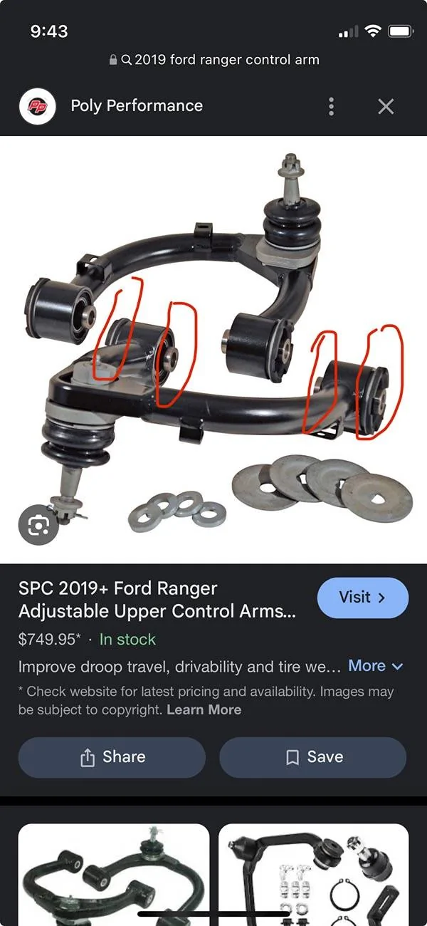

Sounds like the bushings. My truck sounded similar and I tried spraying the upper and lower controls arms with red n tacky spray and the sound kinda went away and then it came back the same day.
I ended up loosening the top control arm bolt and spraying each side of the control arm like the picture below. Then tightened back up and it went away and haven’t heard it since, it’s been about 10k miles. And I didn’t have to take the bolt out, I just loosened it enough to fit the red spray tip in between the parts.
try the top control arm first to see if it goes away. it probably doesn’t hurt to spray the bottom too. If you loosening the bottom bolts make sure to mark the camber bolts for re-tightening.
