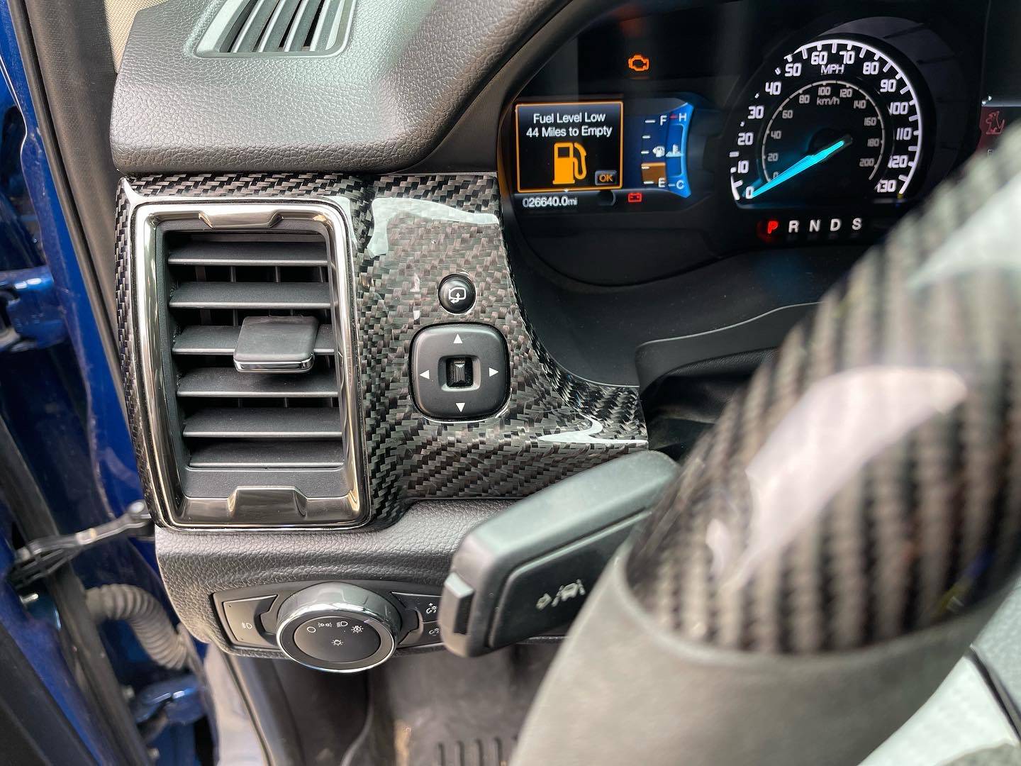

Looking forward to seeing someone get a all leather option. Definitely like the shape better than oem.

Does this change the weird 9-3 feeling that the OEM wheel has? Is the shape different at all?

How was this install Allen? Mine is coming next week and I need to start seeing how to remove and reinstall
install wasn’t bad at all, the hardest part I’d say is removing air bag. Which is still not bad.I used a welding rod to stick inside the hole on each side of the wheel to release the pin on the airbag. Make sure you unplug your battery before install. Then the rest is not bad at all. Just take your time

Sweet!! Getting the airbag out obviously freaks me out, so to hear its not as bad as I am thinking calms me down a bit. Thanks Allen!
