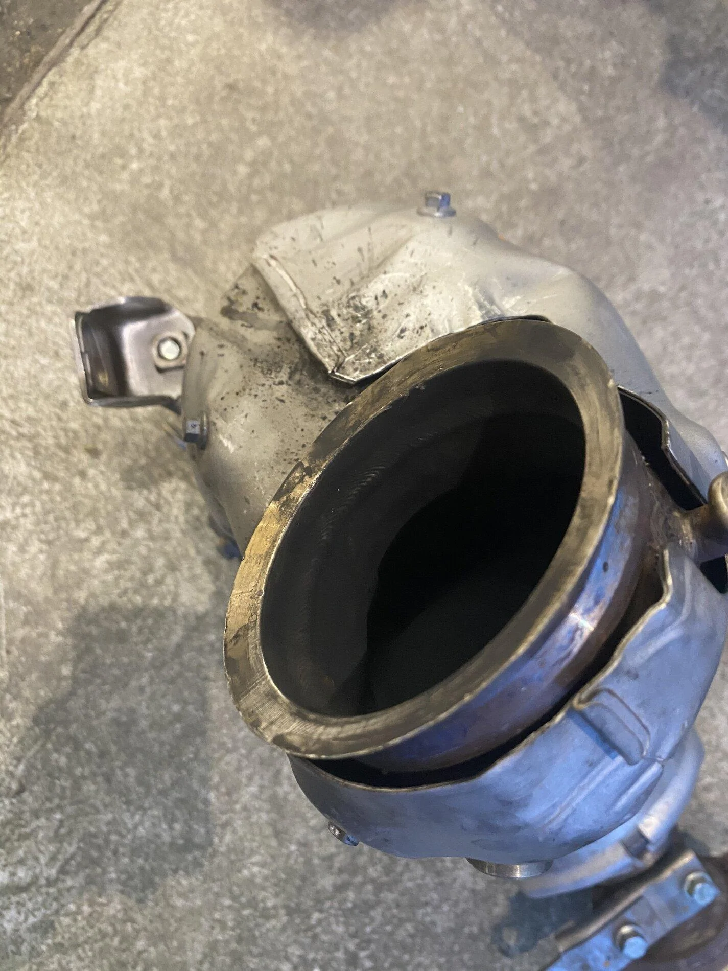

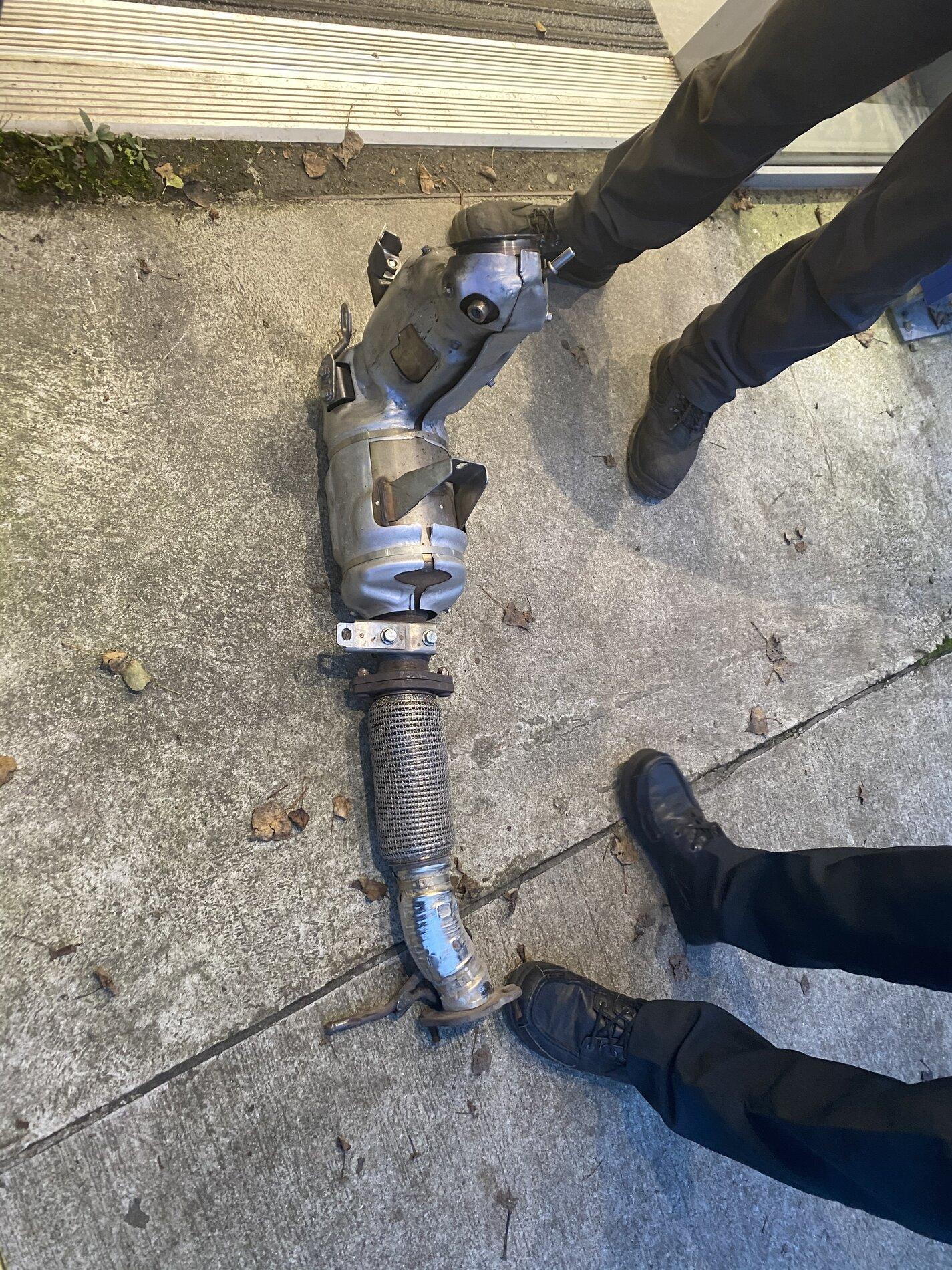

Hi all, thanks for the responses. It was the DPF, it’s face was distorted and wouldn’t sit flush against the turbo gasket. Got it back now and seems ok. But only had it two days so hopefully continue to be this way. Here are the pictures of the replaced DPF. Thanks again, really appreciate it.

It would need to get rather hot to cause the plate to warp, so I would guess it was.
Oh I meant does the Raptor have AdBlue where you are, but you answered my question anyway. We don't in Australia (DPF only), commercial vehicles are in a different emissions category but the Everest does have AdBlue.

Aah, makes sense... definitely has ad blue. I think it was a manufacturing fault or they did a recall before I collected the car, something to do with the ‘check transmission pump’ recall... not sure if they needed to remove for that but could have damaged it then if they did.
