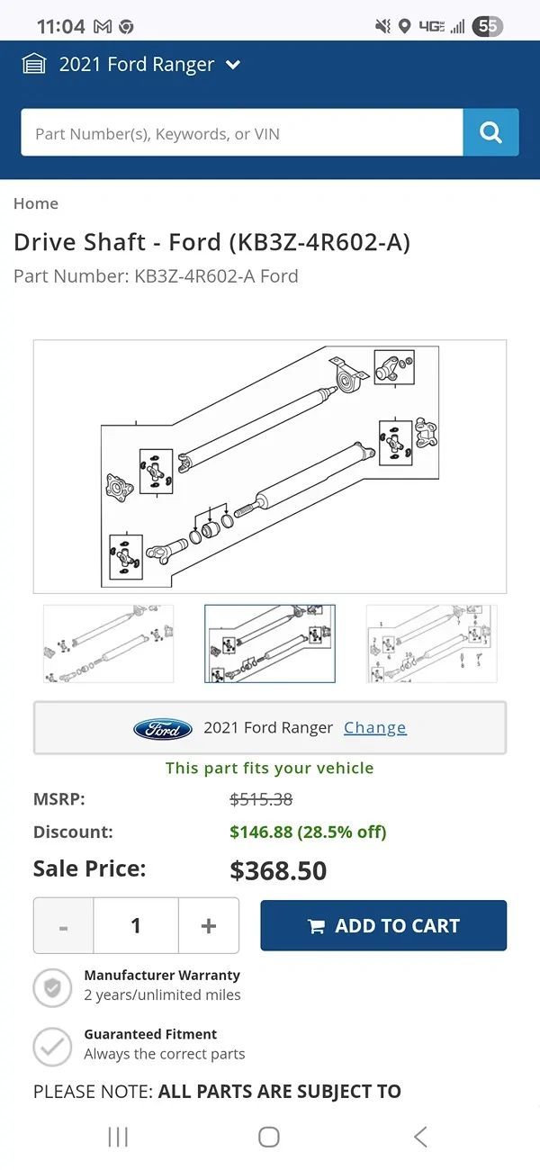

I'm assuming this is the part. Seems like the sell the driveshaft in 2 separate pieces and this one appears to be the half with the carrier bearing.

Another popular option is to get a Tom woods single piece drive shaft. Should eliminate any shudder you have under acceleration, and there's no carrier bearing to go bad in the future

If replacing outside of warranty, in your own dime, I'd go Tom Woods all day

I looked on their site. They need a specific measurement? Not understanding why they'd need this.
Also saw that ford does sell just the bearing... KB3Z-4W602-A which I've seen for $120 from fairway Ford parts.
