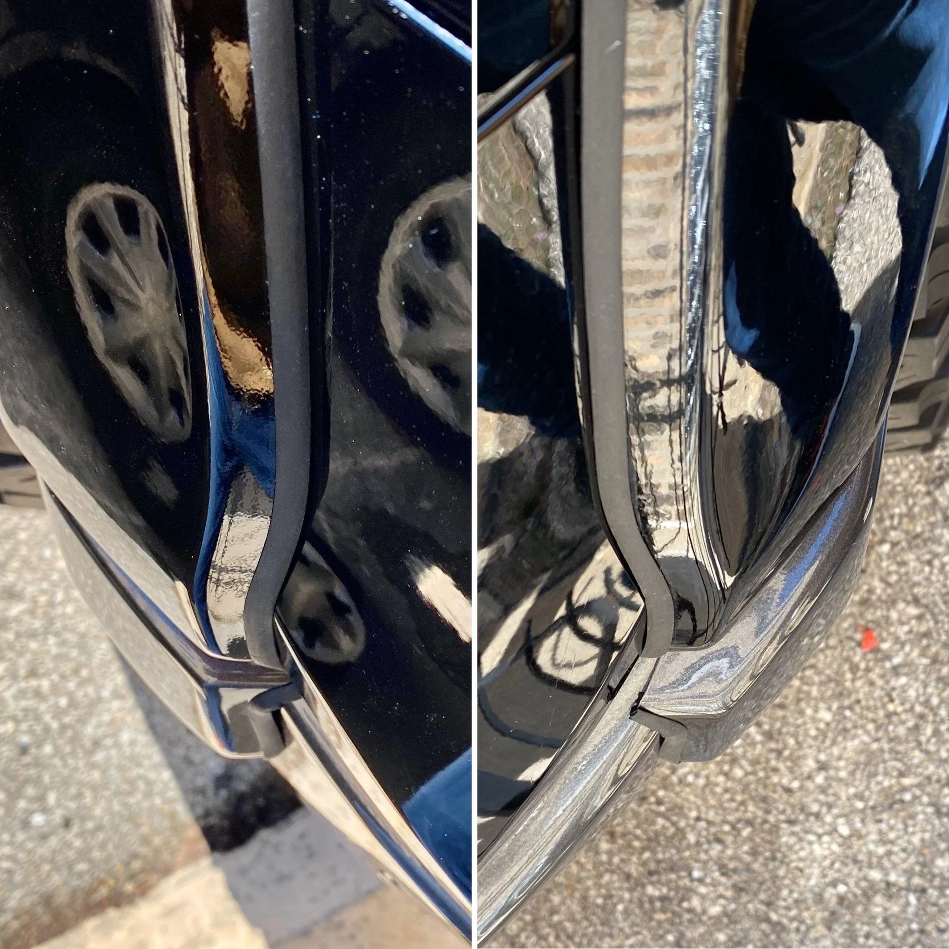

One thing to note for anyone considering these, when I installed the bumper extensions it very clearly called out that my front bumper is not aligned properly, off by about a 1/4-1/2" on the drivers side. Project for another day to see if that's something I can adjust without a major undertaking... so anyway - the flares are great but double check that Ford installed your bumper properly haha.
If you look up the install instructions for the BDS Intrusion Beams, they show you how to remove the front bumper. It's really not very difficult, especially since you're really just loosening the 6 bolts to adjust it. The worst part is the stupid junky clips Ford uses to hold the front bumper valance on.
OT but you guys really don't need to remove the bumpers to pull out the beams...loosen and work the beams out one side at a time...I've done it...
There was no way the front beams were coming out on my Ranger until I loosened the front bumper to make room. Trust me, I tried.
Yes, exactly...loosen the bumpers as far as they'll go without coming off and rock one side all the way forward with the other side pushed to the rear...you'll get just enough to slide the pulled side out...
Awesome thanks for the heads up. I actually had the intrusion beams installed by a shop while they were doing UCA's & suspension. Thought for a second it might have been them but went back to old pics and noticed the misalignment straight from the factory. Good to know it should be easy enough to correct though, will give that a go myself.
