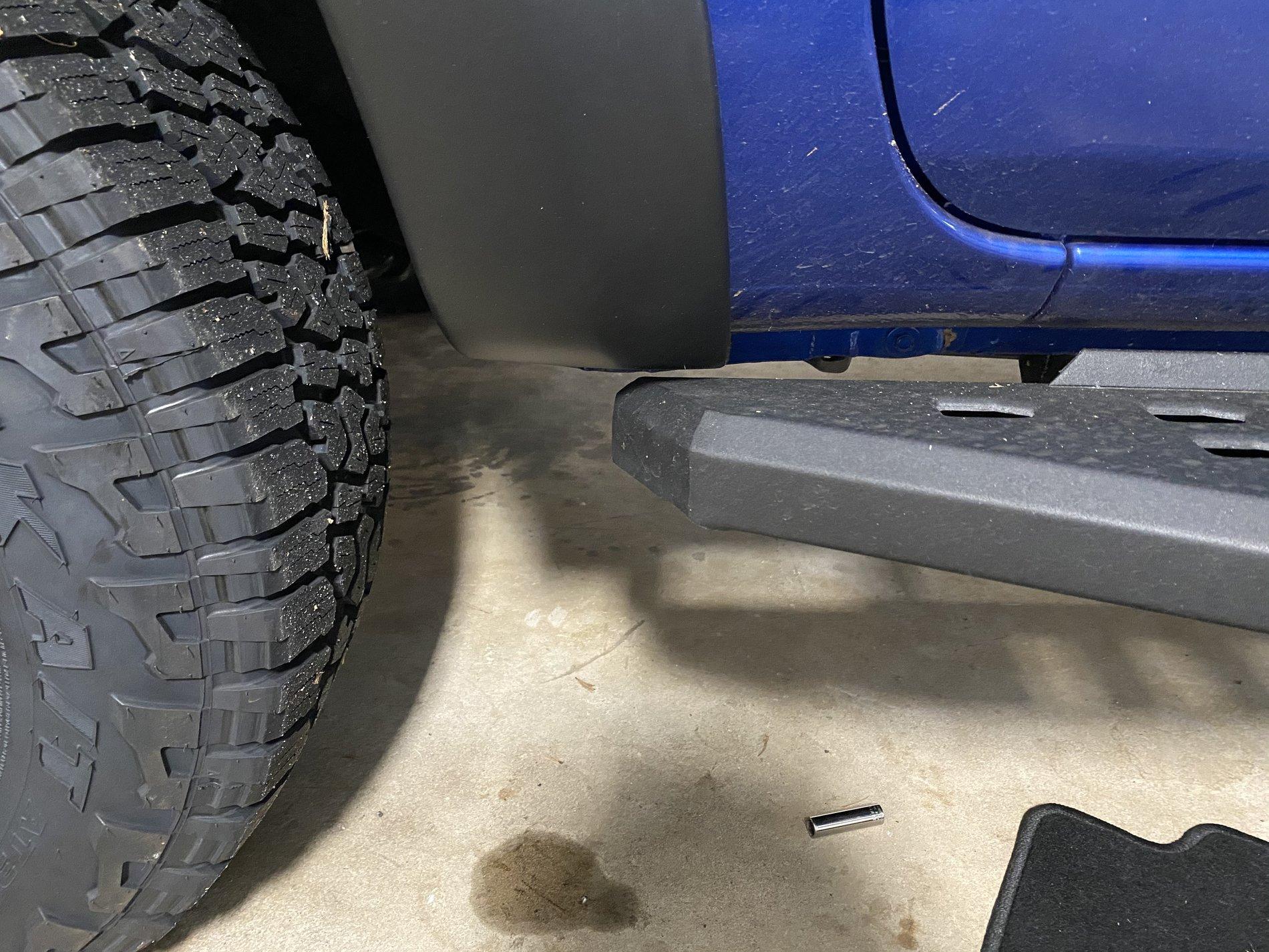

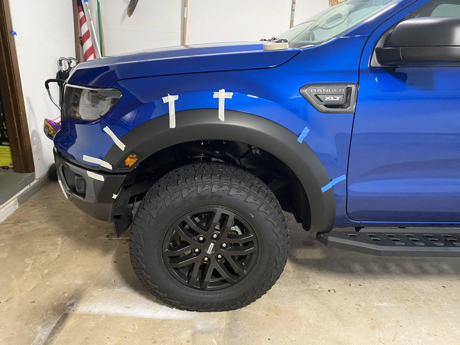

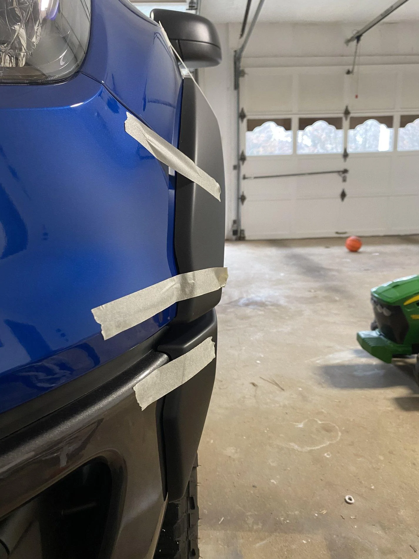

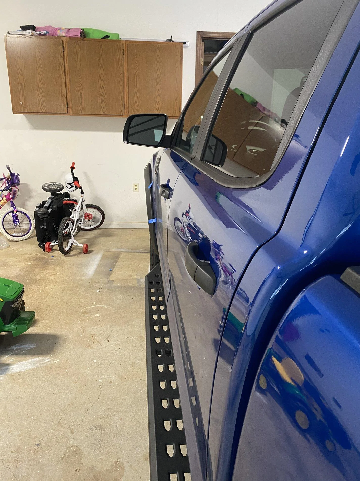

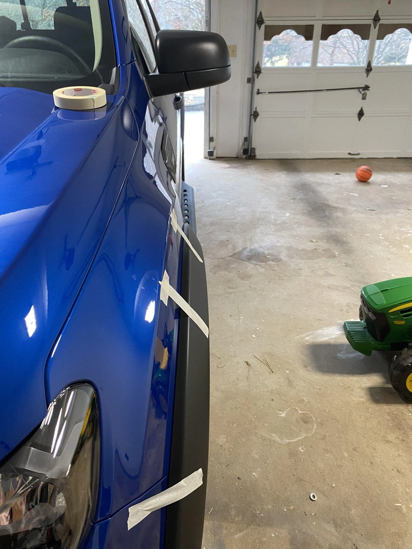

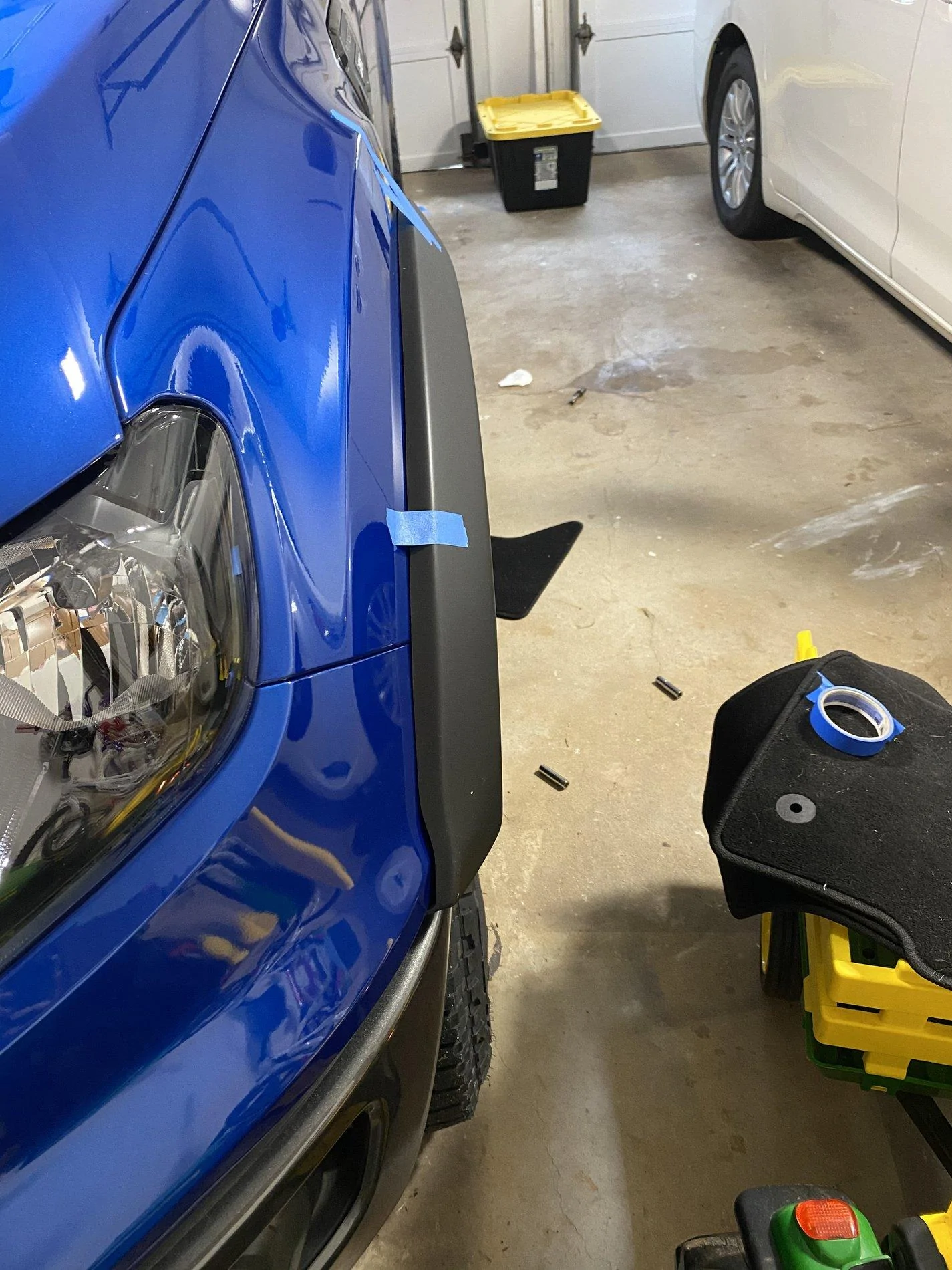

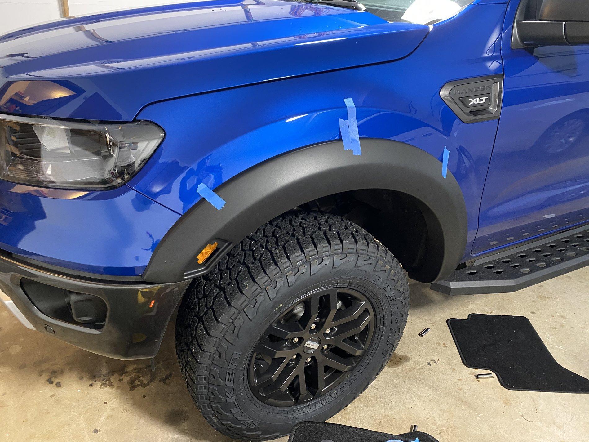

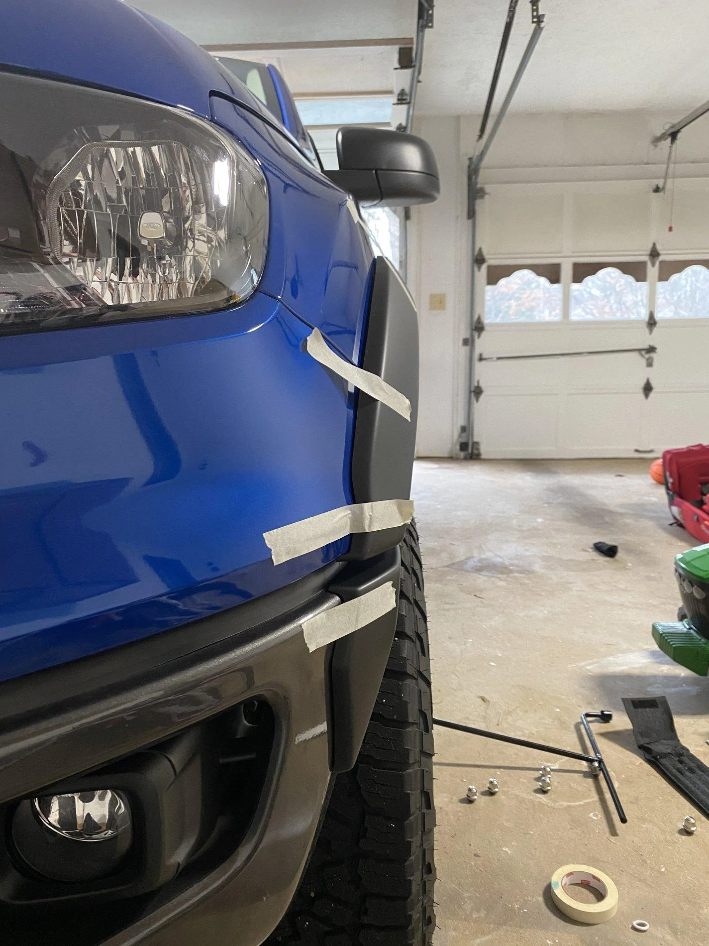

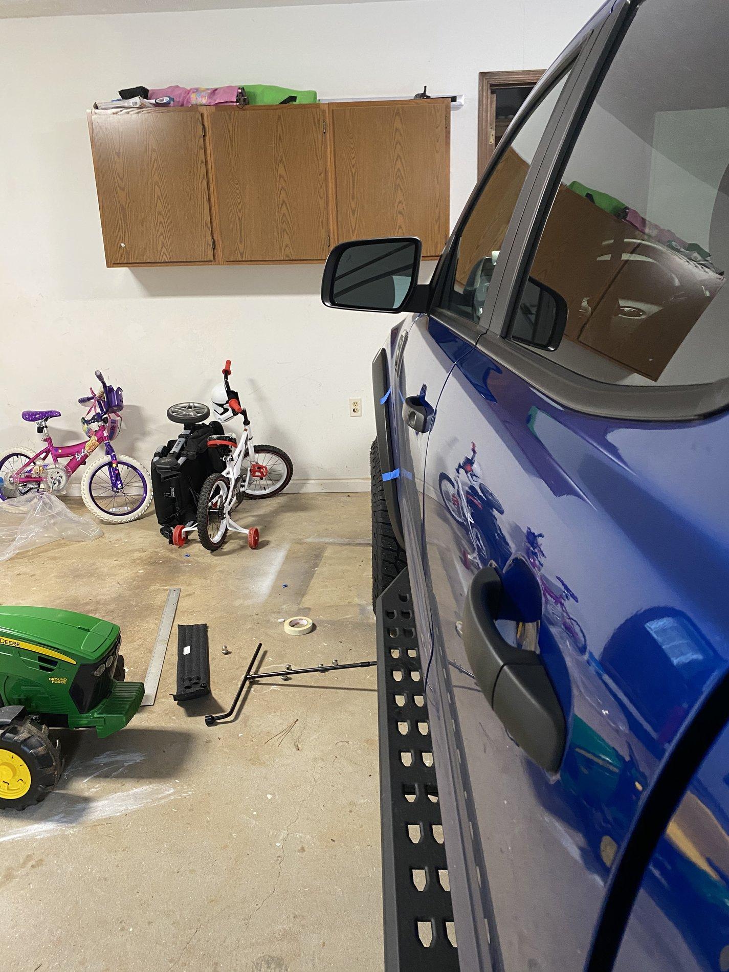

Just a quick test fit to see if there was any interference with the running board. There was initially with my RB20s but I just loosed the bolts and was able to re-adjust enough to get plenty of clearance.
The finish looks great! Very Ranger Raptor inspired

Thank goodness! Someone has finally addressed that dreadful look of the other flares where the added width of the flare terminates at the bumper. Whole reason I never even considered the bushwackers.
exactly... but, to each their own.. this is just the road I’m traveling...

Looking good. Did you decide if you are going to paint or not yet? Either way would love to see pics once you get everything mounted.

Also I did another test fit today to take some measurements moving the tire to see how far out I liked it. I think a 1.5” spacer will suffice. My Raptor wheels with 265/70/17 tires are almost exactly flush with the OEM fender trim from the outside edge of the tire. With the RTR fenders adding 1.5” I may just stick with a 1.5” spacer. If I were using OEM wheels I may would go 1.75” but my wheels are 1/2inch wider. I also emailed RTR to see what offset they were using on their RTR Ranger package. Will report back when I hear from them.
