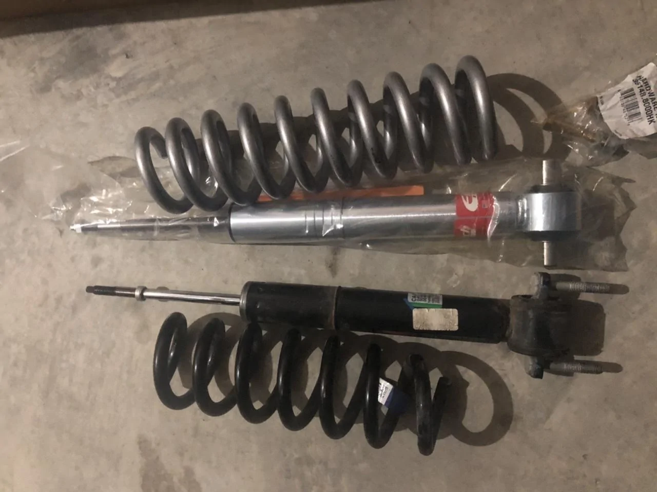

Can you post picture or measure the length difference between the eibach and the stock front shock length? If you dont have it installed yet. (Im talkin uninstalled, fully extended, bare shock length)
Thanks

No Im talking about the length of the shocks themselves, not the vehicle height.

I didn’t take any measurements, but you can get a rough idea from this pic hopefully.
