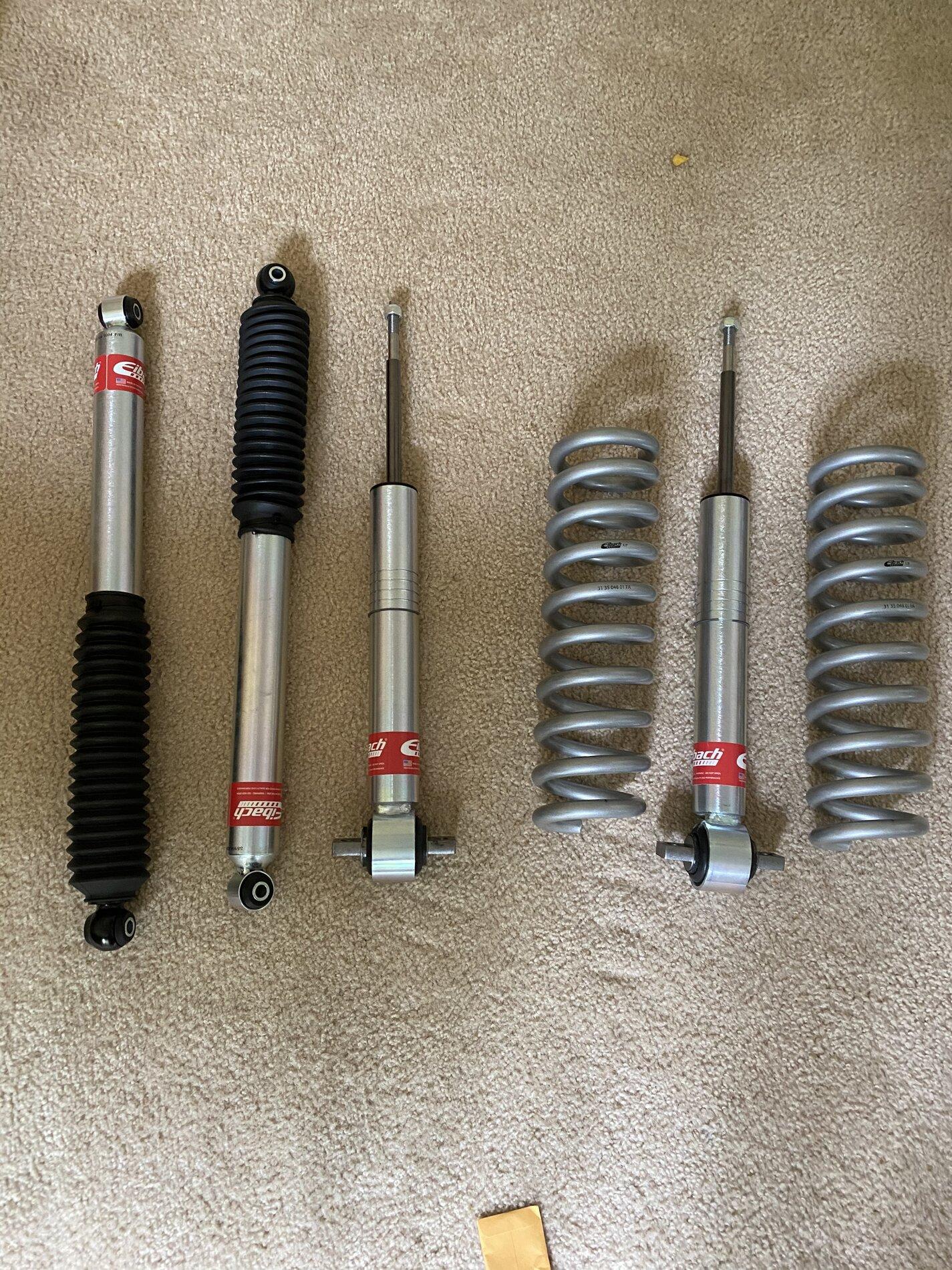

@njrucci
Can you post picture or measure the length difference between the eibach and the stock front shock length? If you dont have it installed yet. (Im talkin uninstalled, fully extended, bare shock length)
Thanks
