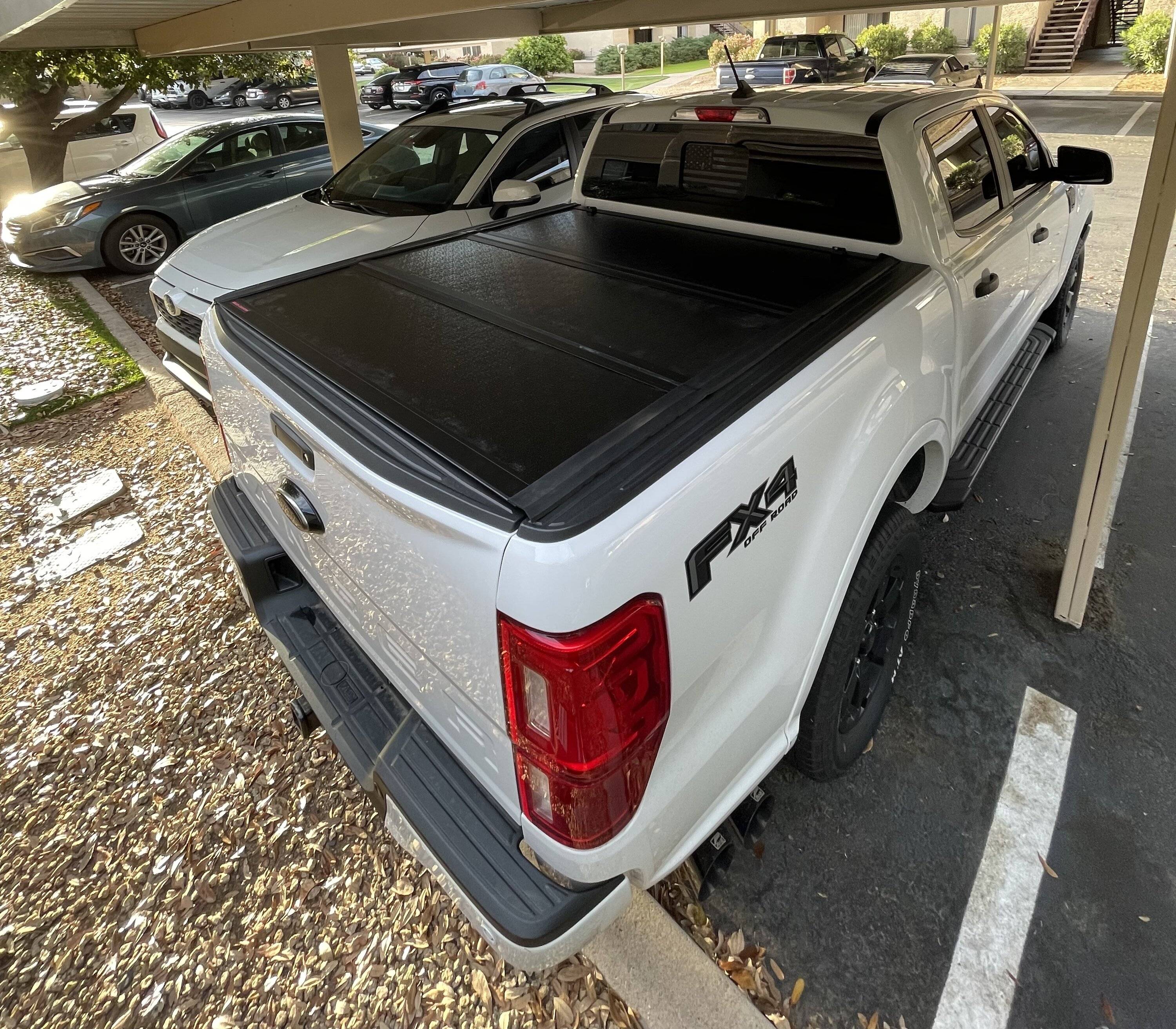

I have it on my truck and love it - easy to install and zero issues.

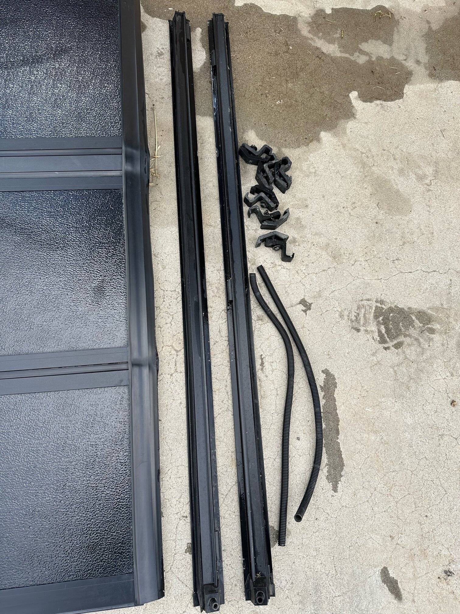

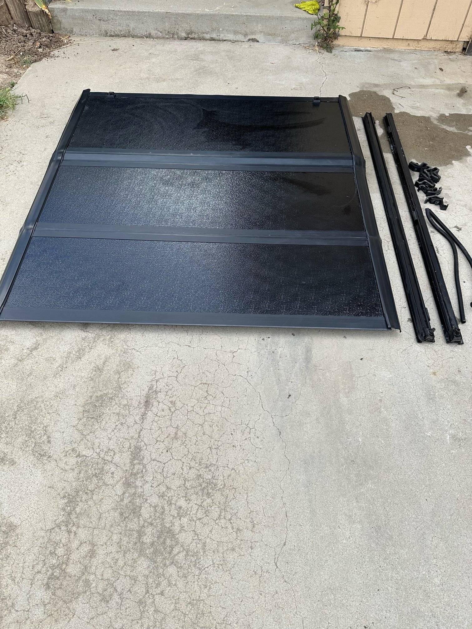

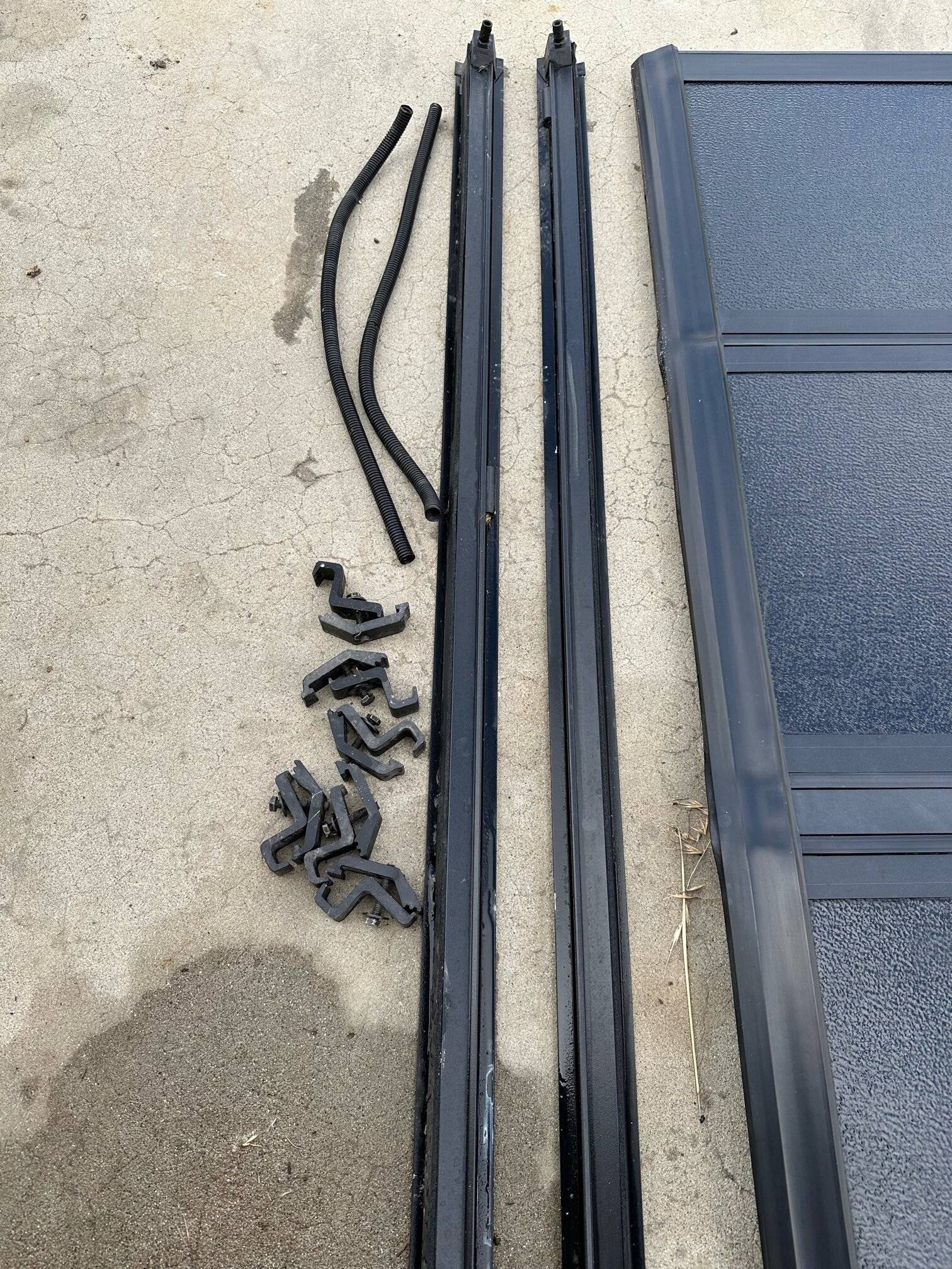

for sure thanks. if all goes well ill pick it up tomorrow and install next week. looks like everything is there, although there is usually some type of foam right? thanks again very much

$300?
Yep!!
It'll look great on your ride!

Yup - there should be a foam strip (you can likely buy from a hardware store) to fill a gap between the bed cover and bed. The instructions call this the "Bulk Head Seal".

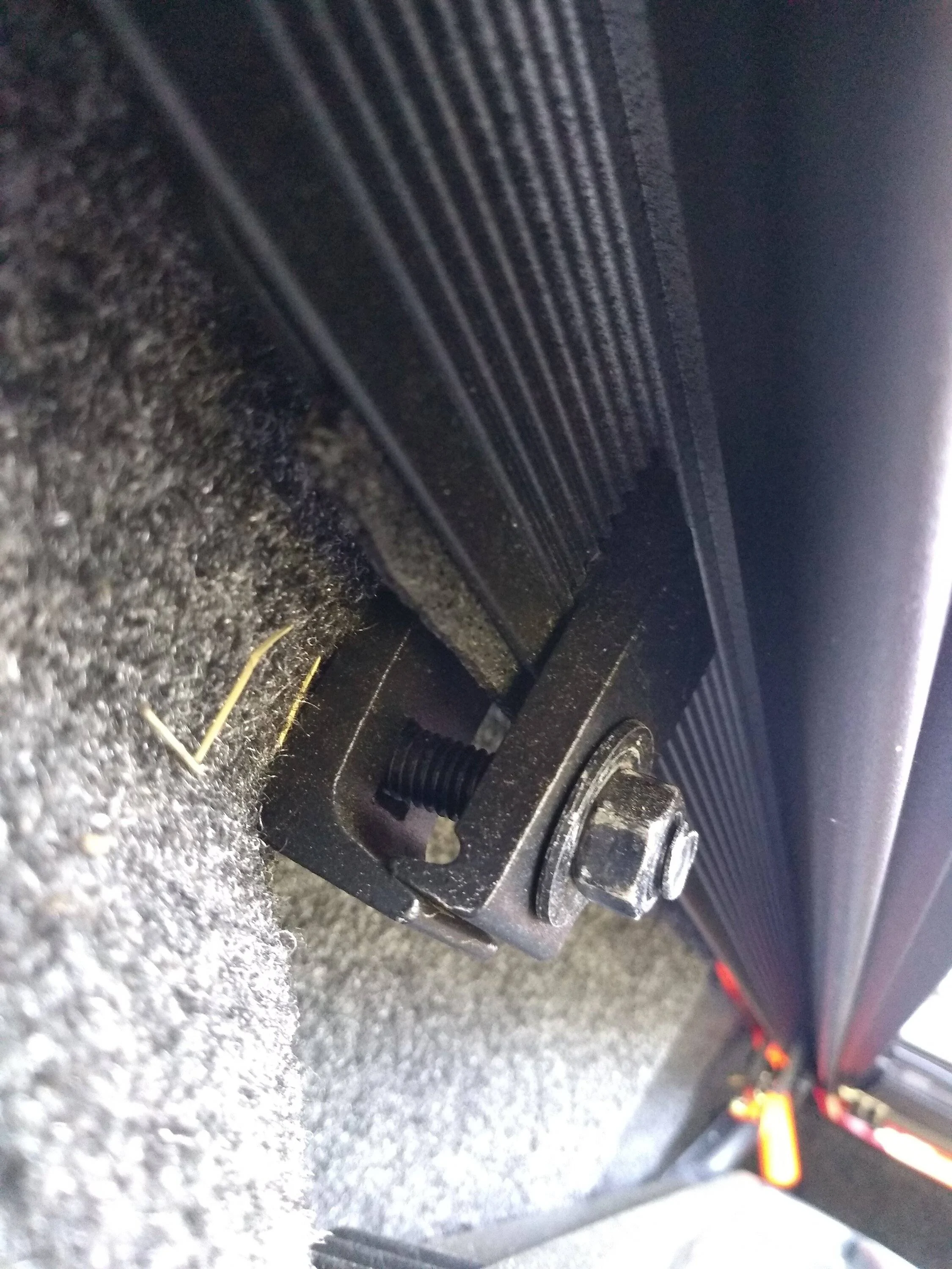

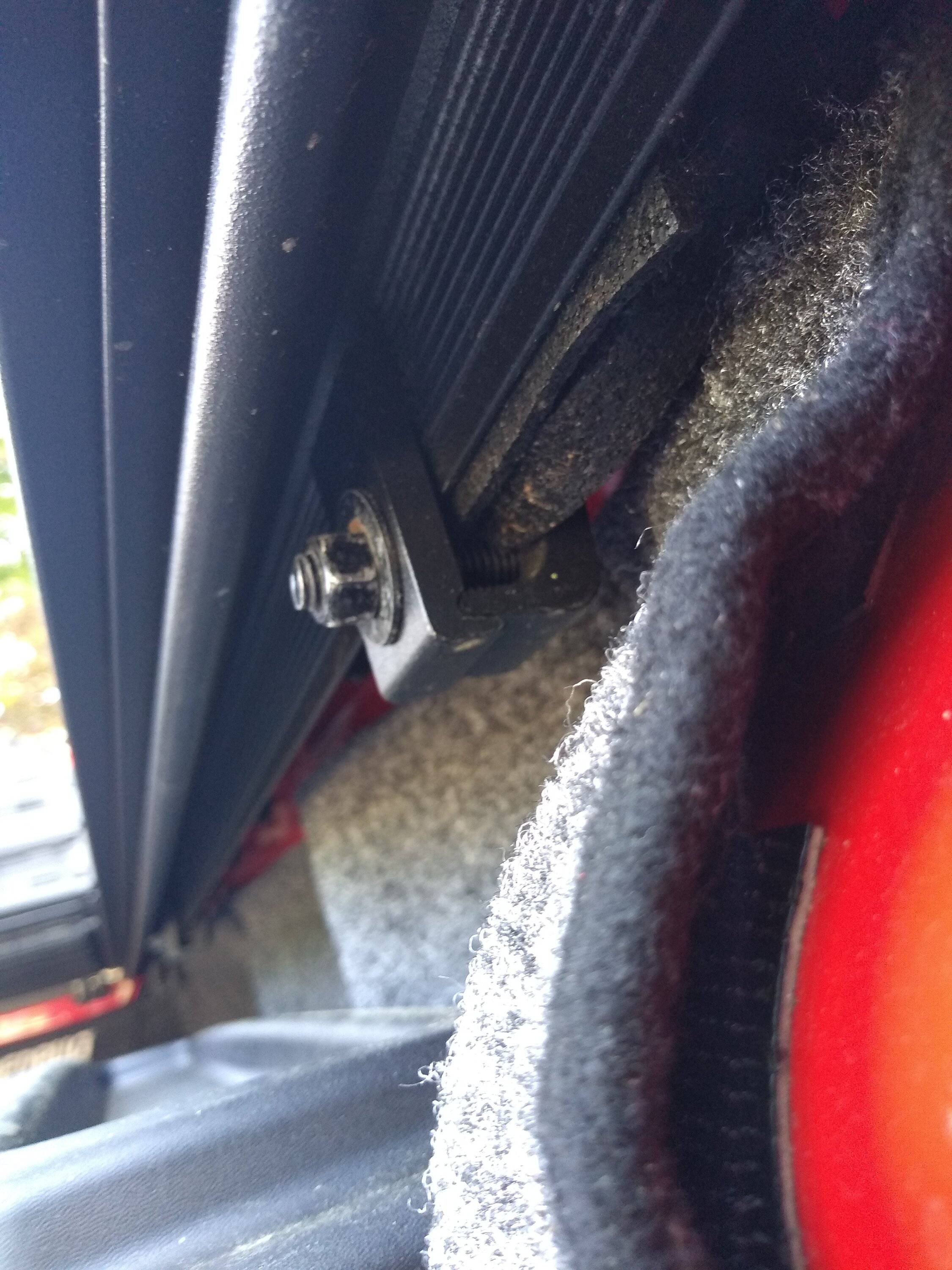

It's a really nice cover.
When you go to install, my only advice (worth about 2 Canadian cents or 1 US cent) is to go out there with plenty of time and patience.
I thought I could install mine in 20 minutes and got aggravated when I couldn't.
LOL, karma then had me reinstall it for a total of three installs (I had to replace a bad one).
What took me forever was shimming. =(
There seems to be a varying amount of space (gap) between the plastic reail cover and the metal under it.
I had to be patient with cutting and fitting the shim material that comes with your tonneau cover.
My shim material was a cork-looking rubber with one sticky side. I had to layer these shims in a couple of places to get my tonneau rails nice and level. When there isn't enough shim, the clamp will pull the side tonneau rail down and angle it toward the bed. Then the tonneau cover won't sit flush.
It isn't hard, but my impatience and expectation of a rapid install was my downfall.
LOL, by the third fitting, I had a handle of how to do it! =D
