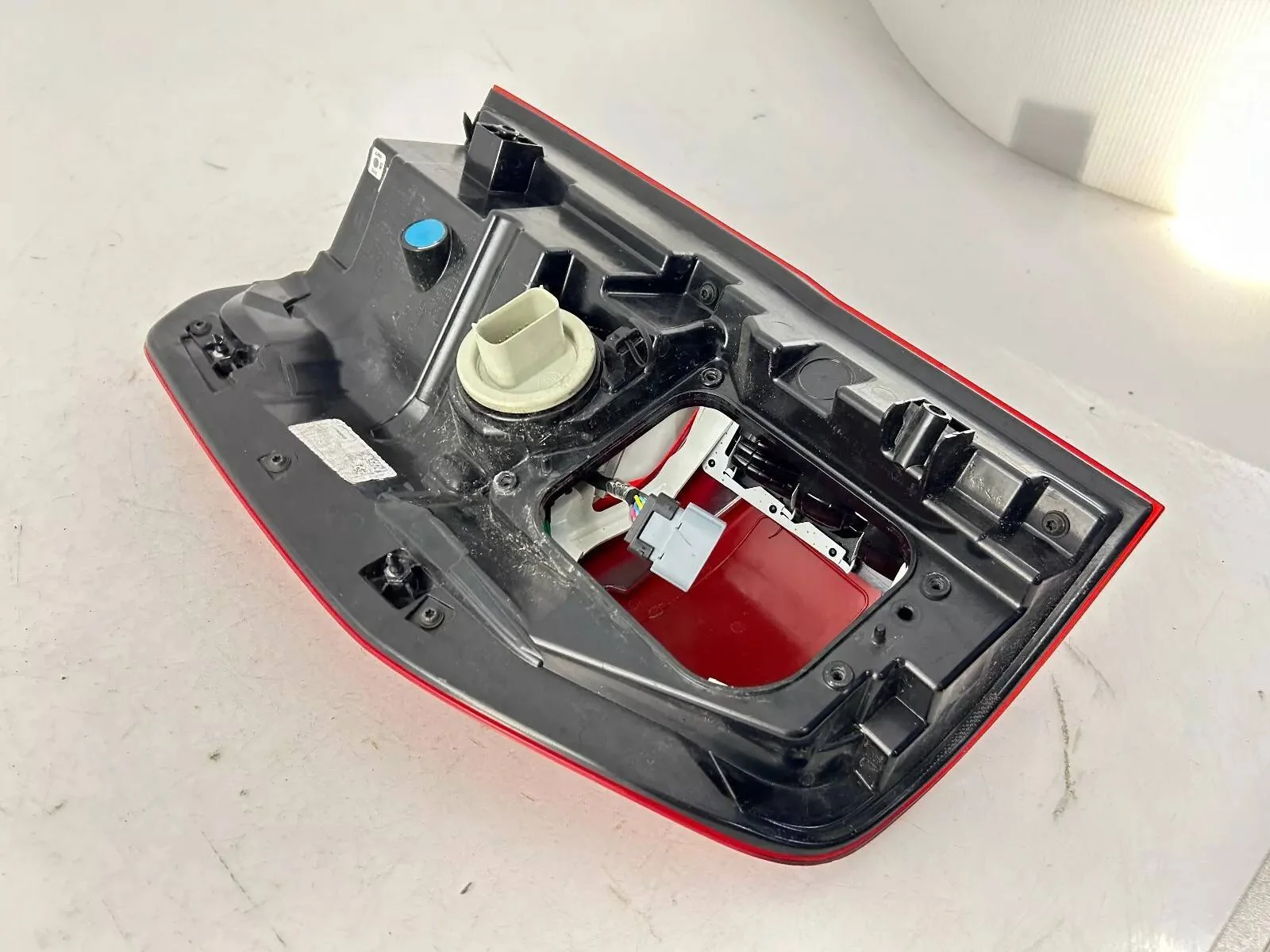

The module that mounts (in the open hole) is the BLIS module (SODR) Side Obstacle Detection (Right)
Both sides are the same part number (BUT) are programmed side specific So if you replace use Forscan and get the As-Built data off the old module then install the new module and load the As-Built data onto the new module (matching) the off module.
