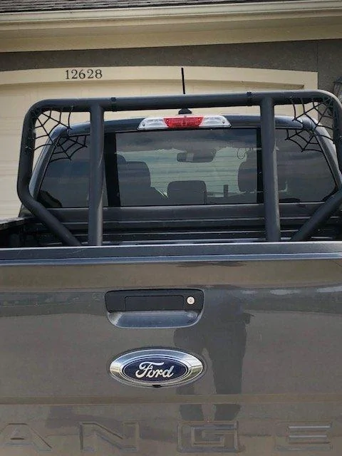

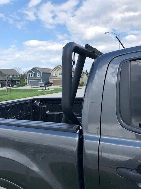

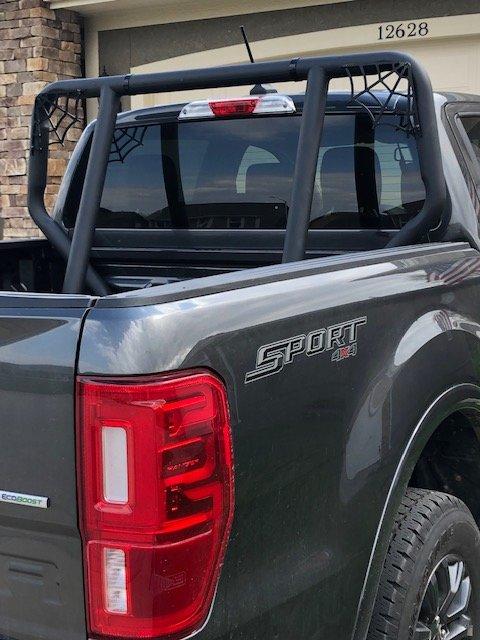

Here's my roll bar - not exactly what you're looking for but just to give you some ideas

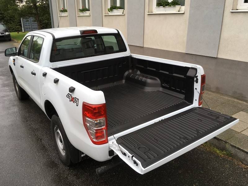

What made me abort having the Wildtrak sports bar installed was a combination of cost and the autobody crew telling me they didn't feel confident in taking the job on. Their estimate was approx $2000 Canadian. I did go to two other autobody shops in my town, one gave me a similar estimate and the other wasn't even going to go near such a project.
From what they could discern from a visual inspection and comparing a photo the international Ford Ranger's bed (attached photo), the Wildtrak sports bar appears to be a simple drop-in and bolt-on, however their bed rails are different in design. We removed a bed rail cap from my Ranger and discovered it wasn't just different but the area was convex.
We then thought about shaving down the Wildtrak sports bar's rails as they were also convex but the problem was the part would not sit level with the truck's roof, it would sit higher whether or not we removed the bed rail caps. Cutting portions of the bed rails seemed like the best option, but again the cost and lack of confidence the work crew expressed made me swallow my pride and opt out. Plus there was no guarantee it was going to still fit, and it is a $51,000 truck I bought after all.
Importing a Wildtrak sports bar to Canada only cost me $600 so it wasn't a total loss, just unfortunate the part couldn't fit, was really looking forward to it.
