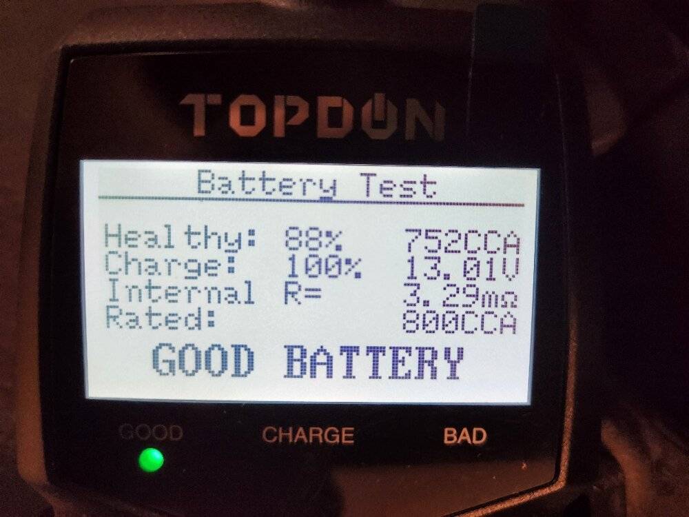

Might be able to extend the battery life with a charger and desulfator. Mine (2019) is pretty healthy by doing that. I use the Noco 5 Genius.
