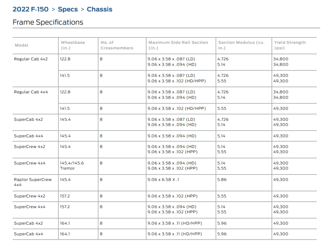

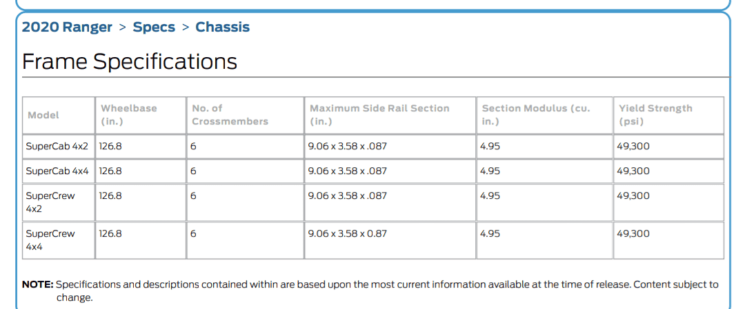

After spending a week in a Tacoma rental and looking under a friend's Colorado, I'm amazed at how much beefier the Ranger frame rails seem. Visually, the Ranger frame looks much heavier than any other midsize I've crawled under.
Did some digging and, interestingly, looks like the largest section of the Ranger frame rail shares identical dimensions to the F150 "light duty" frame.
For those unaware, the F150 is built on 3 frames, depending on wheelbase, GVWR, and payload package. The outside dimensions are the same between all 3. The difference is in the gauge of steel used. Also, interesting to note that the F150 light duty frame uses a lower quality steel (lower yield strength) than the 2 heavier frames.
Not sure if this has been discussed before here, but I'm very impressed with the spec of the 5g Ranger frame. Note that it is not the same gauge as the current gen F150 light duty frame, but made of the higher strength steel for the 2 heavier duty frames.
Ranger 5G frame specs:
Current gen F150 frame specs (2021+):
Just found this interesting and didn't see any other threads discussing this, so thought I'd share.

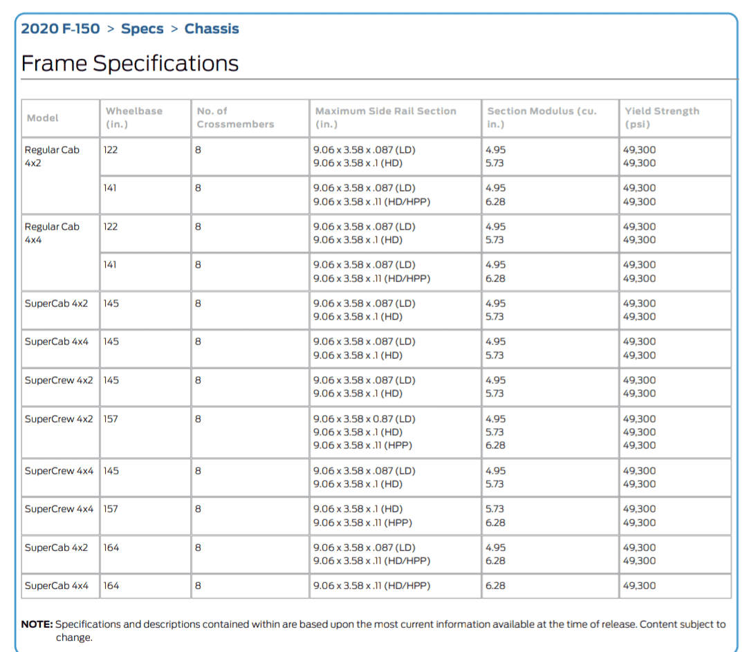

After a bit more digging, it seems the Ranger frame is identical to the previous gen F150 (2015-2020) "light duty" frame.
It seems the last gen F150 had a slightly more robust frame, across all three variants. Not a fan of the lower quality steel / lesser gauge used on the 2021+ models.
Regardless, it would seem a 2019/2020 F150 with the LD frame shares the same frame rails as all 5G Rangers. Ultimately, I think the frame is the most robust you'll find in a midsize truck.
It will be interesting to see what the 6G frame specs are...I fear we will see a similar trend to the F150. Lower yield strength, perhaps?

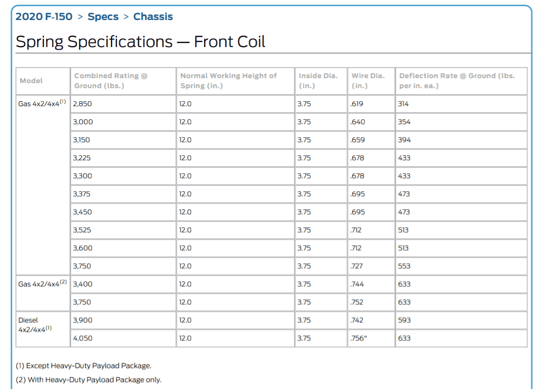

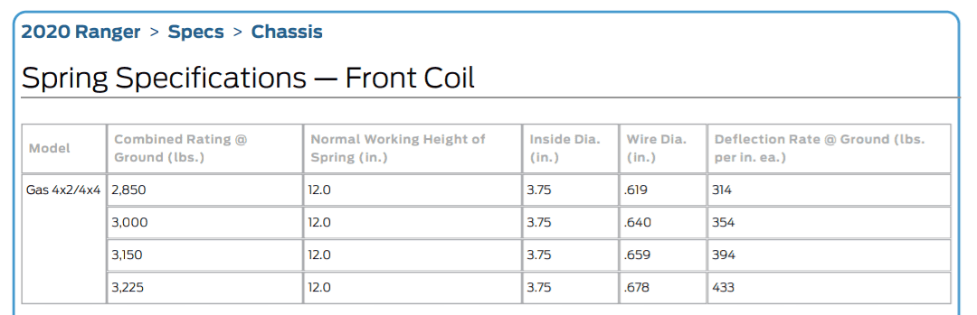

The more I compare F150 / Ranger specs, the more I'm convinced the "modifications for the North American market" consisted of using existing F150 parts and making them work for a smaller platform. This is certainly not a bad thing, and makes financial sense as well.
The 5G Ranger comes with 4 different front springs...note that these are identical to the 4 lightest F150 parts. Pretty interesting...
Weight rating, working height, inside diameter, wire diameter, and deflection rate are all the same.
Now, I wish they'd offer a heavy duty payload package on the Ranger...but I'm sure Ford would much rather sell you an F150.
