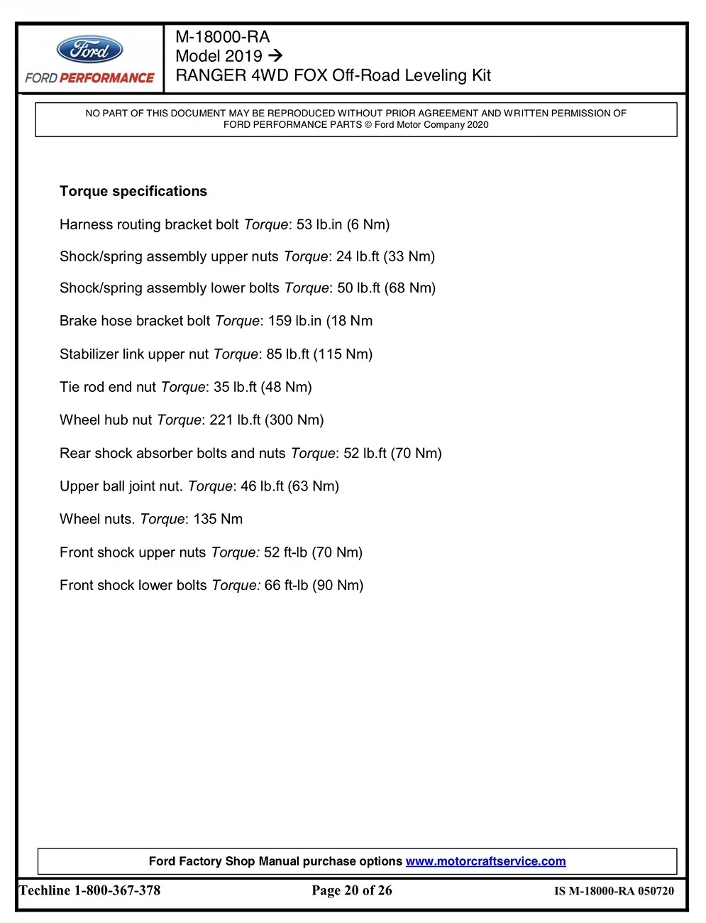

No clue as to what any of these #'s really mean but it now is straight and centered ! Now , the guy called me halfway through and asked if I want the truck level or do I want the struts adjusted exactly the same because I can't have both , now this is an OCD nitemare for me to have unequal threads but more of one to have that much lean, so I went with level (looks like maybe 1 1/2 difference in threads from one side to the other) he said he test drove and then tweaked it once more.

Thought i would show the difference that it takes to actually LEVEL a Ranger from side to side, which it now is ... I had a little lean before that bothered me but after the front coils , it was VERY noticeable, maybe an 1" or more ! Front end guy said he checked everything for binding or out of square and I was good 👍... he also made a good point on the "lean" the Ranger and the others that have it, roads are crowned and higher in the middle (drivers side) for water runoff, so a 1/2 lean on your driveway may be level on the roadway... idk but my OCD is happy now ...
