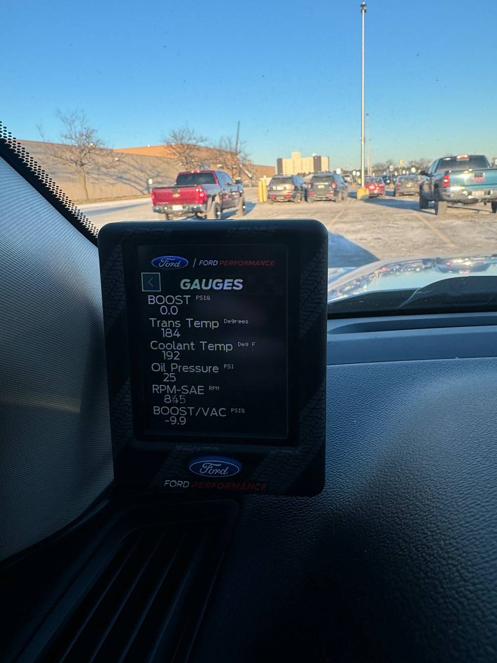

So, just got to work and I looked for it in the parking lot. Are you talking boost/vac? Mines showing -10 at idle. I didn’t search long cause I ran out of time but I didn’t find a vac figure to display by itself.
Yeah i just use the Boost/Vac instead of the straight boost one.
