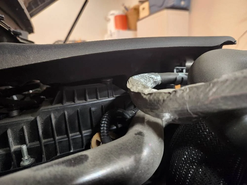

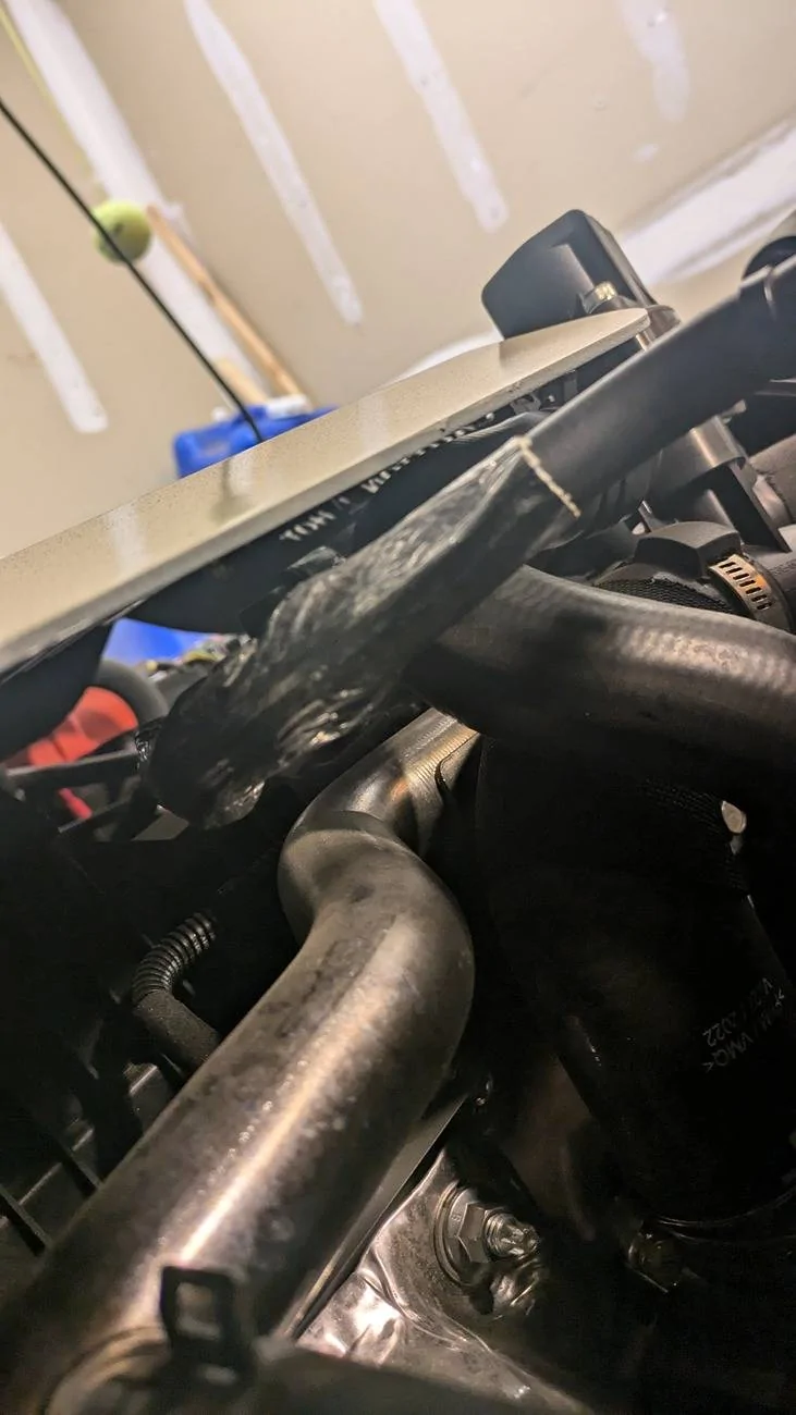

Dang-it had to go look. Can fit a finger between the two spaces.
IdahoRanger Well-Known Member First Name Steve Joined Sep 26, 2019 Threads 12 Messages 4,329 Reaction score 21,512 Location Idaho Vehicle(s) 2019 Lariat SuperCrew FX4 Occupation RETIRED Nov 6, 2024 #16 Dang-it had to go look. Can fit a finger between the two spaces. Sponsored

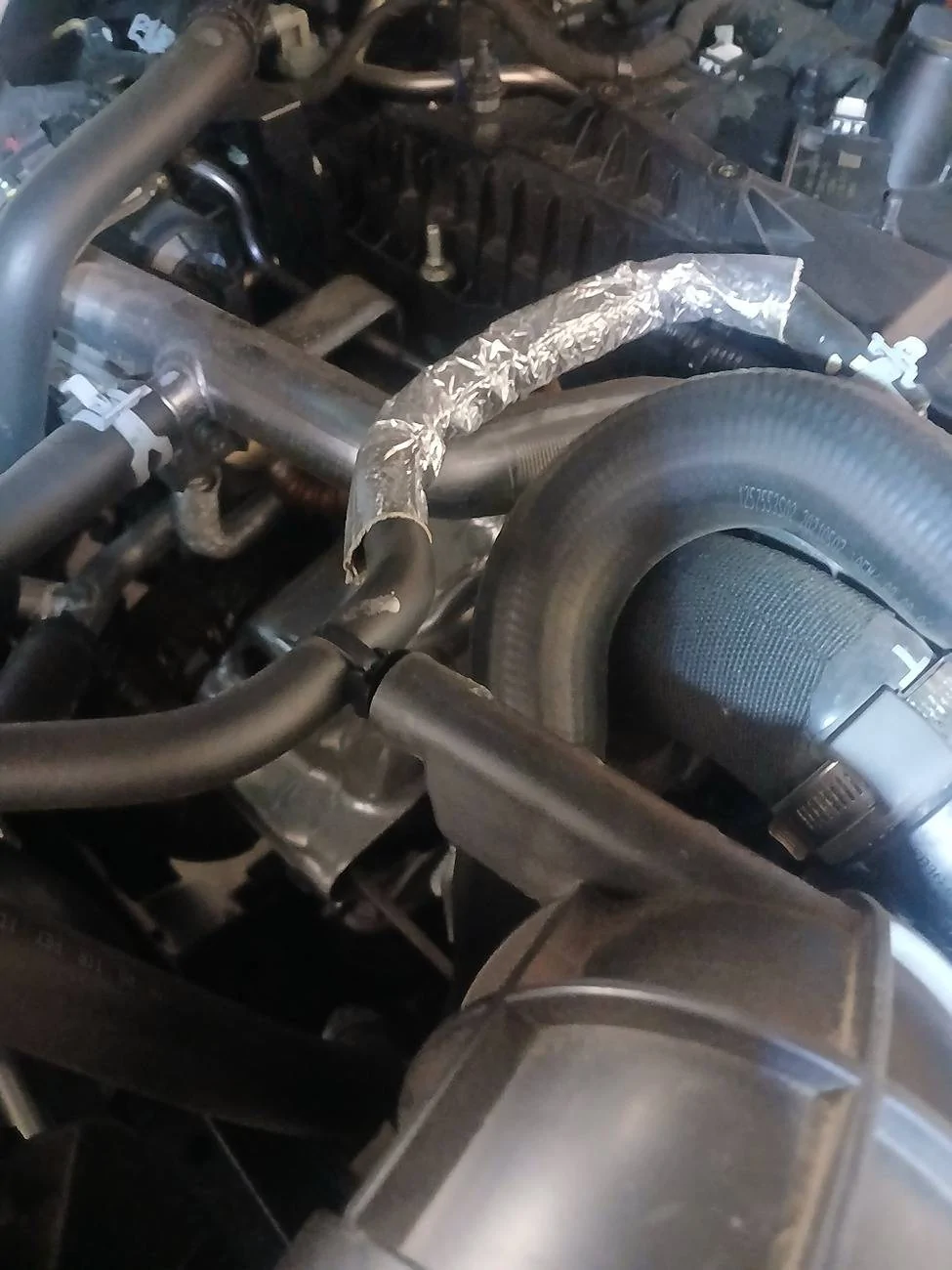

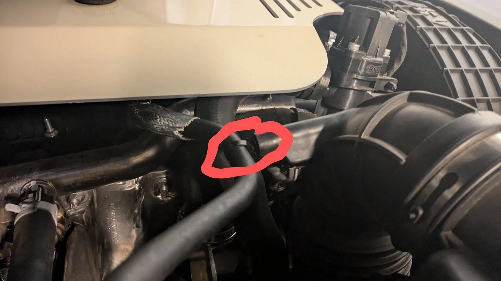

OP OP LawnMM Well-Known Member First Name Rich Joined Oct 9, 2023 Threads 9 Messages 945 Reaction score 3,031 Location Colorado Vehicle(s) '23 Ranger Tremor Nov 8, 2024 Thread starter #17 airline tech said: Snip about 1 inch off the Réservoir side of the hose to shorten it. This will pull the hose up off the chafe point. (Just DO NOT cut it too short) Click to expand... I like this idea

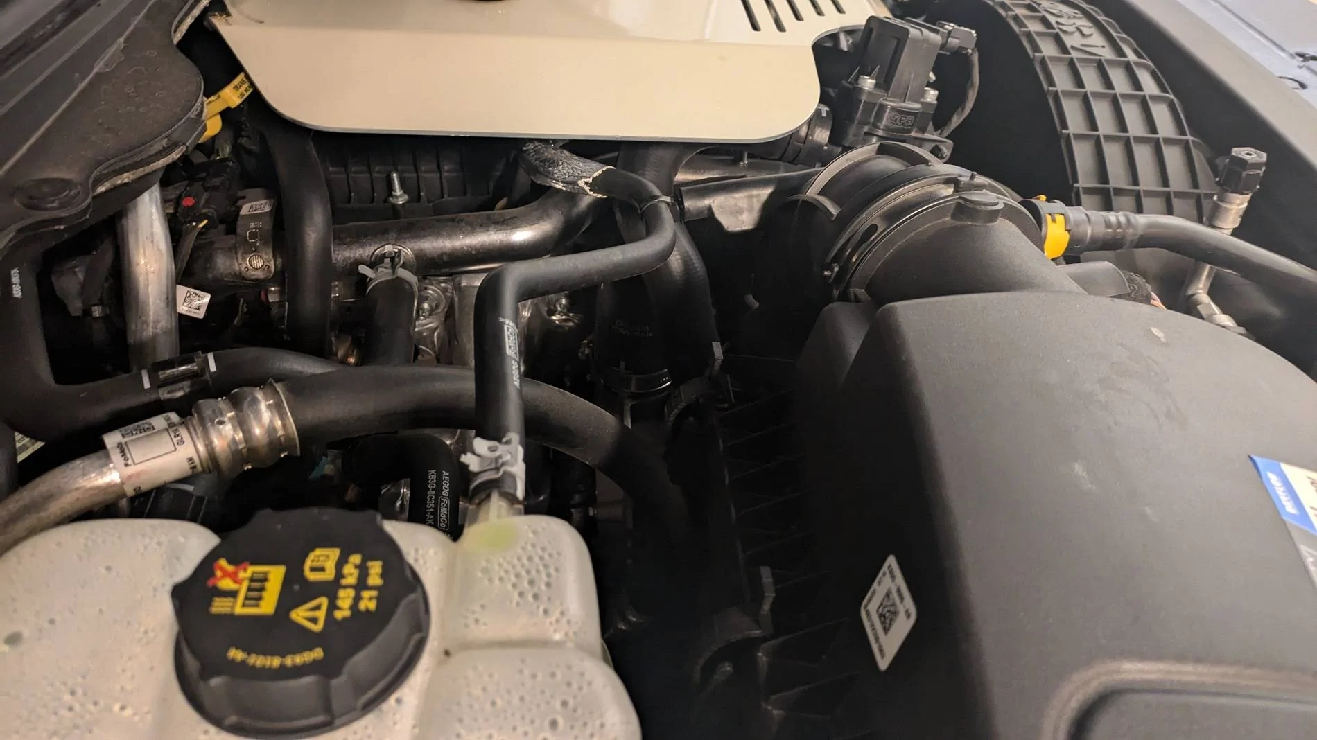

JaysOnTheEDGE Well-Known Member First Name Jay Joined Oct 17, 2019 Threads 13 Messages 804 Reaction score 1,489 Location North Carolina Vehicle(s) 2019 Ranger XLT Sport 4x4, 2021 Escape SEL AWD Occupation Office Equipment Technician Nov 11, 2024 #18 The Roush airbox top does not have a provision for this hose to clamp too, when i e-mailed them and brought it to their attention the response was they would include a long zip tie so you can tie it to the intake tube Sponsored
