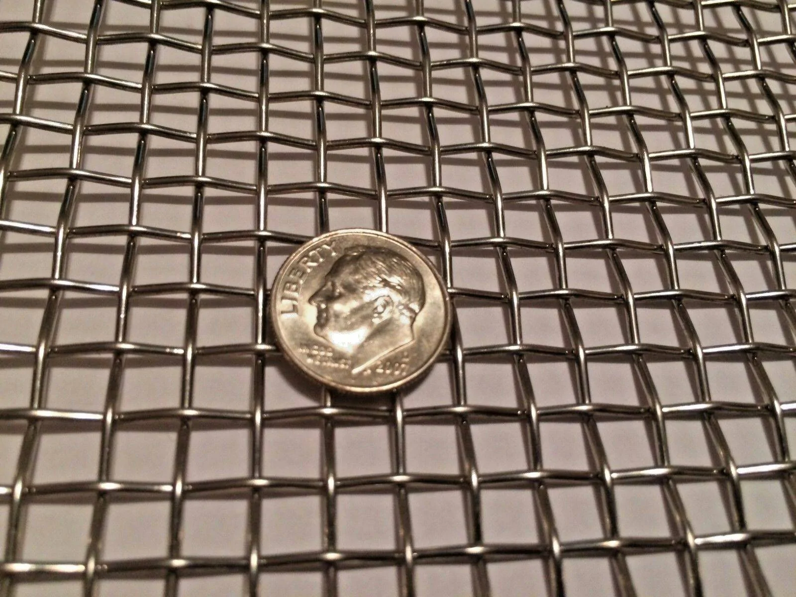

I bought some stainless steel woven mesh from eBay and put it behind my lower valance hexagonal grille. It won't stop sand and the such, but will stop the larger rocks and debris. If you can find a large enough piece, cut it to fit (I used diagonal cutters), you could fasten it to the back side of the grille. The 12x12 pc of 304, #4 mesh with .047 wire was about $20 shipped. so it would be a fairly inexpensive fix/mod.
This is what I used--
Here is a 12x48" pc-- https://www.ebay.com/itm/2925940403...U5v9AYOLng%3D%3D|clp:2334524|tkp:BFBMnKKBnsBf
