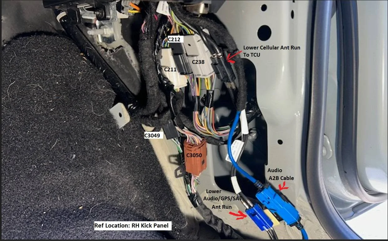

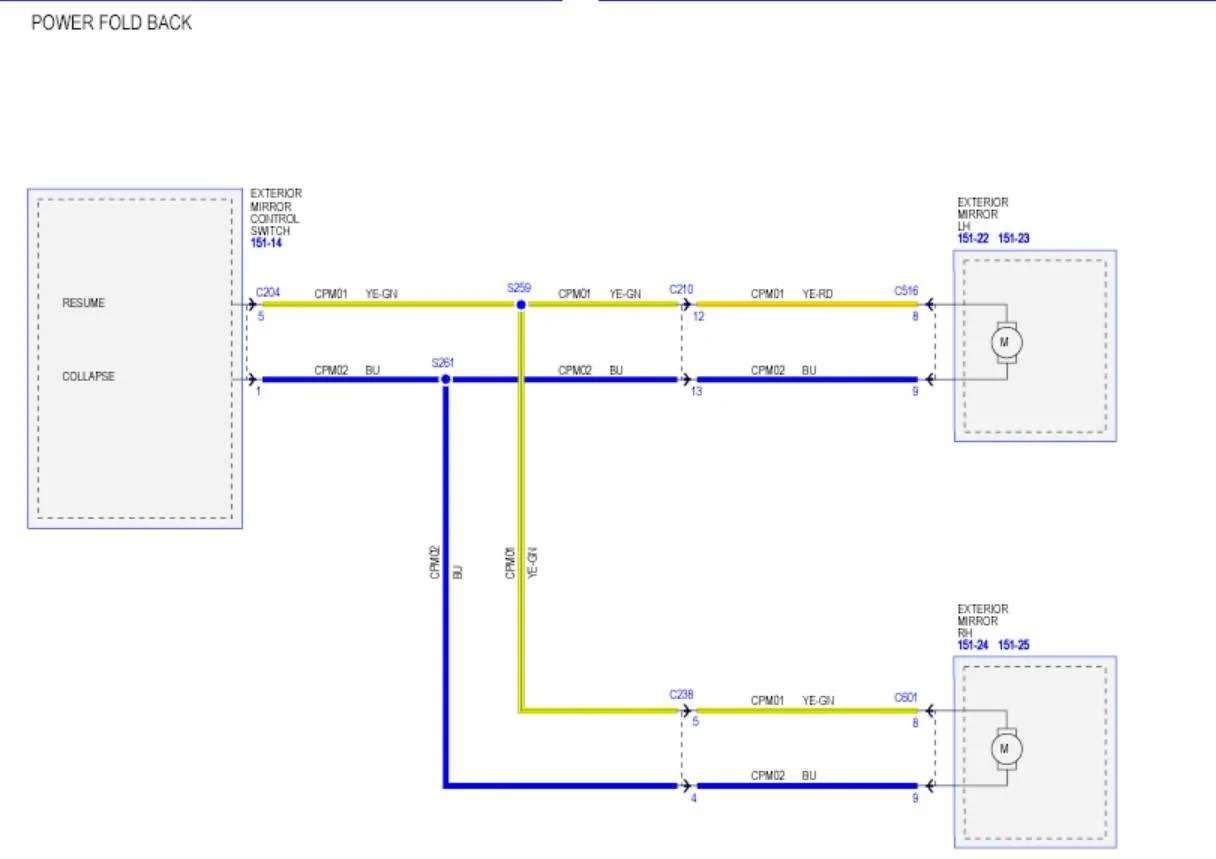

I would try - suggested above - manually move it and then hit the switch, if no help check for voltage at the mirror connector (While pressing the switch) normally press and release
Pins 8 & 9 are the power and ground - polarity reverses (Normal & Stow)
So Pin 8 is power and Pin 9 is ground - then when you hit the switch again
Pin 9 becomes power and Pin 8 becomes ground.
Pin #8 = Resume (Normal) - Positive
Pin #9 = Collapse (Stow / Folded) - Positive
Polarity Reverses (Pin to Pin) depending on direction the motor is moving
If you have power and ground - its the mirror motor, if not a deeper dive into the wiring to find the bad connection for those pins
For Ref: C212 and C238 feeds the Folding Mirror (Power & Ground)
C212 feeds pin 8 and C238 feeds pin 9 on the C601 mirror connector
So you could try reseating these as well
Its not the switch but there is a splice between the switch and those 2 connectors C212 & C238
I have a hunch manually moving the mirror may bring it back in sync with the switch, somebody walked by the truck in a parking lot and bumped the mirror (most likely)

Here is the electrical diagram for the folding mirror motors.
