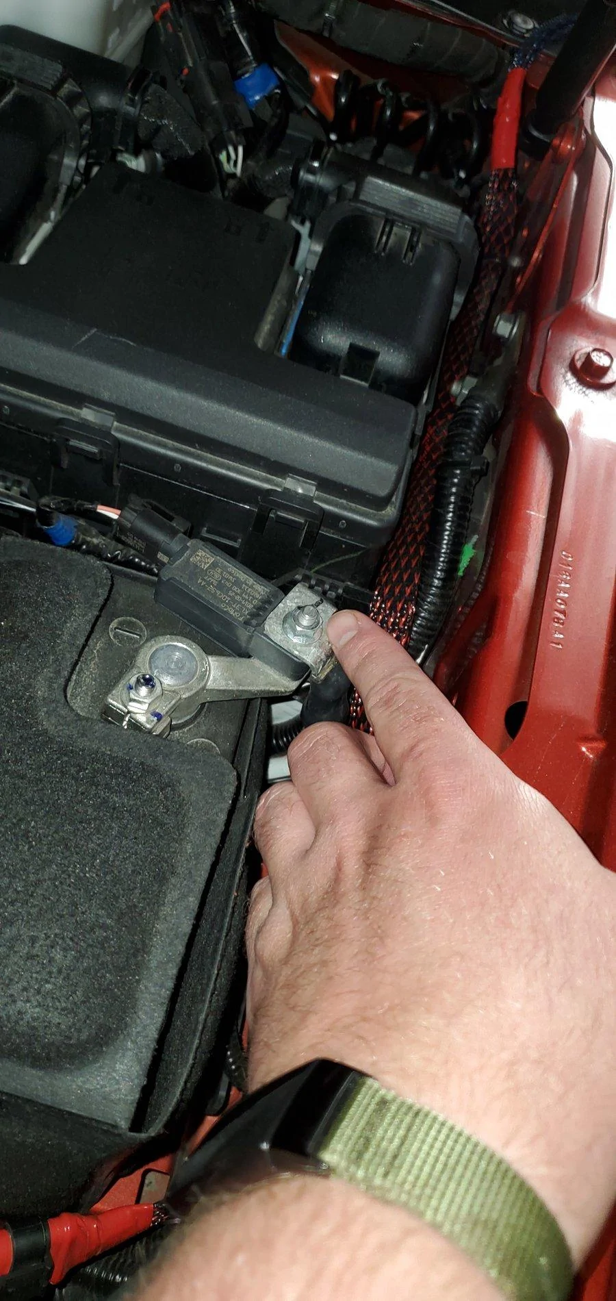

So firstly, when you're trickle chargine these new(er) Ford vehicles with a BMS system (little black thing on the negative terminal), make sure the ground is on the chassis side of the terminal (where my finger is) or even on a separate chassis ground. Don't put the negative directly on the battery. This will allow the BMS and the vehicle charging system to learn the vehicle state-of-charge, and allow it to charge and maintain the battery properly. The system needs about 8 hours to relearn...
As for the battery not staying charged, likely a few things. You might have excess drain somewhere, but hard to pin-point, and doesn't sound like any of the things you installed would do it, but who really knows.
It could also just be a bad battery. The AGM batteries in these can be pretty temperamental, so that might be part of the issue. The battery could be bad from a drain and not being charged/maintained by the charging system, or could be just a bad battery period ?‍♂
I'd recommend taking it to the dealer and having them check the battery and/or replace it (under warranty) and see if it maintains charge, or if it drains too. Then from there, start to try to pinpoint things that might be pulling power.

Bennett, I was hoping someone might comment on my choice of the negative connection. Much appreciated!

Would you connect the permanent trickle charge connector negative side to where Bennet is pointing to in his picture, or another spot that connects to the truck body or frame?
I am still going to move forward with getting it setup to be able to trickle charge it without opening the hood.
I would hook it up like Bennet has pointed out, and set it up with out opening the hood as well. I placed my order in last night for the charger.
