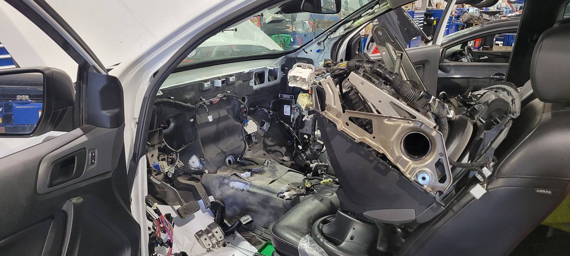

Now to confirm drip location, he points out (access) if you can call it that
But one should be able to borescope and or use a mirror this location to confirm

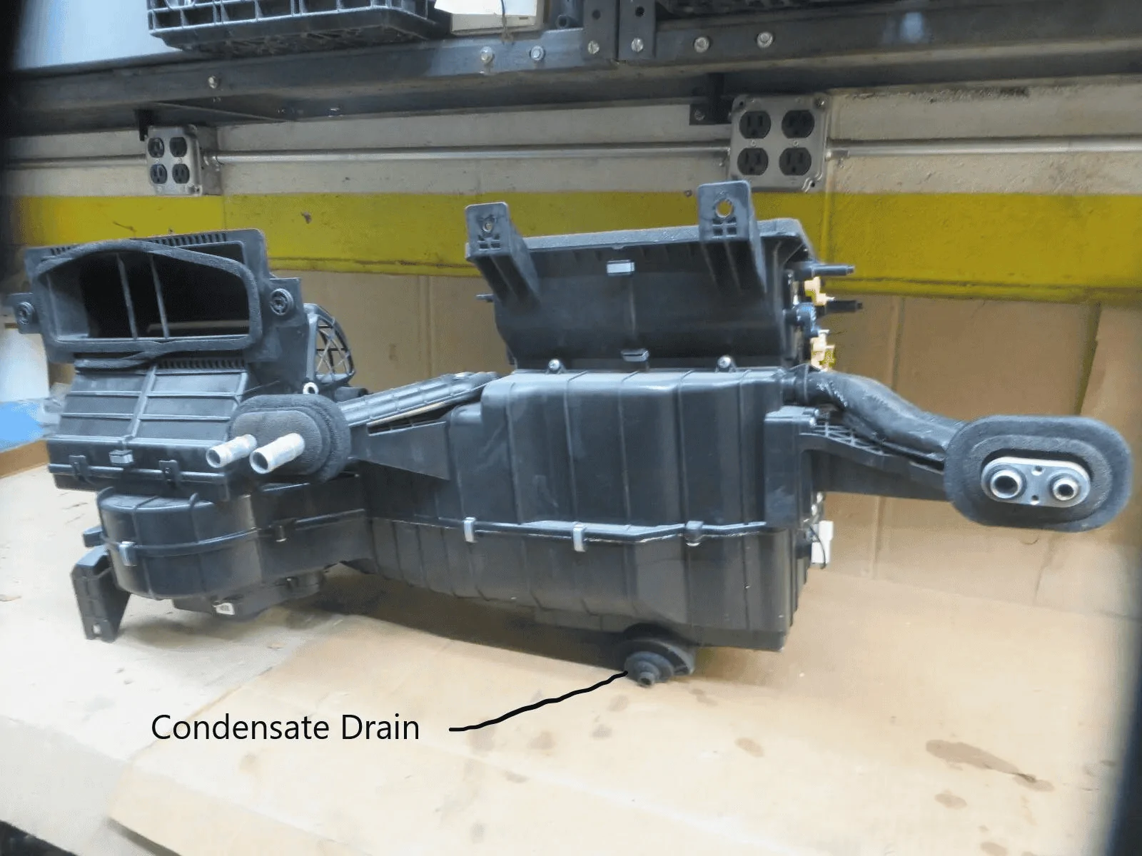

This is where he is referencing in the video, the drain hole in the center (hump)
Lines or Drain
Where he talks about adding a tube/ elbow to the end of the exit drain (The pic) I posted above is what he is talking about.
My thought is that if the drain itself is partially clogged, this will slow the drain down just enough for this to happen.
Now an extension is a great idea but does not address the root cause, but it may at the least prevent most of the condensate from flowing back into the cab, however if clogged enough you will still have the condensate (overflowing pan) issue in turns - dumping onto the floorboards.
Another thought is to add some sealant around the grommet to help seal the tube from backflowing. The issue here is access
